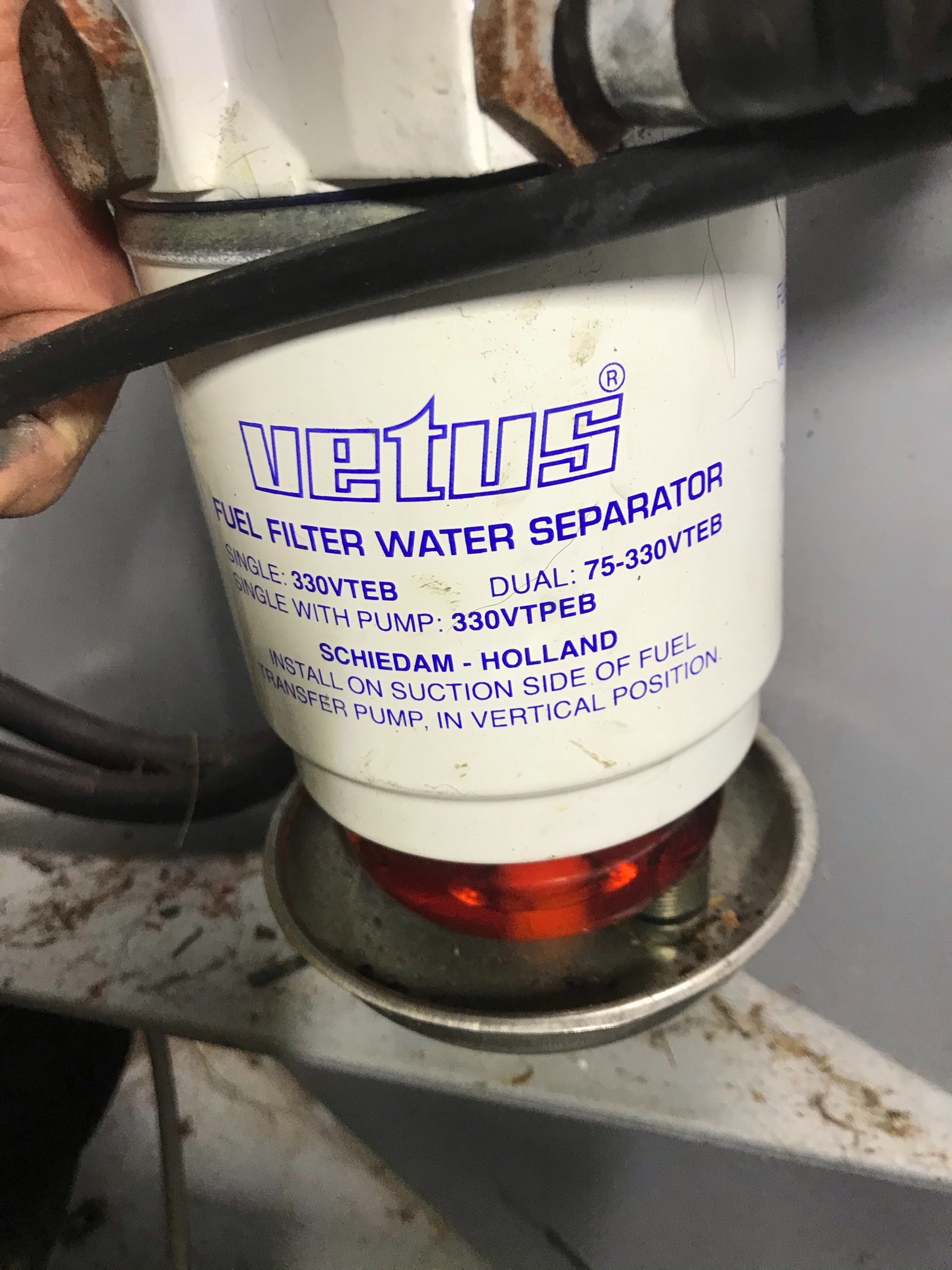

Have you tried looking at inline filters website?  They have a very good equivalents finder.
If it is not there as an equivalent, measure the main dimensions including the thread size/pitch and you can look up an equivalent that way.
You could also try online filters. They have a rep for being helpful.
Vetus are rather good at buying bespoke auxiliary items, and charging the earth for them though.  If you cannot find an equivalent it might be cheaper to swap your filter unit out with a Delphi 296 agglomeration filter.  Loads on line- just ensure you get one with a metal bowl and drain plug to keep BSS happy.

I too would swap out the filter for a new agglomeration filter assembly rather than be ransomed for ever by Vetus.

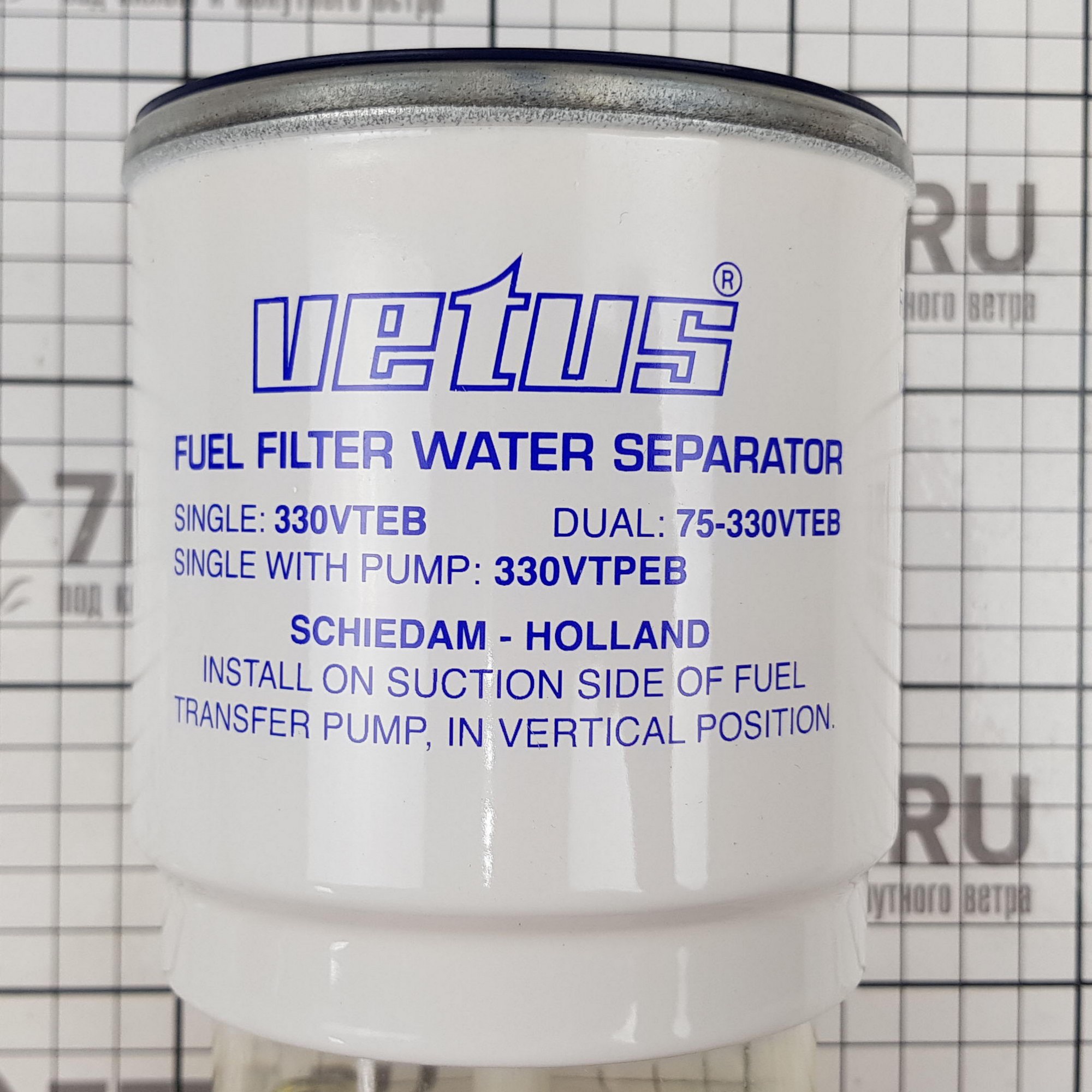

It looks to be a custom filter, never seen one like it before.
That looks like a Racor filter. Very good filters. Try ASAP supplies as they sell a lot of Racor elements. They may be able to match it up for you.

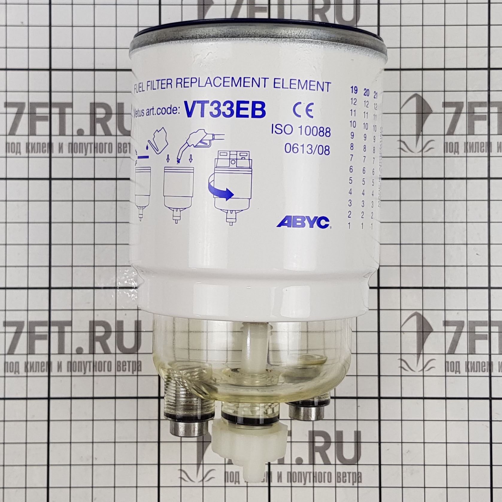

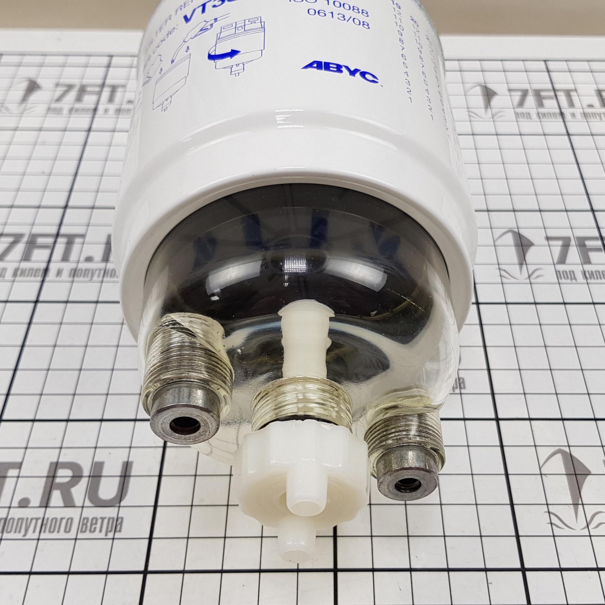

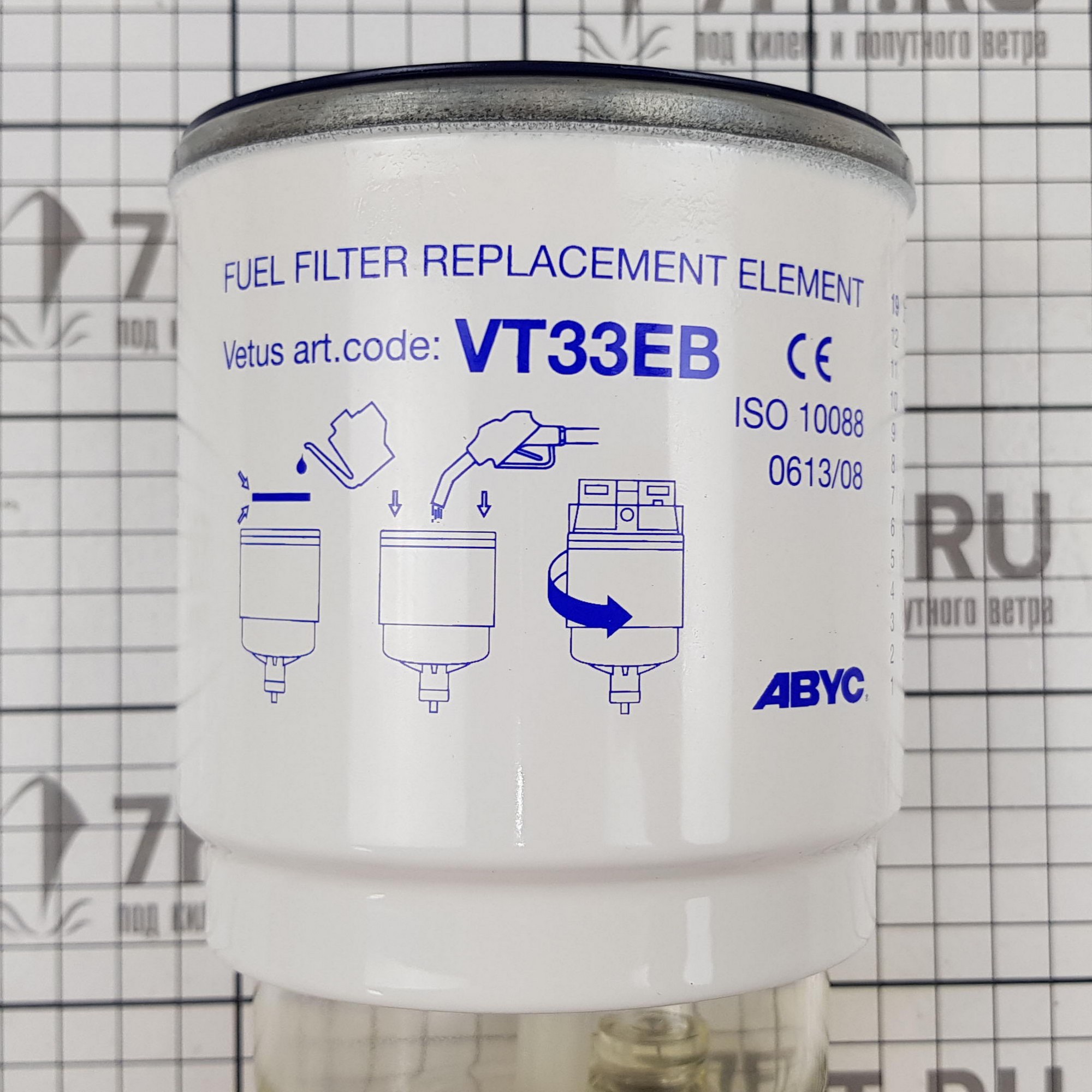

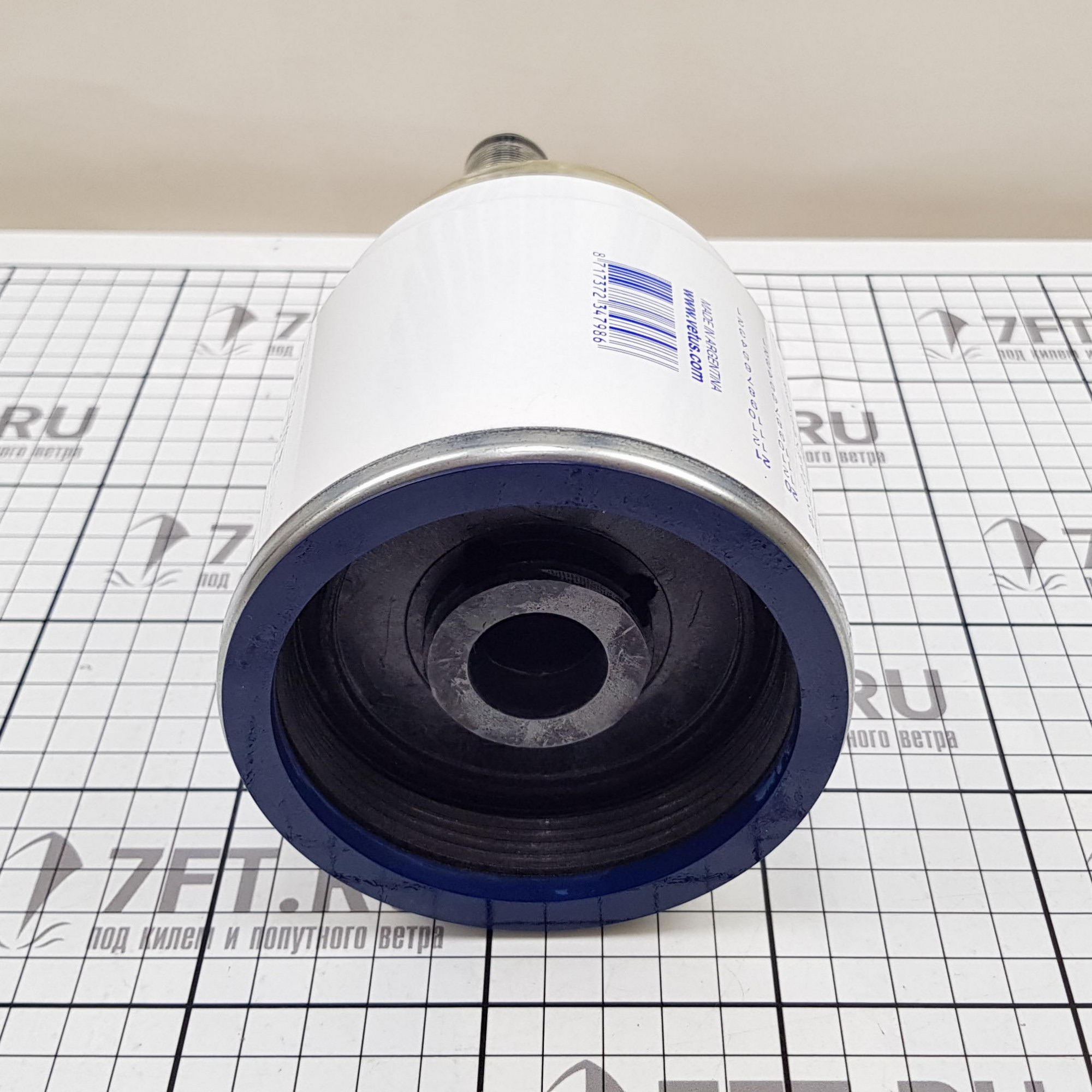

Best pictures I could find online, that's a very large diameter thread. Looks like the bowl is integral to the filter.

Looking at that now with a few more photos I will withdraw what I said earlier. I dont think it is a Racor filter. Also the quality does not look that good. I think I would go along with previous posters and remove and fit something more suitable with readily available parts. Call me cynical but Vetus do seem to sell various things that you cant cross reference, just to remove as much money as possible from the customer.
Unfortunately that's a different filter. I think that is the one fitted to the Mitsubishi range.

Note that the manual shows the connection ports as M16x1.5 thread, whilst the specification on the web page shows some variants as M14x1.5. Not easy to tell which it is from the OPs original photo.

You could use the CAV head as already suggested which is a filter and water trap. Or you could speak to Beta and buy one of there Wasp filters which has a course washable gauze filter and is also a water trap.
