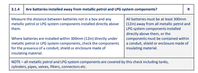

I sit corrected, the fixed high level ventilation is acceptable in accommodation. I also came on this image.png.6347b54233a964d7c29f92d08b09036c.png
And that is for LPG COMPONENTS, I'd still suggest that an open flame LPG APPLIANCE in the same area as the batteries is unlikely to be acceptable, but we shall see what the BSS say If the OP asks them.
