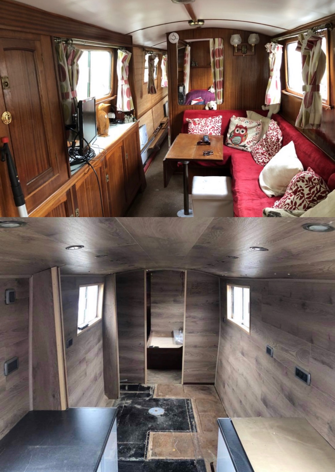

Currently going through a complete refit.
with regard to itchy fibreglass, we used
https://www.diy.com/departments/diall-insulation-roll-l-6m-w-0-37m-t-100mm/3663602481812_BQ.prd
more expensive but no itch!
we have also gone for a baton / t&g approach, big learning curve, but the first room (which we have learnt and improved on for the next room) has lasted well.
here is a before and after photo, the whole thing is still work in progress.
Example of batoning the wall.
had to refit a lot of this, add more batons!
Edited by Nemysys
looking very swish :)
