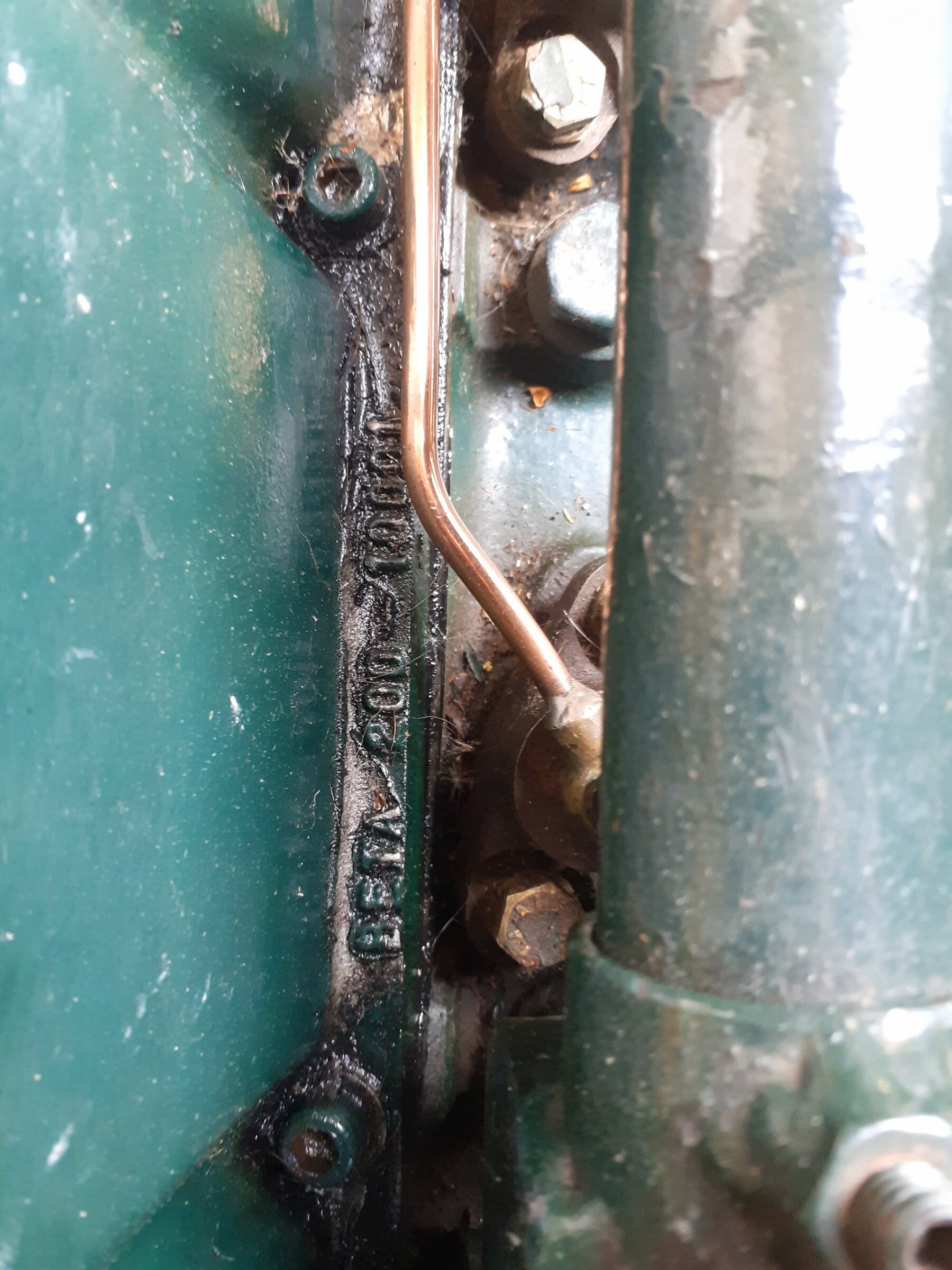

What picture would identify it ? It has a beta no on it Beta 20010001.that’s on the rocker cover .
That is the Rocker Cover number on my BD3.
Yes I know its dirty, currently on way to get the oil leak fixed.
Its not a JD3, so if its a biggish slow revving engine from Beta then it must be the BD3, and Ditchcrawler says it looks like his and he has a BD3.
There are lots of photos of the JD3 on the internet, and a few of the BD3.
People do get these engines confused sometimes, Beta stopped doing the BD3 years ago and replaced it with the JD3, and sold a lot more of the JD3 so a few people have not heard of the BD3 so just assume JD3.

Another number I have found on he block
HH2 OE29

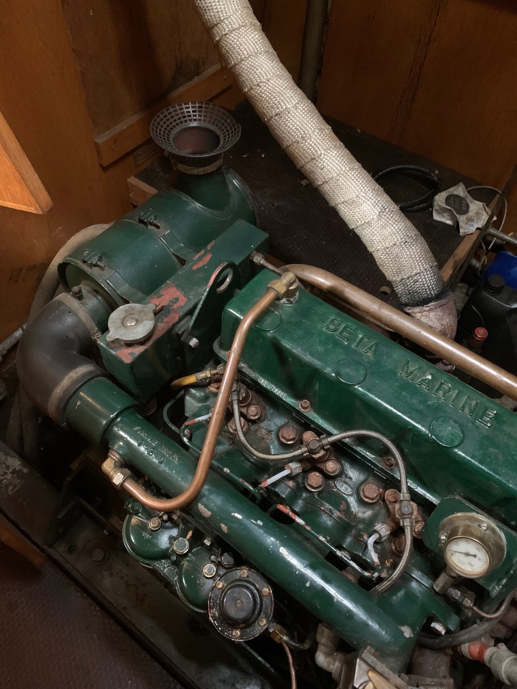

That is a BD3, strange top on your air cleaner. don't  buy an ait cleaner element from Beta, you will need a mortgage

27 minutes ago, 1stArthur said:
Another number on the block
HH2 OE29 .
That is definitely a BD3. Same as mine with slight differences. The air filter housing is different on mine with the air intake on the opposite end of the cannister. Your oil pressure gauge is mounted the opposite side of the bracket to mine. Mine has the hand start so has the Decompression lever. I can see the Ford mark in the oval on the casting in the same place as yours. Have you got a manual. I can send you a softcover of the Beta manual when I get home in a couple of weeks. Send me a pm to remind me
Thank you I don’t have a manual. What does BD stand for ?
I was thinking of when I get time to connect a small bar to the throttle and bring the control cable connection to the back of it so it’s easy to change a broken cable because I can’t see a way of getting at that it as it is .
Arthur.
I suspect BD is Beta Diesel??? and JD is John Deere.
I think Beta was founded by a bunch od ex Lister men and so this could be continuing the Lister tradition of two letters plus the cylinder count??? HA2 CS2 JP3 etc.

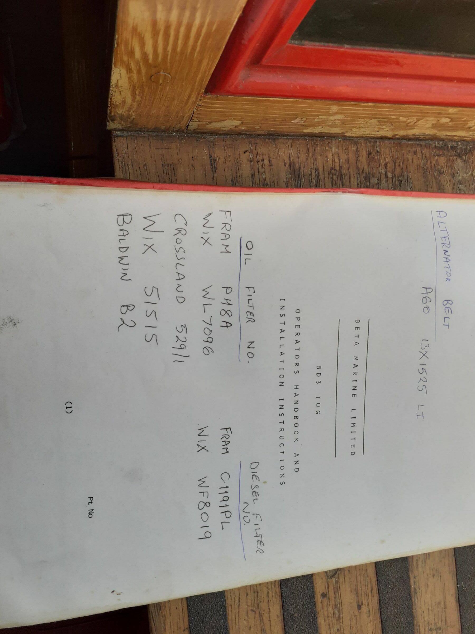

Could you please let me know part numbers for the oil and fuel filters and there is a water trap filter before the fuel filter. That would be very useful thank you .
There are not always definitive  part numbers for fiter elements, each manufacturer has their own number system. There should be a makers name and number on the existing elements. You can then use that to cross reference to other makes of filter if required.
Some filters are almost generic, lots of people make and refer to a "296 type filter" for example but still some makes do not include the 296 in thier number.
The first filter/water trap is likely mounted on the boat rather than engine so will be selected and fitted by the boat builder, it should have a number on iy, otherwise can you do a good photo?.
I use Delphi 296 as they are not pleated on the on engine filter. I use the same one on the agglomerator which is mounted on the swim of the boat before the fuel reaches the engine. I understand the other one on the engine only has a cone in it .

There is also a Baldwins number for the fuel filter. Will dig it out. Does yours have the 5kva 240v alternator or not
Baldwins BF825 is a fuel filter what I use
