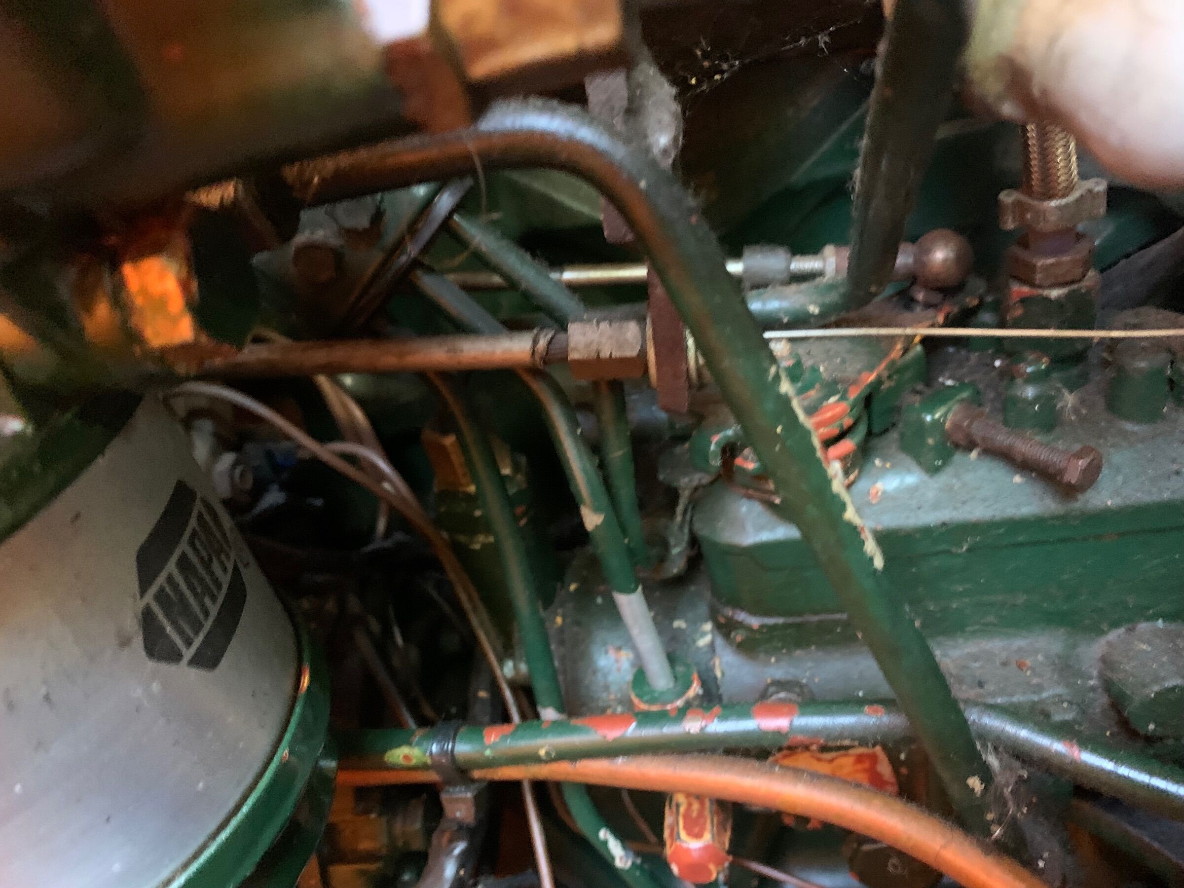

1stArthur Posted October 13, 2023 Report Posted October 13, 2023 On 25/02/2021 at 11:24, dmr said: Oooh I can feel a pedant moment coming on. Its the DF120 that Beta use, which in non emissions certified. For various reasons we actually have the 150 (emission certified) which has a slightly more complicated injection pump and different injectors. However because the JD3 runs slower than John Deere ever intended I doubt that the emission things do very much. It might run just a little nicer but its hard to tell. .................Dave Changing the subject slightly has anyone changed the throttle cable on a jd3 ? mice just bought a boat with a jd3 and the throttle connection looks well buried behind the top of the fuel pump. And tips on how to go about this would be appreciated. Thanks Arthur.
dmr Posted October 13, 2023 Report Posted October 13, 2023 Can you send a picture, it sounds like a non standard installation. The throttle cable end fixes to a lever on the injection pump and it should have good easy access, the outer fixes to a bracket that also hold the gearbox oil cooler, and again full and easy access. I think ours is one of the very first JD3's but I doubt if things have changed much (or maybe they have). 1

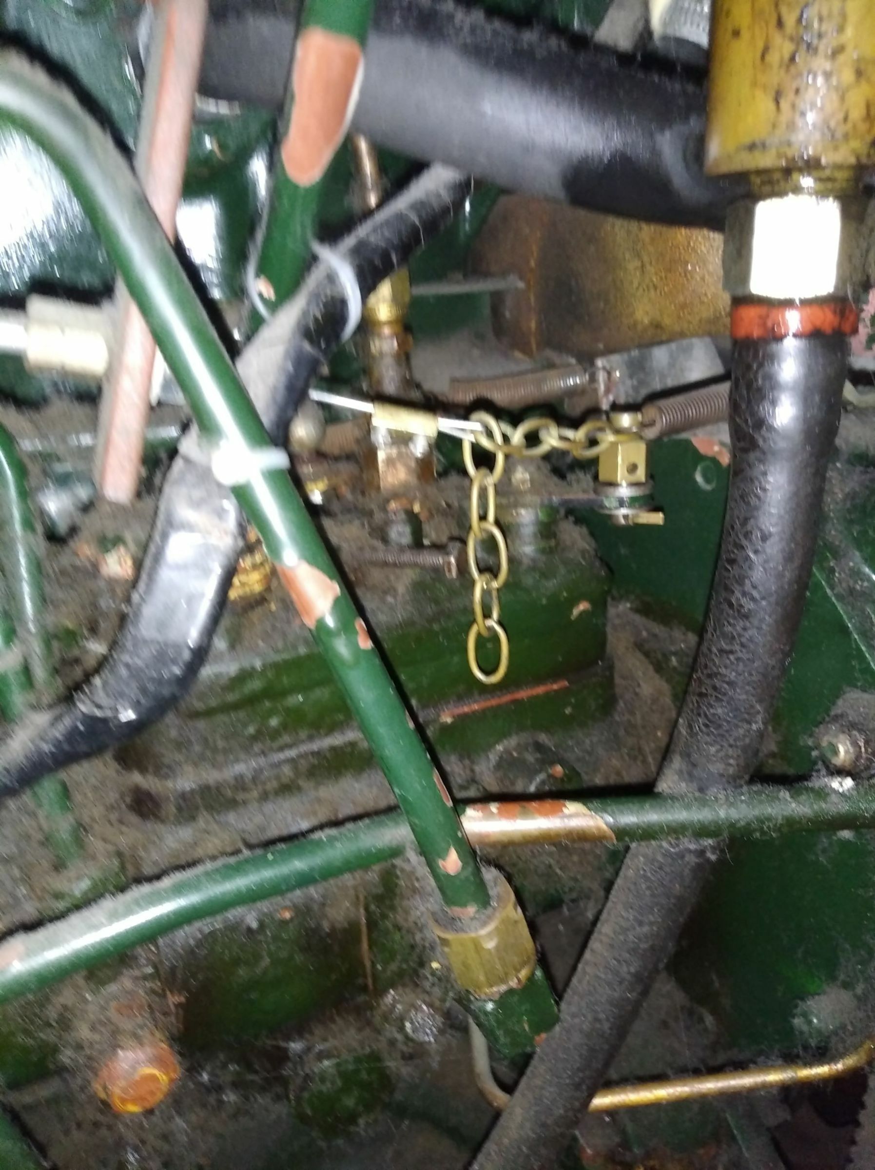

1stArthur Posted October 15, 2023 Report Posted October 15, 2023 On 13/10/2023 at 16:27, dmr said: Can you send a picture, it sounds like a non standard installation. The throttle cable end fixes to a lever on the injection pump and it should have good easy access, the outer fixes to a bracket that also hold the gearbox oil cooler, and again full and easy access. I think ours is one of the very first JD3's but I doubt if things have changed much (or maybe they have). The outside cable is the stop the throttle is in behind.
dmr Posted October 15, 2023 Report Posted October 15, 2023 This is not a JD3 ( Imight regret that statement 😀) Could it be a BD3???
1stArthur Posted October 15, 2023 Report Posted October 15, 2023 I’m not sure it’s a beta tug engine and as far as I know it’s a jd3 , I don’t know that info could be wrong but the throttle cable looks a right bbb to do . I don’t need the change it as of yet but I don’t fancy stripping part of the engine to get at it .
1stArthur Posted October 15, 2023 Report Posted October 15, 2023 What picture would identify it ? It has a beta no on it Beta 20010001.that’s on the rocker cover .
Tonka Posted October 15, 2023 Report Posted October 15, 2023 Find the full engine number. If it has Crk3 in the number then it is a BD3. Or can you see any Ford symbols on the castings. Mine has and its a Bd3. What age is it ? I have Beta manuals for the BD3 and parts manual for Crk3 ( the lister version) of the Ford engine
1stArthur Posted October 15, 2023 Report Posted October 15, 2023 Thank you I will have a look for that .
ditchcrawler Posted October 15, 2023 Report Posted October 15, 2023 5 hours ago, dmr said: This is not a JD3 ( Imight regret that statement 😀) Could it be a BD3??? That looks very much like mine 4 hours ago, 1stArthur said: I’m not sure it’s a beta tug engine and as far as I know it’s a jd3 , I don’t know that info could be wrong but the throttle cable looks a right bbb to do . I don’t need the change it as of yet but I don’t fancy stripping part of the engine to get at it . Mine is fiddely, behind the fuel filter and sedimentor 28 minutes ago, ditchcrawler said: That looks very much like mine Mine is fiddely, behind the fuel filter and sedimentor
