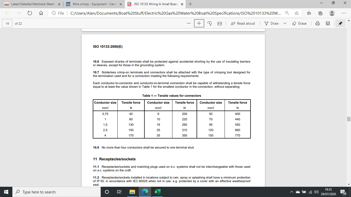

TheBiscuits Posted July 29, 2020 Report Posted July 29, 2020 24 minutes ago, jacko264 said: Can I ask why this type of connectors are not allowed we are talking about 12v wires graham Apologies Graham, I misunderstood your typo "crisp and shrink" to be referring to the solder and heat shrink ones mentioned a few posts before yours. Yes, crimp and heat shrink are good to use. I'm pretty sure ISO 10133:2012 frowns on soldered connections - that you weren't talking about! - but don't have a copy to hand. @Alan de Enfield might have it though.
Alan de Enfield Posted July 29, 2020 Report Posted July 29, 2020 6 minutes ago, TheBiscuits said: Apologies Graham, I misunderstood your typo "crisp and shrink" to be referring to the solder and heat shrink ones mentioned a few posts before yours. Yes, crimp and heat shrink are good to use. I'm pretty sure ISO 10133:2012 frowns on soldered connections - that you weren't talking about! - but don't have a copy to hand. @Alan de Enfield might have it though. Yes, 'solderless' and must be tested to specified 'pull-off ' figures Extract (10.7) 1
TheBiscuits Posted July 29, 2020 Report Posted July 29, 2020 5 minutes ago, Alan de Enfield said: Extract (10.7) Thanks Alan.
