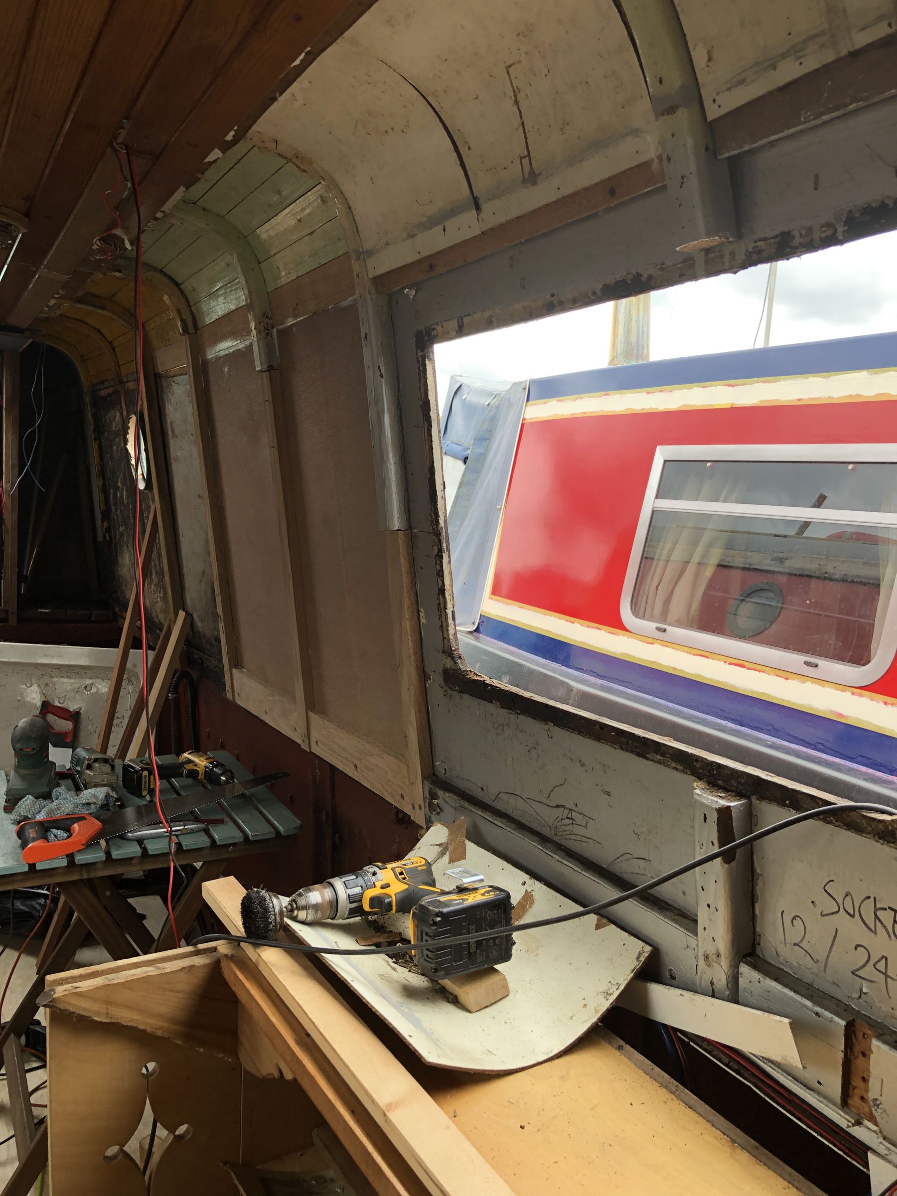

I have spoken before about the Star Class Woolwich Working boats of the 1930s, and how they were cut down to become BW cruisers in the 1960s. We are lucky enough to have become the custodians of one of these named Antony Water Lilac. We have embarked on restoration work and have discovered she needs quite a lot of rebuilding. Some of her frame work needs replacing, possibly a new roof. And we are using new marine ply for the sides of the cabin. It seems she has had some leaks through her gunnels for quite a while. But nothing that can’t be remedied. Her roof has had a belt and braces job of Layers of vinyl flooring which looks very bad. We are going to strip off the old covering and replace with stretched painted canvas?? Does anyone know what the roof covering would have been originally? Any ideas or advice would be great.

We have bought BS 1088 marine ply from a builders merchants. The first lot was slightly darker than the second lot don’t know why but it’s still stamped 1088. When we dismantled the old boards it was marine ply under a thin sort of hardboard similar to what you get on the back of wardrobes, this was glued with a bitumen/tar. Which has been a nightmare to remove and it heats up in the hot weather and runs. We have positioned the ply and was told by someone on the marina to use two pac epoxy glue. This would be to stick a thinner ply on top as a top skin/ finish. It will be painted a colour not left as wood, so should we use the epoxy underneath the primer and top coat paint?
The hardboard you mention may well be Masonite, an oil impregnated material used long ago in building wooden cabins. I endorse the suggestion of sealing the cabin top ply with resin.
That sounds right, we had the same Masonite board in vintage caravan ceilings. We are going to stick a thinner ply on top of the thicker marine ply. This will hide any screws etc...I was told yesterday to think of it as just adding another ply layer to the multi layered marine ply underneath. With the two pac adhesive, is this the same as the West System. And is resin a different application. We have also been told about the Silver paint that soaks into the wood to waterproof it on the inside of the marine ply. Apparently this stuff is hard to get these days as it has chemicals in it? But the inside of the old ply and the boats main frame work has been painted with it.
I wouldn't bother trying to find the old stuff, it won't be as good as a decent epoxy treatment. West system is a coating rather than an adhesive and i would coat inside, edges and the external surface. A thin layer of ply on top is unnecessary and may make future maintenance difficult, a decent faring type filler will hide screws and joins and is designed to fuse with an epoxy coating.
I would consider covering your roof in EPDM rubber membrane, I have used it on a few wooden cabins, it can be ordered in any size so the whole roof is covered in one piece, it's flexible and tough.
Painted canvas could easily be applied over the top of this layer and you wouldn't have to worry about water ingress through cracks in the paint.
The only problem with EPDM membranes is that if they get punctured it is almost impossible to find the hole. There are other single ply roofing membranes such as Sarna.
