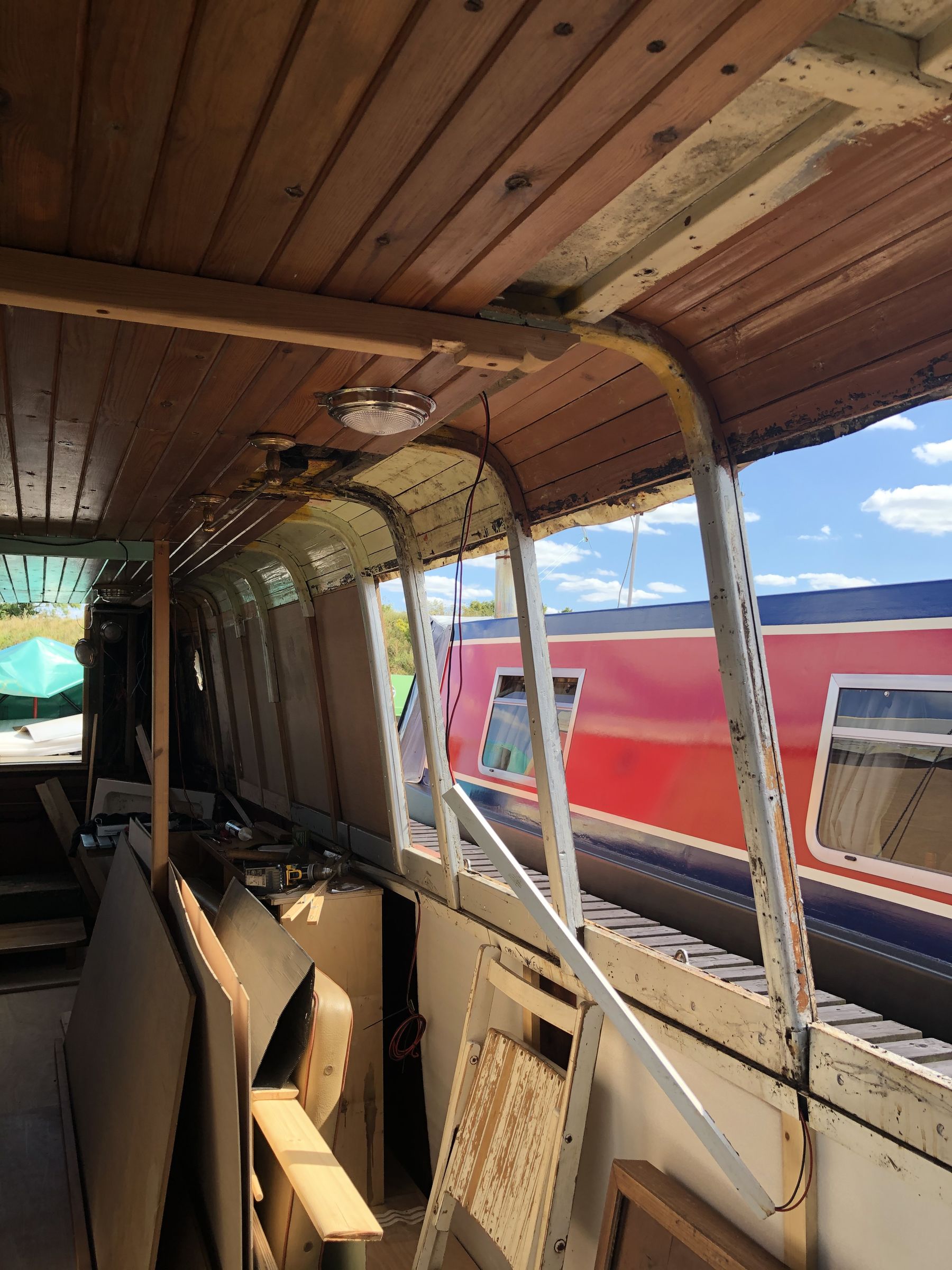

  3. Yes she does have the HA2, and the weights. And she still has the original composite hull!! Do the weights have any special significance? We were told about alot of the past work and do have paperwork but sometimes it can be slightly unclear, on dates and the extent of the work done. I think the previous owners would have kittens if they saw it at the moment. Have had to take the whole interior refit out 1980s I think? Bar the galley kitchen. The shower/bathroom was rotten as a peach. And you know how these things go it carried on the length of the boat. We have discovered some areas of the gunnel are rotten. Going to use fillets of wood to fix. Replacing some of the framework and all new Marine Ply. She did have square windows, but now are thinking put portholes in. We would like some advice on what type of portholes to use to keep a traditional feel. But as the boat is 1935/1960 it’s a bit difficult to know how to blend the two ages. As we have a 1972 brochure we do have a layout so think we may go back to bunks either side, bathroom in the middle. How do you know about past work done?

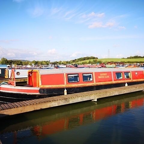

  4. Trying to find out if there is a brochure of Water Lilac. We own her now, and at some point she changed from centre wheel to stern steering. In the photo she had a rounded stern. Then was changed to a straight full teak deck. She also had the engine in a engine room, now changed to under deck. We do have a 1972 brochure but this has the updated version and layout. Would be interested to find out when these changes happened. Especially the transformation of centre wheel to just a hatch. And where did this photo come from??? Any info would be greatly appreciated.
  5. That sounds right, we had the same Masonite board in vintage caravan ceilings. We are going to stick a thinner ply on top of the thicker marine ply. This will hide any screws etc...I was told yesterday to think of it as just adding another ply layer to the multi layered marine ply underneath. With the two pac adhesive, is this the same as the West System. And is resin a different application. We have also been told about the Silver paint that soaks into the wood to waterproof it on the inside of the marine ply. Apparently this stuff is hard to get these days as it has chemicals in it? But the inside of the old ply and the boats main frame work has been painted with it.
  6. We have bought BS 1088 marine ply from a builders merchants. The first lot was slightly darker than the second lot don’t know why but it’s still stamped 1088. When we dismantled the old boards it was marine ply under a thin sort of hardboard similar to what you get on the back of wardrobes, this was glued with a bitumen/tar. Which has been a nightmare to remove and it heats up in the hot weather and runs. We have positioned the ply and was told by someone on the marina to use two pac epoxy glue. This would be to stick a thinner ply on top as a top skin/ finish. It will be painted a colour not left as wood, so should we use the epoxy underneath the primer and top coat paint?
  7. I have spoken before about the Star Class Woolwich Working boats of the 1930s, and how they were cut down to become BW cruisers in the 1960s. We are lucky enough to have become the custodians of one of these named Antony Water Lilac. We have embarked on restoration work and have discovered she needs quite a lot of rebuilding. Some of her frame work needs replacing, possibly a new roof. And we are using new marine ply for the sides of the cabin. It seems she has had some leaks through her gunnels for quite a while. But nothing that can’t be remedied. Her roof has had a belt and braces job of Layers of vinyl flooring which looks very bad. We are going to strip off the old covering and replace with stretched painted canvas?? Does anyone know what the roof covering would have been originally? Any ideas or advice would be great.
  8. Yes! I know the stern was left on a tip, then Willow and Wren bought it much later and converted it for their fleet of boats. Ours has a square cruiser stern, which gives us a nice bit of space, with a teak deck. My profile picture is Water Lilac in the 60s with a central wheel house. Then we have this grey area of time where the cabin must have been changed. Around 2014 she was sunk and through the insurance had a new cabin built in the same style as BW. It really needs a new roof covering as it has lino/vinyl painted and has got extremely damp underneath. What did they use on the roofs in the 60s? Lino just seems the wrong stuff to use, and were they the blue and yellow BW colours? Its blue and yellow painted decor on the inside. What shape sterns did Willow and Wren use I wonder? Who built Indus? And did Willow and Wren convert her to Water Willow, I would love to see a picture.
