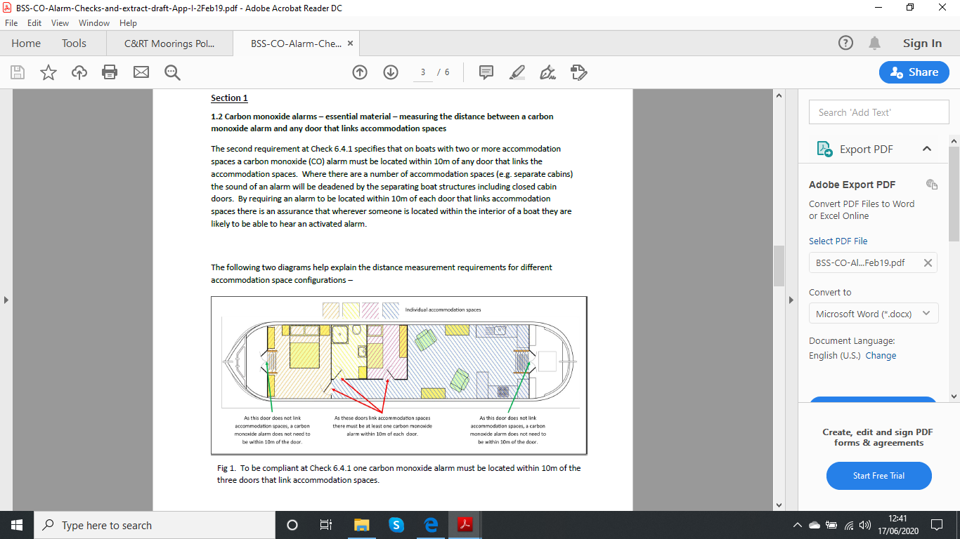

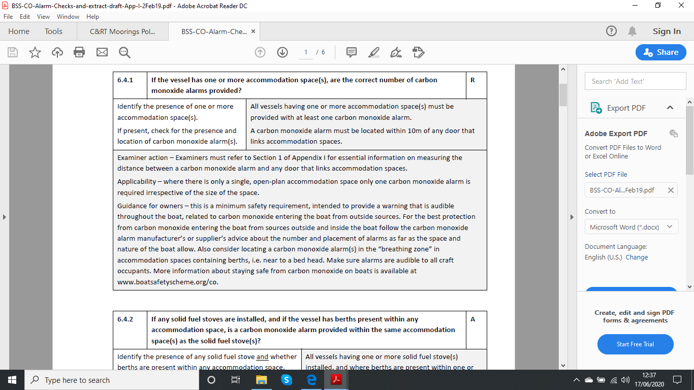

It seems daft but the advice to have the alarm in the room with the appliance is only advisory.
The 'have on in the bedroom' is 'guidance'.
Edited by Alan de Enfield
