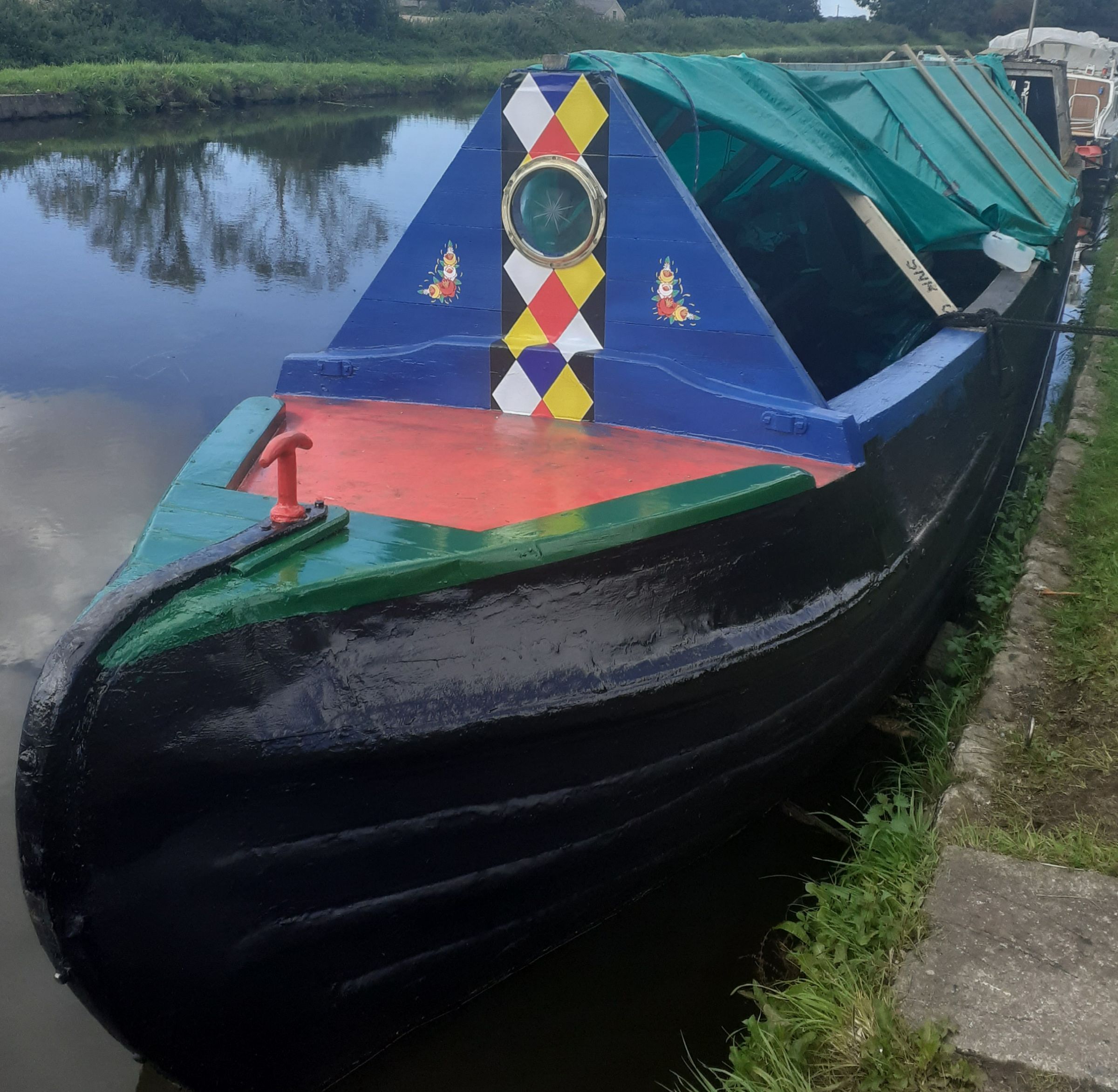

10 minutes ago, glynnbarry123 said:
Hi up date on conway the old wooden boat front end fully restored  all leaks on hull sorted.
Started to removed all rotten wood on stern and replace new cabin . I did put it on Ebay to what intrest ther was in it but usuall full of idiots dont intend to sell her just trying to get some history of her so many different story's about
Were there many leaks to deal with?
1 hour ago, glynnbarry123 said:
Had about 5 on bottom and I up front but managed to recork from inside  just rain water now getting in through temp tarp
Thats not bad. Hopefully she has sealed well for a while!
Hopefully no more leaks want to get all above water line done and new cabin built and new tarp done b4 Christmas  looking to get out of water some time next year to redo bottom

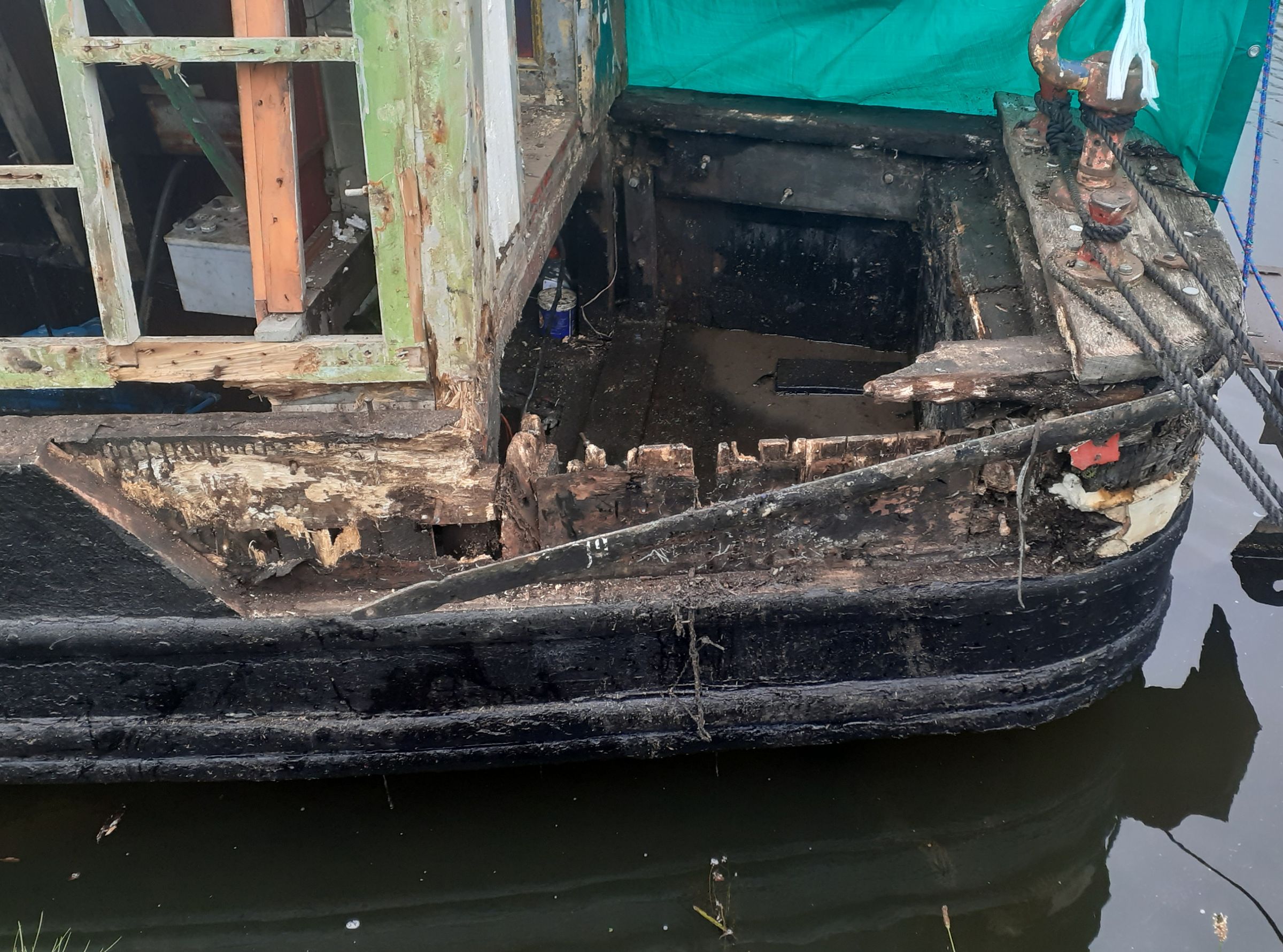

Ah, Wooden boats. Pretty fore end, stern needs a bit of a sort out but at least you have a bit of new wood to build from, that side plank is good. If the counter block is OK then you stand a good chance of getting a usable boat relatively quickly. I can absolutely guarantee that you will never go past a skip without looking in it on the off chance that somebody has chucked a bit of oak away. Very best of luck with it.

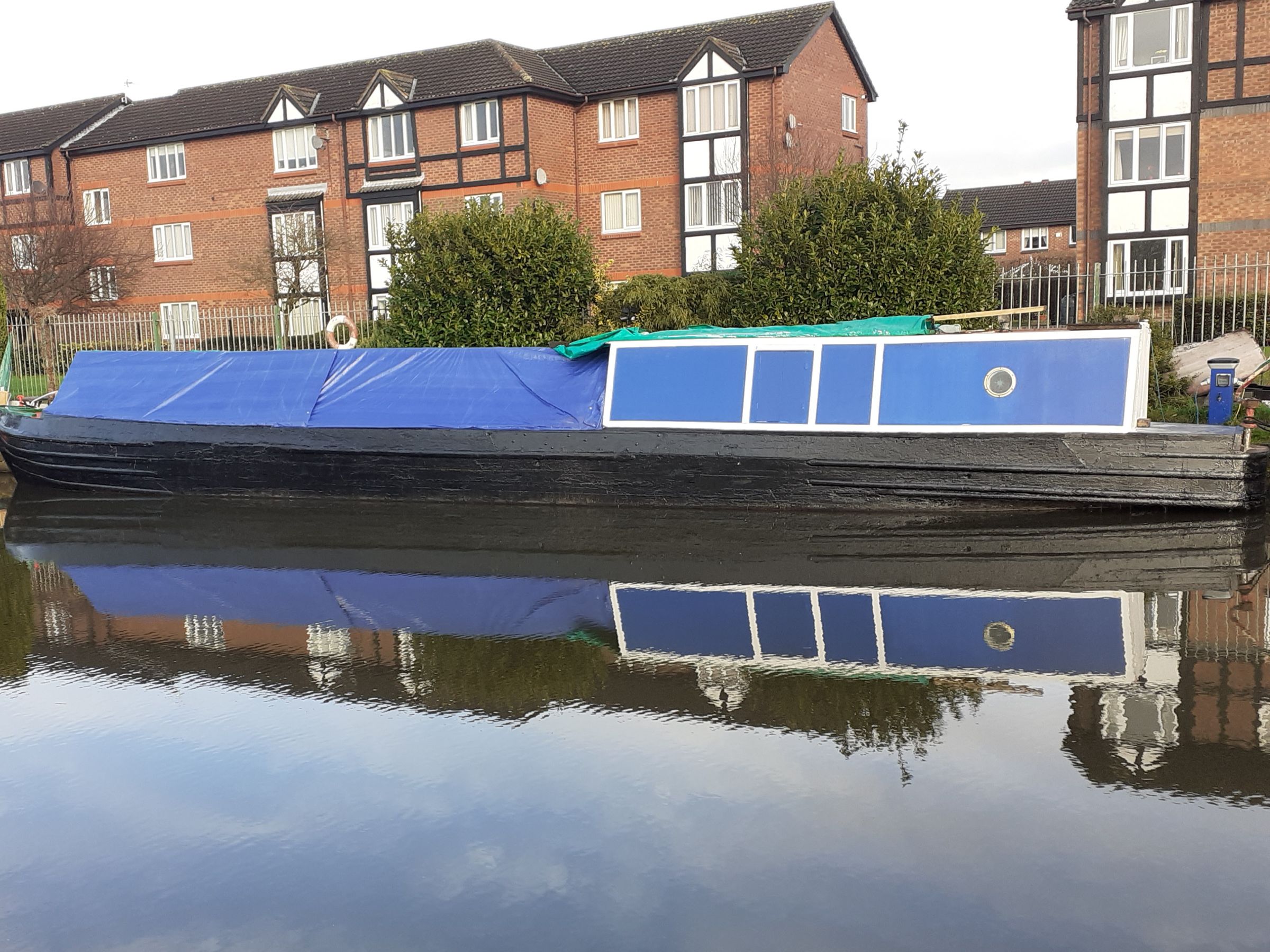

3 hours ago, glynnbarry123 said:
Conway outside nearly finished
Congratulations - you've certainly done a lot of work. I reckon it would benefit from having ballast added at about where the back end of the hold would be. That would get the stern down so the counter is in the water and supported more to stop it hogging further.
