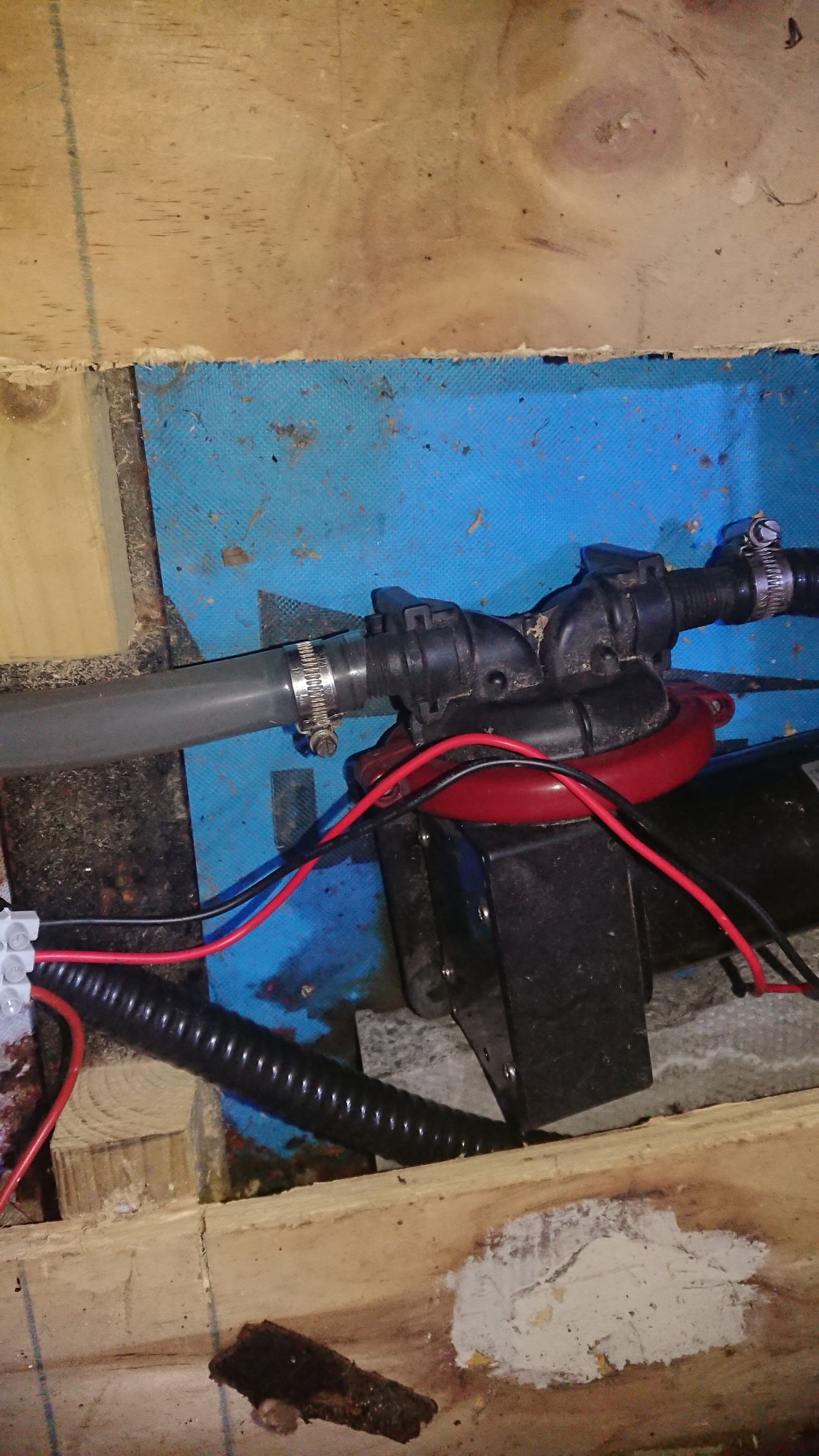

Here we go - near to shower pump looking all fine and blue and other side of the little strut thing (closer to where they over flowed the shower) looking all brown and yucky. Hull is a bit rusty under the brown bit and I wondered about removing...
Will pick up fan heater from other boat at the weekend and give it a blast with that anyway...

Whatever it is also comes in black - same stuff (dry in all places I can currently see) is under the bow cabin flooring I'm taking up. Both are white on the back (you can see a bit folded over in the first picture above)

Oh I see.... THAT stuff!
Yes deffly seen it before. No eye deer what it is.....

Sorry to be dull - but if anyone has any ideas what this is and/or if it is best removed to prevent it collecting damp I could do with advice...
It is more papery than that - less rubbery than the truck stuff and less plasticy than my (cheap camping) tarp.
Sadly no bits currently sufficiently exposed to read it.
It is white on the back and (apart from wet bits) look clean and like it was put in there new.
The nearest texture I can think of is the kind of 'non-woven fabric' they make cheap kids pop-up play tents out of... this kind of stuff. But slightly less flexible and with an integral white backing.
Possibly something could have been delivered in it? When more of the front cabin floor comes up I can have a look for more writing. Sounds like it isn't a standard build thing though? It would have served the anti-abrasion purpose for vibration tolerance but imagine would rip with a sliding paving slab.

I'm not sure, but a few years ago, I helped a friend put a roof on a large shed and we put a membrane on before laying on the felt.  Although it was grey and not blue, it had a similar woven finish and was about the thickness of wallpaper.

It is modern-ish sarking felt, in my guess.  Laid over the rafters, before the battens and tiles.  It is air and vapour permeable - and water resistant.
It might do a job in reducing abrasion, but not so sure about moisture, which will find its way through somehow and is then liable be trapped.
Rightly or wrongly when I ballasted VS many years ago I painted the bilge then Waxoyl 'd  it. The slab ballast was placed on thin waxoyl impregnated laths of wood.

Doesn't really matter whether the papery stuff holds dampness or not. If there is no air gap directly above the baseplate, then any water down there will remain for a long time. Putting the ballast on spacers will allow any free water to drain out and remaing dampness to dry.
