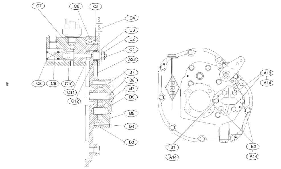

pluto83 Posted October 23, 2019 Author Report Posted October 23, 2019 1 hour ago, Boater Sam said: The seal is a square section O ring, available as a spare, not an ordinary O ring. Grease will keep the spring and ball located whilst you refit the plate. Water in the oil will destroy the gearbox soon, its either flooded in through the breather or your oil cooler is shot. Has the engine needed topping up often and is the gearbox too full? is it not this o ring https://www.asap-supplies.com/brands/prm/prm-04301526-o-ring

Psychalist Posted October 24, 2019 Report Posted October 24, 2019 Once you've got a replacement O ring, which as it comes from ASAP is round section (having recently replaced one myself), your challenge, in replacing it, is getting the old one out. The manual has a more complicated procedure than the one described on these forums, which is to turn the engine over on the starter without starting it (a second pair of hands holding the stop solenoid or cable) - the high pressure oil behind the existing gasket forces it forward along the shaft and enables you to hook it out. Poking down the shaft won't work and could damage the mating surfaces for the new seal. You have to be careful to catch any oil so cover the shaft with a rag and have a container underneath. It takes some effort so a number of attempts may be needed. I suspect this might not work too well if the oil is emulsified or foaming so you might need to clean the box out first. /G
Kingdom Isambard Brunel Posted October 24, 2019 Report Posted October 24, 2019 1 hour ago, Psychalist said: Once you've got a replacement O ring, which as it comes from ASAP is round section (having recently replaced one myself), your challenge, in replacing it, is getting the old one out. The manual has a more complicated procedure than the one described on these forums, which is to turn the engine over on the starter without starting it (a second pair of hands holding the stop solenoid or cable) - the high pressure oil behind the existing gasket forces it forward along the shaft and enables you to hook it out. Poking down the shaft won't work and could damage the mating surfaces for the new seal. You have to be careful to catch any oil so cover the shaft with a rag and have a container underneath. It takes some effort so a number of attempts may be needed. I suspect this might not work too well if the oil is emulsified or foaming so you might need to clean the box out first. /G Using a wet/dry vac will remove the old ring. I'm very surprised that you had a round section ring, I am convinced that the genuine part is square section. Indeed I have seen several PRM boxes that have been "repaired" with a round section ring and they all continued to leak.
Psychalist Posted October 24, 2019 Report Posted October 24, 2019 I took the round section replacement to be the official part, certainly from ASAP I would expect so - all pictures I'd seen appeared round section (including the one linked in post 13, which is what I bought). The one I took out was a bit square, but I assumed that was because it had been compressed in a square hole for 20 years. It was certainly different material to black plumbing o rings, slightly brown and harder material to withstand the heat and pressure. Anything not of that material and dimensions, wouldn't work. As to the détente ball, I don't think the OP need worry given the state of his box, it won't be round and will be rusty. /G
Iain_S Posted October 24, 2019 Report Posted October 24, 2019 6 hours ago, Boater Sam said: Using a wet/dry vac will remove the old ring. I'm very surprised that you had a round section ring, I am convinced that the genuine part is square section. Indeed I have seen several PRM boxes that have been "repaired" with a round section ring and they all continued to leak. We had that problem once (quite a few years ago now!) Offending new ring, which had come from a box of assorted "O" rings, was replaced by one with a slightly section : problem solved Would be interesting to see if a ring from PRM was round or square section!
