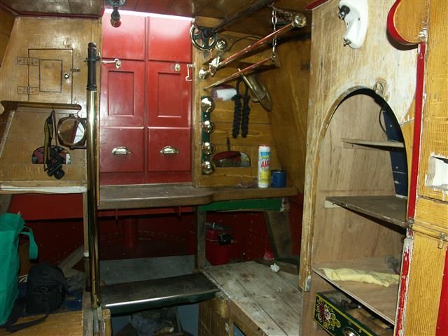

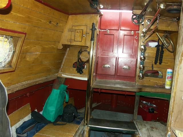

Derek R. Posted May 22, 2019 Report Posted May 22, 2019 (edited) Mostly tongue and groove Deal originally, Supalux board or similar asbestos based board was used beside the range, and maybe behind it for wooden cabins. Steel cabins behind the range were bare and scumbled. That's going by what TYCHO (Middle Northwich, steel cabin) was fitted with. There is ply also, but how much of that is original is questionable, as TYCHO was on maintenance from 1942 and may well have had the table cupboard and cross bed ripped out. The images that follow show a green painted board with a curved top protecting the side of the table cupboard, this was some sort of asbestos material. Handling asbestos board is only dangerous when cutting or drilling are involved. Modern heatproof materials are less injurious to health. There would be a tin plate screwed onto the tongue and groove range bed. The range would normally be on short legs - handy for slipping a fry pan under or just fire irons. Edited May 22, 2019 by Derek R.
Steve Priest Posted May 22, 2019 Report Posted May 22, 2019 (edited) 13 hours ago, archie57 said: I was told they were lined with poleite ( - think that's how you spell it!), an asbestos-containing board I never knew what it was called, but it was a fibrous board material half an inch thick, it was fitted between, not over, the steel framing which was left exposed. It was fitted with brass machine screws which were drilled and tapped through the cabin sides and roof, and then ground flat on the outside. If anyone has stripped the paint off an original Northwich cabin and wondered what all the brass dots are - that’s it.. The furniture was then fitted using deal boarding. With all the exposed steel framing they must have run with condensation, hence the reason that BW cut most of the cabins off the big Northwiches and replaced them with wood. Many that did survive were re- lined with t&g in a more conventional manner, which seems to me a far better idea than cutting them off, but the t&g lining was a later modification and not as original. This was not only true of little Northwiches, but of all the Northwich Grand Union boats. When Ian Kemp restored Sculptor he lined the cabin in the original fashion, as we did at Brinklow when we did the Scorpio. I believe that the butties Leo and Malus were done in that as well. Edited May 22, 2019 by Steve Priest Spell checker 1

alan_fincher Posted May 22, 2019 Report Posted May 22, 2019 5 hours ago, Steve Priest said: I never knew what it was called, but it was a fibrous board material half an inch thick, it was fitted between, not over, the steel framing which was left exposed. It was fitted with brass machine screws which were drilled and tapped through the cabin sides and roof, and then ground flat on the outside. If anyone has stripped the paint off an original Northwich cabin and wondered what all the brass dots are - that’s it.. The furniture was then fitted using deal boarding. With all the exposed steel framing they must have run with condensation, hence the reason that BW cut most of the cabins off the big Northwiches and replaced them with wood. Many that did survive were re- lined with t&g in a more conventional manner, which seems to me a far better idea than cutting them off, but the t&g lining was a later modification and not as original. This was not only true of little Northwiches, but of all the Northwich Grand Union boats. When Ian Kemp restored Sculptor he lined the cabin in the original fashion, as we did at Brinklow when we did the Scorpio. I believe that the butties Leo and Malus were done in that as well. As ever, I'm sure this is a completely on the nail description from Steve. I don't think any of us who now have GUCCCo Northwich back cabins, (either original or later copies), would conceivably want to live with a boat the way they first supplied them!
