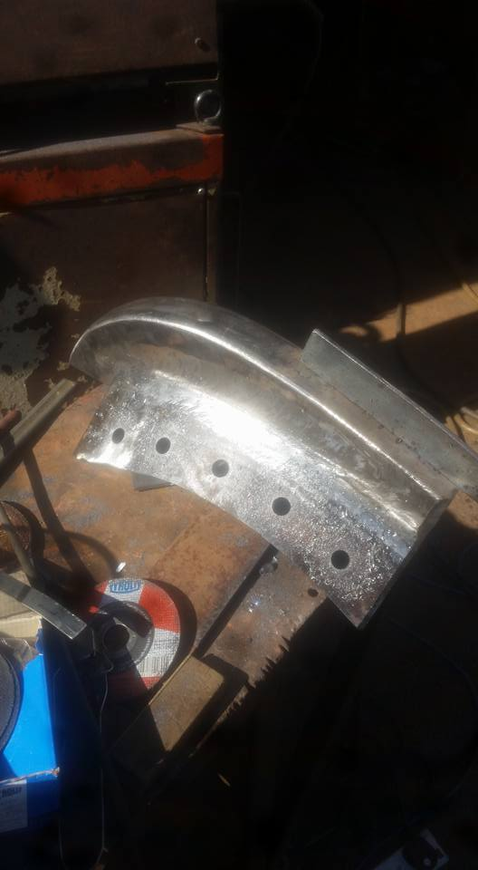

TThis This photo of the reconstructed top part of a Woolwich stem post shows what a complicated and magnificent bit of kit the complete stem post is on these boats. The side plates/top bends are rivetted through the holes. On a Northwich these aren't present and the plates are rivetted through the centre bit of the stem. Being built at Brinklow Boat Services for Star.
