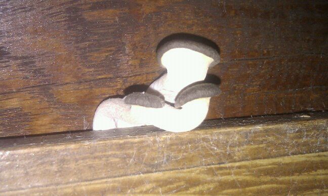

Now I'm no idiot, I know if you have mushrooms growing INSIDE your boat out of your wooden cabin, its not great.
I also know I should really remove them asap due to spores etc but I cant help hoping that a forth mushroom will sprout to complete 'The Beatles'. What do you think, shall I wait to see?

Well after investigation, it appears to be growing in-between the cabin side and the strip of wood that has come away, so not directly out of the wood (hoorah!)

Well I am very fond of mushrooms but that would certainly make me "Twist and shout"! Do What Richard says, "get rid of it" and seek some specialist advice regarding treating the surrounding woodwork with something nasty. Just sploshing it with Cuprinol will not be enough.

This is not dryrot!!
Well, it looks exactly the same as the last outbreak of fungi we had on the forum, which was dryrot
Whatever it is, the fruiting spores you have represent about one tenth of the organism. So, somewhere inside the wood behind your panelling is a lot of rot

MORE: OK, now Mick has resurrected his thread, it is oyster fungus. Even so, this is only the fruiting body. Imagine you can see a bunch of grapes, the rest of the grape vine is growing inside your woodwork

The last fungus we had was the same. An oyster mushroom that had been growing in conditions far from ideal enough for it to produce the typical heads we all associate with Oyster fungus. It certainly isnt dry rot.
ETA: It is of course far from ideal to have any fungus growing in your boat and the reasons should be investigated and fixed.

The fungus has been removed (it came out very easily, could've just flicked it off) and is only about 4cm in length (that includes the root). Although it did seem to come up over night, it hasn't grown since then, so if Im honest, Im not especially worried about it
I've checked and there is no more down there

That isn't the whole fungus, just the fruit. All the rest of the fungus is still there

Just bear in mind that the pic is massively zoomed in, and the mushrooms on the pic are only about 2cm, with the root another 2cm. Pulling away the board shows there is nothing else down there. Certainly nothing like Mick's beast!

Unfortunately, that isn't how fungi work. They exist as threads inside rotting material - in this case your boat's woodwork, and once a year produce a number of fruiting bodies. You have the fruiting body including the stem that connected it to the main fungus.
Expect more mushrooms

Put simply, there is already a problem for mushrooms to exist... they only grow where there is decay!! they arnt the problem just a manifestation of an underlying cause... ie damp warmth rot, they dont need light to grow
