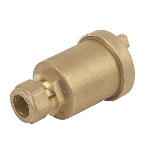

The symptons you describe (screeching pump, spurting header tank and bangs caused by parts of the water circuit boiling while others remain cool) point to a system that still has air in it.  It can take quite a bit of patient fiddling to get rid of the air.  I recommend auto-bleed valves on the radiators and an auto air vent plumbed into the highest part of the system.  (Google Altecnic 502649 15 mm Auto Air Vent Robocal)
Ah. I see TheBiscuits has the same thought.
That is a beautiful device. I must have one.  Or two. (just in case I get a radiator.)
No it isn't. That particular one is horribly prone to failing and dribbling water out. I don't use those any more.
The best one is the Flamco Flexvent. Still not bombproof though.
https://www.ebay.co.uk/itm/1-2-Flamco-Flexvent-Floatvent-c-w-shut-off-valve-Automatic-Air-Vent-BNIB/172961052155?hash=item28454835fb:g:ttYAAOSwEaBZ-1SJ
Do Maplins stock them? :giggles:
Joking aside, they look a much tidier unit than the bottle vents.
Haven't seen these before, will give one a go as the bottle type I have been using is a biannual replacement!
If there's space how about fit a vertical dead leg with a normal bleed screw on top?
Doesn't the little screw on a bottle vent let you seal it when enough air has been bled out?
