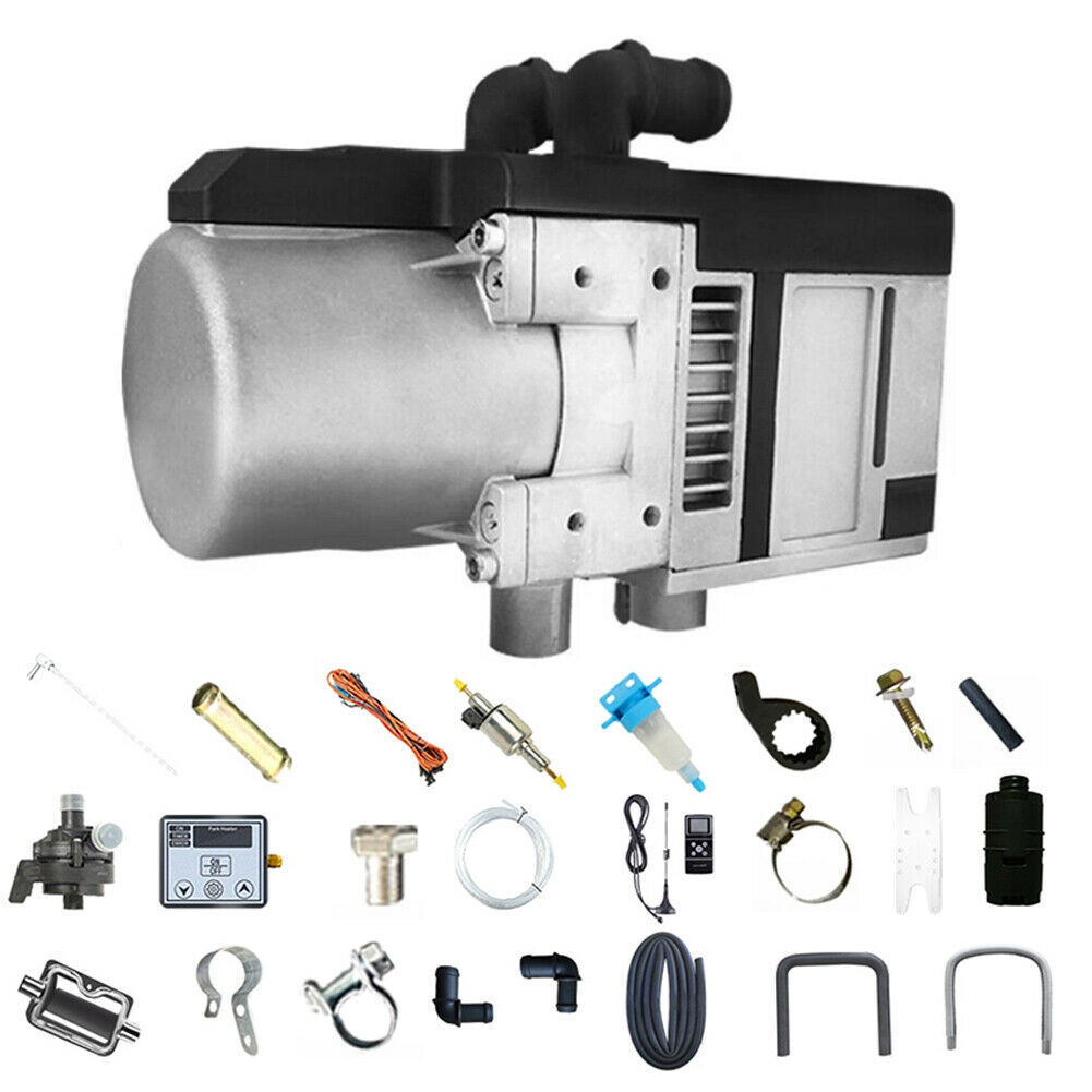

MtB Posted January 16 Report Share Posted January 16 (edited) 50 minutes ago, Tony Brooks said: Don't rule out the Russian/Chinese version of those heaters. We seem to be getting fair reports about them. Are those not warm air blowers? I've not noticed any that heat water and radiators but I'm off to do a bit of googling to find out more.... Edit to add: Yes there are, they seem to cost about £350 or so, so not cheap like the air heaters. Here's an example. https://www.ebay.co.uk/itm/275042119767?_trkparms=ispr%3D1&hash=item4009c9b057:g:~A4AAOSw1e1hoMIi&amdata=enc%3AAQAGAAACoPYe5NmHp%2B2JMhMi7yxGiTJkPrKr5t53CooMSQt2orsSlHY%2FYTip4QFVjNQrCEJt6nb4%2Be3f4ynFgrJK9phWPdP%2BkcYB4CB%2F1AGGKG8qTNFF4ijz1bjE7sKKd%2B6Jw%2BrTL8xzXm%2FMoLFqJkMw59RQWJPufMTQl%2FH9qEkAVdxB%2FMCzx0L3mCsDpIQRRHMjPle8D5eWxXCvCDW9bTEGQq0CmIiWPZOxOMuzq%2B8h%2BFonaLhbuLvmG5Npje5Ld2eAExeK5KZuUnq%2BB%2FHsb5onkk8RFEfZKN8wYoDRUrC3fO5%2BIBFeEoKV4J8v%2FvYuugIxDvoTH3qYcHrk0OJL9SM3%2BbQk0C70ClTaWSIPMlzpDxFxFR7fs0nuNWd%2BMVg%2BfVg4lw9BAzCDF%2Bt0XXdiXVXU%2FivUH1PxFqSyNGC3n222JlIcmeoQFVGH7TDzjdm6vCnzQK7F%2B64qHC%2Fi0mu2D8dNKm00TvNLLg0Uv%2BouyPW8cIrEF5vsSCDJapgOfRAZ8ZdZTpECAjdS0vth8Rv9gEp6FOBdx%2B%2BhQO7nJGU6RJVuK4Xcq8%2F9IcXs9LeeUzdb%2FtikeEN1wxJ6l%2Bv0m3BpiAXEIJQAf1cq%2FmjI76T4g2%2FPYuTBQgfDmVhxXBt4qKQZ4ZhsPN9XLZCwqSK%2F8HXaqhLlLaIiw24ZAr0oaoYC0q%2F5Fgtf%2BtNY5MQR%2BQarPoWzoGi5GfOx5vOvJFYI%2FD19SafBqb0iI%2FUdgMt8wPv%2Bkziv0MySmDNhctkOUJPC5SMJ%2BOPImSlNsCKpCfcHURkV9Hva1gbiUmNeuDfXWfLuf%2FgkoNd5gpKPrxvvnK06RUsNw7qJYmzKrvl4VOPKXYpWB%2B5n0zK2XCzePC2Wtb4AIFsKP4wPGvBRib%2FhvKEkcm%2FDHER1lmC9ew%3D%3D|clp%3A2334524|tkp%3ABFBMtPzNuMxf Edited January 16 by MtB Link to comment Share on other sites More sharing options...

David Mack Posted January 16 Report Share Posted January 16 2 hours ago, MtB said: Are those not warm air blowers? I've not noticed any that heat water and radiators but I'm off to do a bit of googling to find out more.... Edit to add: Yes there are, they seem to cost about £350 or so, so not cheap like the air heaters. Here's an example. https://www.ebay.co.uk/itm/275042119767?_trkparms=ispr%3D1&hash=item4009c9b057:g:~A4AAOSw1e1hoMIi&amdata=enc%3AAQAGAAACoPYe5NmHp%2B2JMhMi7yxGiTJkPrKr5t53CooMSQt2orsSlHY%2FYTip4QFVjNQrCEJt6nb4%2Be3f4ynFgrJK9phWPdP%2BkcYB4CB%2F1AGGKG8qTNFF4ijz1bjE7sKKd%2B6Jw%2BrTL8xzXm%2FMoLFqJkMw59RQWJPufMTQl%2FH9qEkAVdxB%2FMCzx0L3mCsDpIQRRHMjPle8D5eWxXCvCDW9bTEGQq0CmIiWPZOxOMuzq%2B8h%2BFonaLhbuLvmG5Npje5Ld2eAExeK5KZuUnq%2BB%2FHsb5onkk8RFEfZKN8wYoDRUrC3fO5%2BIBFeEoKV4J8v%2FvYuugIxDvoTH3qYcHrk0OJL9SM3%2BbQk0C70ClTaWSIPMlzpDxFxFR7fs0nuNWd%2BMVg%2BfVg4lw9BAzCDF%2Bt0XXdiXVXU%2FivUH1PxFqSyNGC3n222JlIcmeoQFVGH7TDzjdm6vCnzQK7F%2B64qHC%2Fi0mu2D8dNKm00TvNLLg0Uv%2BouyPW8cIrEF5vsSCDJapgOfRAZ8ZdZTpECAjdS0vth8Rv9gEp6FOBdx%2B%2BhQO7nJGU6RJVuK4Xcq8%2F9IcXs9LeeUzdb%2FtikeEN1wxJ6l%2Bv0m3BpiAXEIJQAf1cq%2FmjI76T4g2%2FPYuTBQgfDmVhxXBt4qKQZ4ZhsPN9XLZCwqSK%2F8HXaqhLlLaIiw24ZAr0oaoYC0q%2F5Fgtf%2BtNY5MQR%2BQarPoWzoGi5GfOx5vOvJFYI%2FD19SafBqb0iI%2FUdgMt8wPv%2Bkziv0MySmDNhctkOUJPC5SMJ%2BOPImSlNsCKpCfcHURkV9Hva1gbiUmNeuDfXWfLuf%2FgkoNd5gpKPrxvvnK06RUsNw7qJYmzKrvl4VOPKXYpWB%2B5n0zK2XCzePC2Wtb4AIFsKP4wPGvBRib%2FhvKEkcm%2FDHER1lmC9ew%3D%3D|clp%3A2334524|tkp%3ABFBMtPzNuMxf That claims to run on diesel or petrol. Really?? Link to comment Share on other sites More sharing options...
Phoenix_V Posted January 17 Report Share Posted January 17 They do look rather similar and £300 difference in price! I think gasoline is just a mistranslation. Whichever one is bought a marine exhaust is needed! (which will be extra) Link to comment Share on other sites More sharing options...
