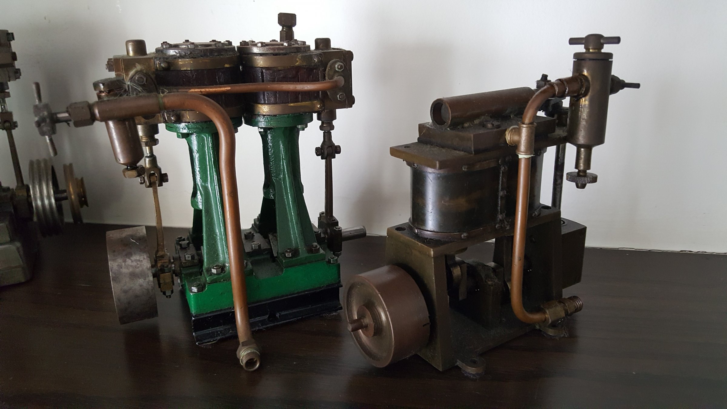

I am new to canal boating and considering buying a live aboard for early retirement in the next years and just starting to do some basic research. Working model steam engines are a passion of mine and I am wondering of the feasibility of combining this hobby, albeit swapping for a vintage diesel, into the boat.

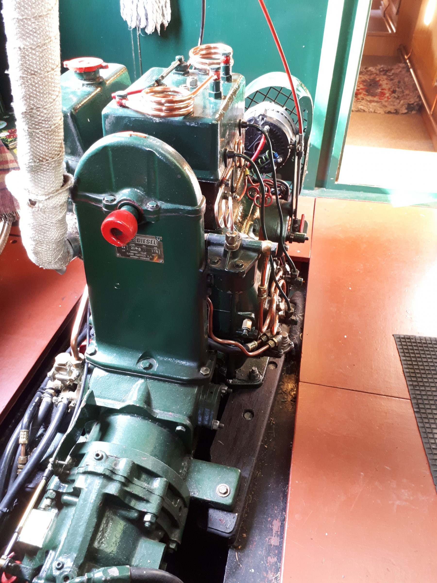

Agreed - 1993 and 1954 in my case
Engine porn alert! I see that you don't spare the Brasso (and also that you hang your mop in the engine room, either that or you have a levitating terrier).
