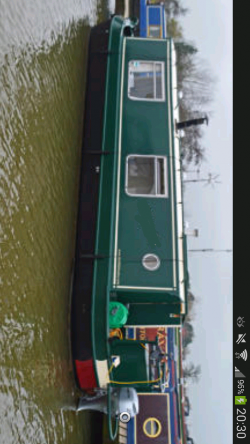

Being a single bloke I just wondered if this sort of craft was at all suitable as a liveaboard (ignoring the outboard engine.) Its 27ft and on the face of it I like it, or at least something very similar. Does anyone currently live on, or have experience of staying on anything similar in the long term? Apologies that the photo is ar$£ upwards. :-)
Ignoring the outboard engine is a BIG mistake. On a liveaboard you need an inboard engine to charge the batteries and (possibly) heat the water. You'll have neither with an outboard.

In a mains electric marina it would be tight for space but adequate for one, anywhere else and the electricity generation available from and outboard and the total lack of heat into the cabin would make it impossible in my opinion -Oh! then there is the issue of petrol stored for movement which is onerous to do in compliance with BSS but possible, then the fact that petrol is rare on the cut (easier on the Thames) and at least double the price of red diesel.

Given that boat has no electricity, I don;t think its a viable liveaboard...

I'm thinking you already had your mind set on this boat when you posted, you posted earlier about boats with outboard engines.
It's not suitable as a liveboard boat unless you intend to stay in a marina and have permanent mains power.

Our old narrowboat was 24ft, with about 14ft of internal space, and I can certainly see how a single person could have lived aboard if it weren't for the electricity issue (it had an outboard). The layout included a fixed single berth/seat and wet room with shower, both opposite a long row of kitchen units, then a living area with a stove and seating/removable table that converted to a double bed. No hanging space, but plenty of storage under all the seats and the front deck, and in the galley. Plus a big enough front deck to sit out on.
Plenty of people can and do live on boats of a similar size. It's all relative - even a big narrowboat is small compared to a house, but even a small narrowboat is big compared to, say, a camper van. People manage to live in all sorts of small spaces, and at least these small spaces have cooking facilities, toilets, showers, insulation, electricity and water on tap. Oh, and absolutely huge gardens.wink.png
