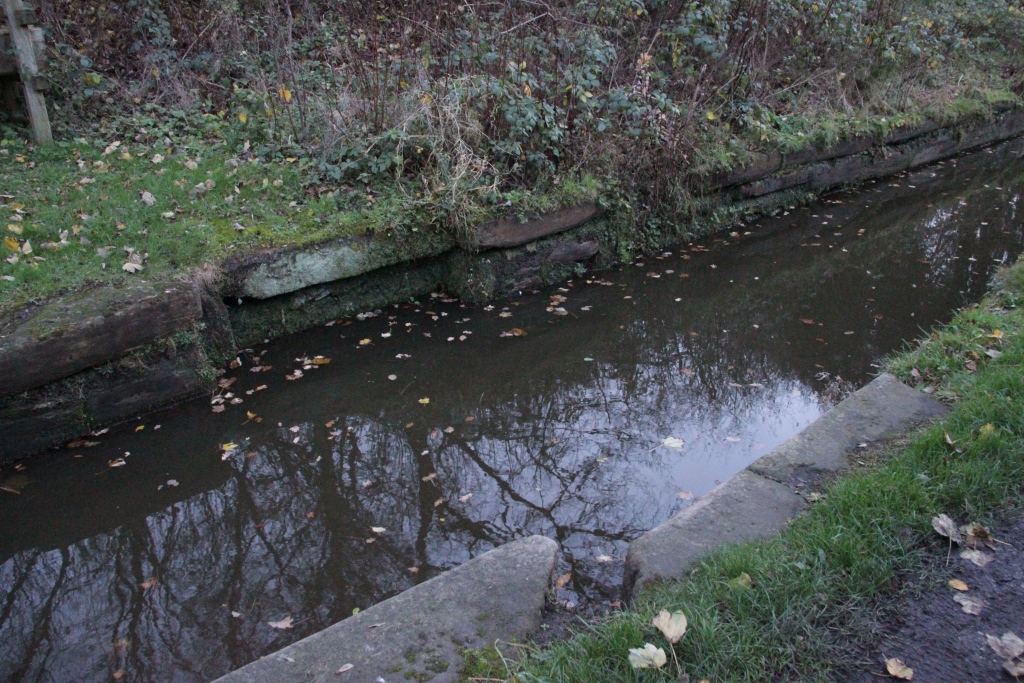

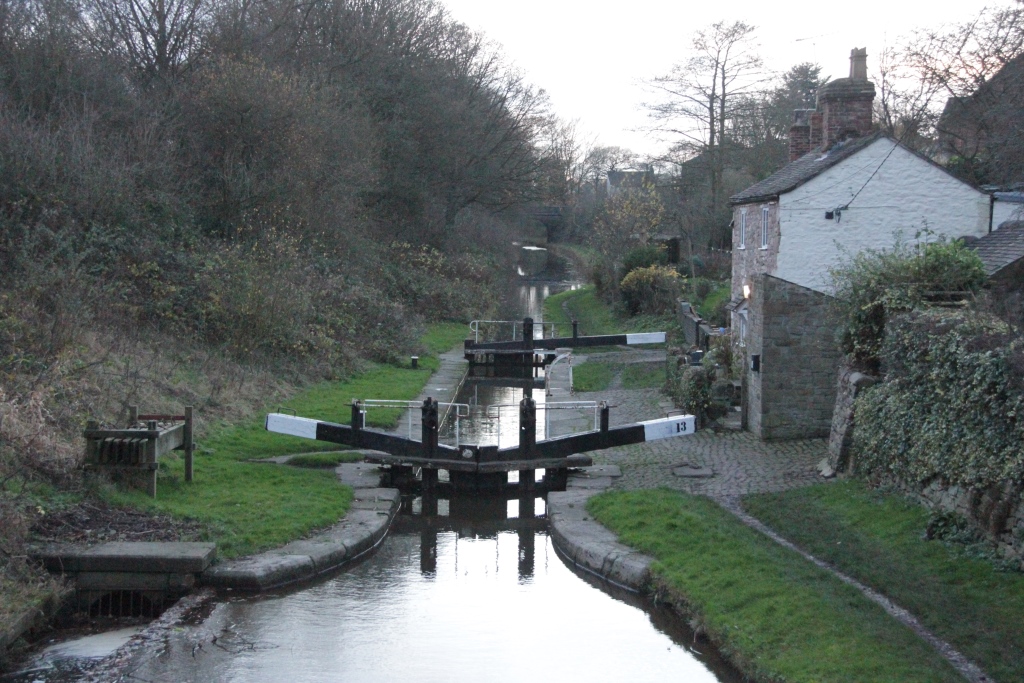

magpie patrick Posted December 11, 2015 Report Posted December 11, 2015 (edited) I've just spent a day or so on Lutine, finally preparing her for the long journey south. She is moored at Scholar Green, so I had a walk down to Hall Green Stop Lock, which had a fall of about a foot from the Macclesfield Canal to the Trent and Mersey Canal. First, as most people I'm sure know, it is at the junction even though it's about a mile from the main line of the T&M. For reasons that have variously been thought of as astute or paranoid the T&M built branches to connecting waterways rather than allowing a junction direct to the main line (thinking about it, this a slight overstatement - they built branches to connect to the Macc and the SU Middlewich branch. For complicated reasons they also built five miles of the Coventry Canal but I digress...)The lock can be seen here... The gate arrangement is odd and has been discussed before - twin top gates and a single leaf bottom gate. What has also been commented on before is the astonishingly long structure. From the upper wing wall to the lower wing wall is about 270 feet, the structure being a bare 7 feet wide for about 240 feet. the operational lock is a standard 70 feet or so (84 feet from gate hinge to gate hinge) In the long length below the lock the following recesses can be seen These appear to be a pair of gate recesses for gates pointing towards the Trent and Mersey Canal, and are about 40 feet downstream of the bottom gate also Much more overgrown but another gate recess about 80 feet downstream of the first pair. There is evidence of a similar recess on the towpath side but it is obstructed, and the light was failing so it was difficult to photograph The size of the two would again indiacte a pair of gates. The naked eye can pick out that the left hand edge (the edge nearest the present lock) is curved, again indicating gates pointing towards the T&M. Finally, for this post at least, the sharp eyed may have noticed a bywash on the left of the first picture - this is the other end of it, to the right of this picture. So, obviously a lock and obvious (to me at least) not often used and not used for a long time if ever. Does anyone know anything of it's operation or function beyond the obvious? And why not build a single chamber with two sets of gates? Edited December 11, 2015 by magpie patrick 1
Richard West Posted December 11, 2015 Report Posted December 11, 2015 I've just spent a day or so on Lutine, finally preparing her for the long journey south. She is moored at Scholar Green, so I had a walk down to Hall Green Stop Lock, which had a fall of about a foot from the Macclesfield Canal to the Trent and Mersey Canal. First, as most people I'm sure know, it is at the junction even though it's about a mile from the main line of the T&M. For reasons that have variously been thought of as astute or paranoid the T&M built branches to connecting waterways rather than allowing a junction direct to the main line (thinking about it, this a slight overstatement - they built branches to connect to the Macc and the SU Middlewich branch. For complicated reasons they also built five miles of the Coventry Canal but I digress...) The lock can be seen here... Lutine and Hall Green 007.JPG The gate arrangement is odd and has been discussed before - twin top gates and a single leaf bottom gate. What has also been commented on before is the astonishingly long structure. From the upper wing wall to the lower wing wall is about 270 feet, the structure being a bare 7 feet wide for about 240 feet. the operational lock is a standard 70 feet or so (84 feet from gate hinge to gate hinge) In the long length below the lock the following recesses can be seen Lutine and Hall Green 017.JPG These appear to be a pair of gate recesses for gates pointing towards the Trent and Mersey Canal, and are about 40 feet downstream of the bottom gate also Lutine and Hall Green 019.JPG Much more overgrown but another gate recess about 80 feet downstream of the first pair. There is evidence of a similar recess on the towpath side but it is obstructed, and the light was failing so it was difficult to photograph The size of the two would again indiacte a pair of gates. The naked eye can pick out that the left hand edge (the edge nearest the present lock) is curved, again indicating gates pointing towards the T&M. Finally, for this post at least, the sharp eyed may have noticed a bywash on the left of the first picture - this is the other end of it, to the right of this picture. Lutine and Hall Green 021.JPG So, obviously a lock and obvious (to me at least) not often used and not used for a long time if ever. Does anyone know anything of it's operation or function beyond the obvious? And why not build a single chamber with two sets of gates? This might explain it. http://www.macclesfieldcanal.org.uk/hallgreen.htm
magpie patrick Posted December 11, 2015 Author Report Posted December 11, 2015 (edited) This might explain it. http://www.macclesfieldcanal.org.uk/hallgreen.htm Thanks I'd worked out the lock working both ways, and the "jealous" or at least, "careful" canal companies. Other companies didn't go quite so mad though, this was the arrangement where the Warwick and Birmingham joins the Digbeth Branch at Warwick Bar That's come out a bit big! one chamber, gates pointing both ways, whereas Hall Green is over twice the length of a conventional lock. Interesting to note that both lock keepers cottages (I'll venture they were actually toll-keepers, one for each company) are next to the lock that is used now - clearly that's where they expected the action to be, and also shows the two companies could cooperate up to a point. So why not over having just one lock? Edited December 11, 2015 by magpie patrick
dmr Posted December 11, 2015 Report Posted December 11, 2015 Maybe the relationship and co-operation was bad so they needed their own locks, and one company built the cottage where it is so they could work their own lock and keep a close eye on the other one????. Are there any historic accounts of how strictly stop locks were guarded and managed? Are they something the owners installed and then did not bother with too much, or did the lock keepers agressively police them??? I fear a lot of history has got lost. ................Dave

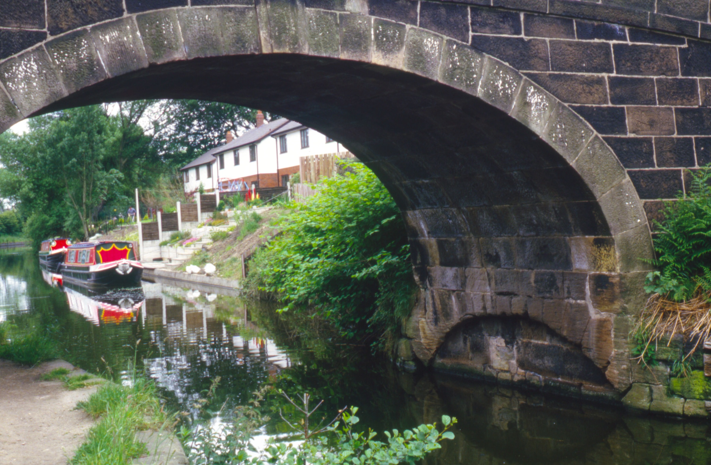

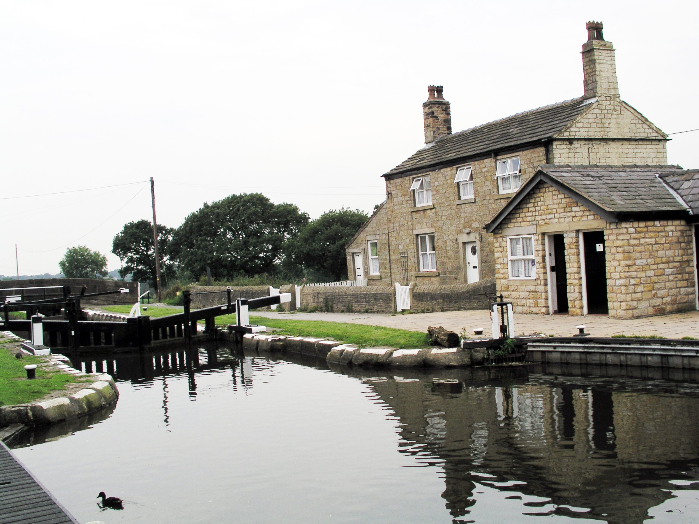

Pluto Posted December 12, 2015 Report Posted December 12, 2015 This is the top of Johnsons Hillock, where the Lancaster met the L&LC. The extra rebate was for gates controlled by the L&LC so they could stop their water from feeding the Lancaster if necessary. There are similar recesses at the top of Wigan locks. Building a whole extra lock does seem a bit excessive.
magpie patrick Posted December 12, 2015 Author Report Posted December 12, 2015 Pluto, what's the paddle on the right for? I knew of the arrangement at Johnson's Hill, but not at Wigan, presumably the reverse applied there. It must be said if those second set of gates at either location had ever been used trade would have been well stuffed! Dave (dmr) that's a fair point, I've no evidence for it but suspect the T&M would probably have been happier if the Macclesfield had remained unbuilt, as it provided an alternative route to/from the east side of Manchester. Of course in practice they got a heck of a lot of trade off the Macc. Richard West, do you know anything more behind the page you cited? I hadn't picked up on the two cottage thing until you posted that.
Richard West Posted December 12, 2015 Report Posted December 12, 2015 Pluto, what's the paddle on the right for? I knew of the arrangement at Johnson's Hill, but not at Wigan, presumably the reverse applied there. It must be said if those second set of gates at either location had ever been used trade would have been well stuffed! Dave (dmr) that's a fair point, I've no evidence for it but suspect the T&M would probably have been happier if the Macclesfield had remained unbuilt, as it provided an alternative route to/from the east side of Manchester. Of course in practice they got a heck of a lot of trade off the Macc. Richard West, do you know anything more behind the page you cited? I hadn't picked up on the two cottage thing until you posted that. Sorry, I don't know any more. I just remembered that I'd seen it when checking up on the Macc for our holiday earlier this year.
Pluto Posted December 12, 2015 Report Posted December 12, 2015 This is the top of Johnsons Hillock, where the Lancaster met the L&LC. The extra rebate was for gates controlled by the L&LC so they could stop their water from feeding the Lancaster if necessary. There are similar recesses at the top of Wigan locks. Building a whole extra lock does seem a bit excessive. It provides a feed down the flight, especially as you can see it is just cracked open in the photo. Wigan flight used a lot of water, especially as mining subsidence took hold. The top lock had a fall of 15 feet 6 inches in the late 19th century, and the locks, particularly on the upper section of the flight, had to be equalised on several occasions to reduce water usage. This photo shows the stones which have been inserted to raise the top lock.There were water depth marks on the stone, and they can still be seen, but with a gap where indicated here.

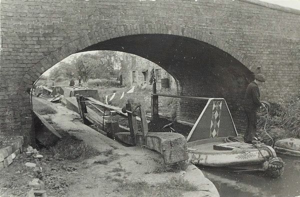

Pluto Posted December 18, 2015 Report Posted December 18, 2015 This was the lock proposed in 1905 at Leigh between the L&LC and the Bridgewater. Because of mining subsidence, and the way the two canals were controlling this, there was the possibility that one canal would end up higher than the other, hence the double gates.

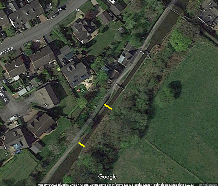

Kingsford Posted March 25, 2023 Report Posted March 25, 2023 Sorry to bump what is such an old post, but I've had questions about Hall Green that I still haven't quite fully found a good answer to. Some of the confusion may be how terms are being/have been used (is the "stop lock" the water in between either of the gates, or just the "down" gate on either lock?). But, just to describe the setup in the overly-long chamber from north to south you had a set of pointed gates, then a single gate, then a small gap in between, then another single gate, and then another single gate at the entrance to the T&M side? Did I get that correct? From the various pieces I've read on this, it seems that the purpose was originally to keep the Macclesfield slightly higher to 'protect' the T&M Hall Green branch. And, if that was the case, the Macclesfield lock really just functioned as a lift lock. Anyone have any of the original documentation organizing the development of the canal? The Macclesfield website seems to at least imply that any lock where the two met was simply to prevent water loss from the T&M. But then you see mentions all over that "either canal could be higher." This seems to skip right over in time the explanation for the development and purpose of the T&M lock. But we know that it was needed for one reason or the other, so I guess them both functioning as lift locks would make sense. To end, a boat traveling "down" the from the Macclesfield would be locked down into the Macclesfield lock, and then in the chamber the three other gates would simply be opened - after they paid their toll to T&M - to allow passage? Is it that simple? Would kind of like to see someone make a little diagram describing how this setup worked.
David Mack Posted March 25, 2023 Report Posted March 25, 2023 If the Macclesfield level was higher you would lock down through the Macclesfield lock then pass straight through the T&M lock, and vice versa if the T&M was higher. Either way the only water transfer between the two would be a very shallow lockful. Without the stop locks there would be uncontrolled (and unquantified) flow either way.
Pluto Posted March 25, 2023 Report Posted March 25, 2023 Stop locks were found at most places where one canal company met another so that the canal with the higher water level could protect its water if there was any disagreement. There was usually some mention of restrictions or control of water in the Act under which a stop lock was built. This is the one at Johnsons Hillock on the L&LC, where the locks were built and owned by the Lancaster Canal Company, but the Leeds & Liverpool had control of an extra set of gates, now removed. You can still see the L&LC gate recess, which became unnecessary when the L&LC leased the southern Lancaster in 1864. When they were serviceable, I expect the L&LC stop gates were left open and the Lancaster's lock was operated as normal. There was a second lock house part way down the flight, which could have been built by the Lancaster, while the one in the photo was built by the L&LC for their man to control passage through the top lock.
Kingsford Posted March 25, 2023 Report Posted March 25, 2023 (edited) 13 hours ago, David Mack said: If the Macclesfield level was higher you would lock down through the Macclesfield lock then pass straight through the T&M lock, and vice versa if the T&M was higher. Either way the only water transfer between the two would be a very shallow lockful. Without the stop locks there would be uncontrolled (and unquantified) flow either way. Right, I understand the basic purpose, and that would exmplain why the T&M manuevered to have the new Macclesfield install a stop gate, but doesn't explain the reason for then building their own stop backed right up to it, except for obvious redundancy in case something happened to the Macclesfield stop gate. And, maybe, the explanation it's just that simple (redundancy). But, as has been discussed, this was a very unusual setup. We're talking two chambers with four sets of doors in which both locks could act as lift locks; in fact, it seems arguable that that was their primary function. Typically, these canal junctions would only have two doors, correct? I think the other thing is that when we're talking about a "lock" we're usually talking a pound enclosed by two sets of doors to provide a rise/fall, whereas a "stop lock" is just a gate, right? Edited March 26, 2023 by Kingsford

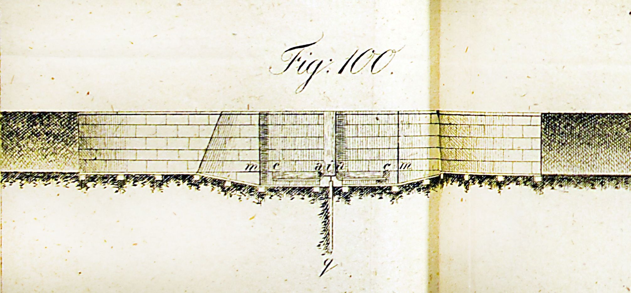

Pluto Posted March 26, 2023 Report Posted March 26, 2023 There were several other types of safety gate which were expected to close automatically if there was a breach. On the L&LC, they were similar to lock gates, but without a balance beam. Brindley, and some other canal engineers, tried ones that folded up from the bottom. This drawing is from Maillard's book on canal engineering, with an example at Red House Bridge, on the southern section of the Lancaster.
