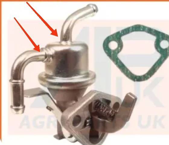

The lift pump is very tinny on these and can get cracked where the pipe goes onto the pump body. It is one piece of aluminium including the pipes.
It might not be this one but could be if it is a Beta BV,1505
If one of them is cracked then its a new lift pump needed.

The prime pump is a small green cylinder type with a side lever. The water trap is well sealed and when I undo the bleed screw on it, it oozes out fuel straight away and there is never no air. The issue seems to be between the water seperator and the fuel filter. The fuel tank has not been cleaned out since Ive had the boat which is 4 years but fuel seems to have a very good flow and I have tested it and is clean fuel coming through.
It looks very much like the lift pump that I have. The lever on it is very flimsy.

I had to replace on of these on a 1995 Beta Marine BV1505 (35hp) when the top outlet pipe cracked and it started admitting air.

A photo with a slightly wider angle view please. Need to see both connection.
