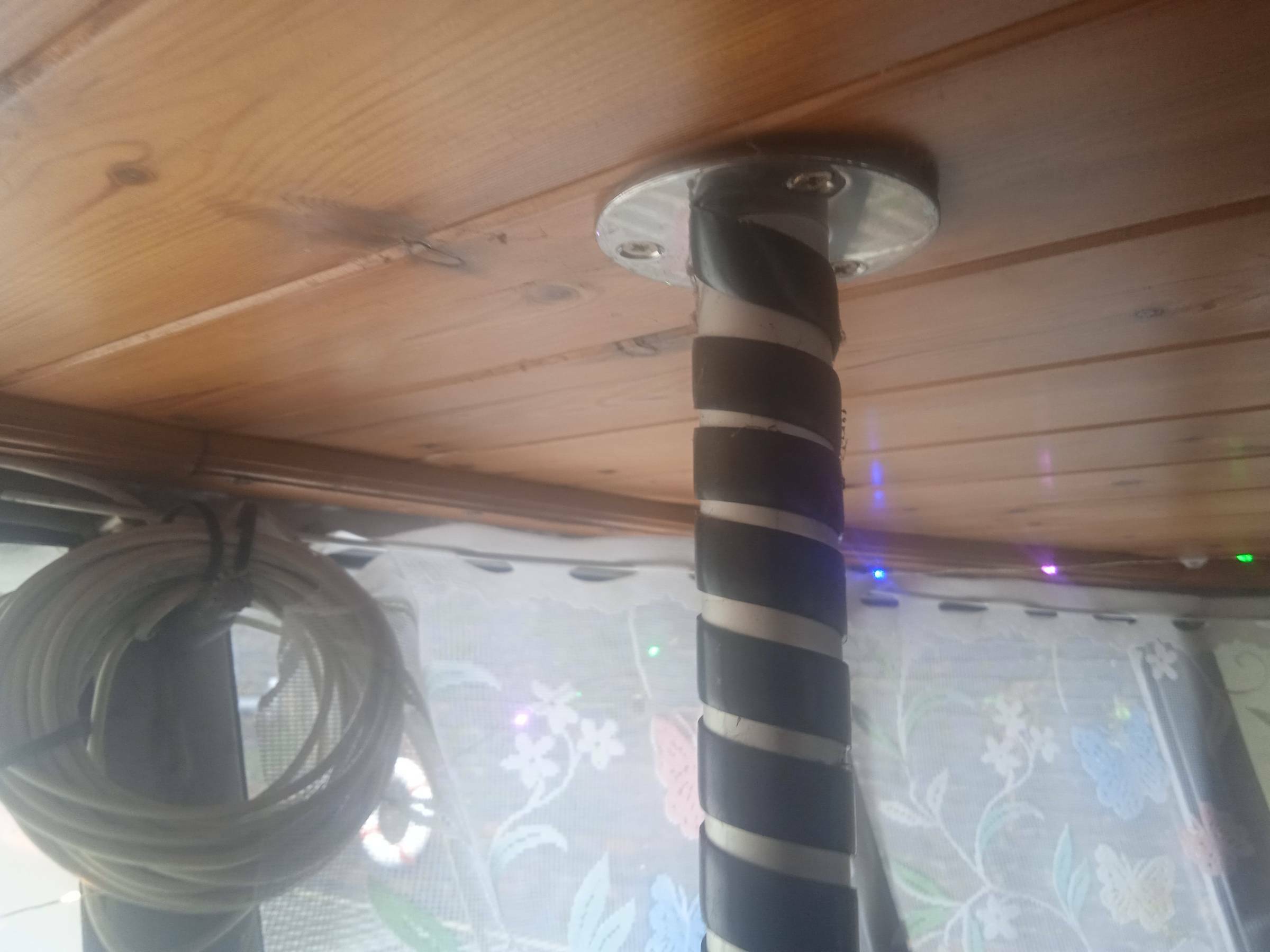

That plastic cable wrap stuff could be a fun toy. I used it to make the aluminium pipe conveying the solar panel wires look better.
If you get the right size it will cling onto a round bar or tube nicely and you can pull one end it will stretch quite symmetrically.

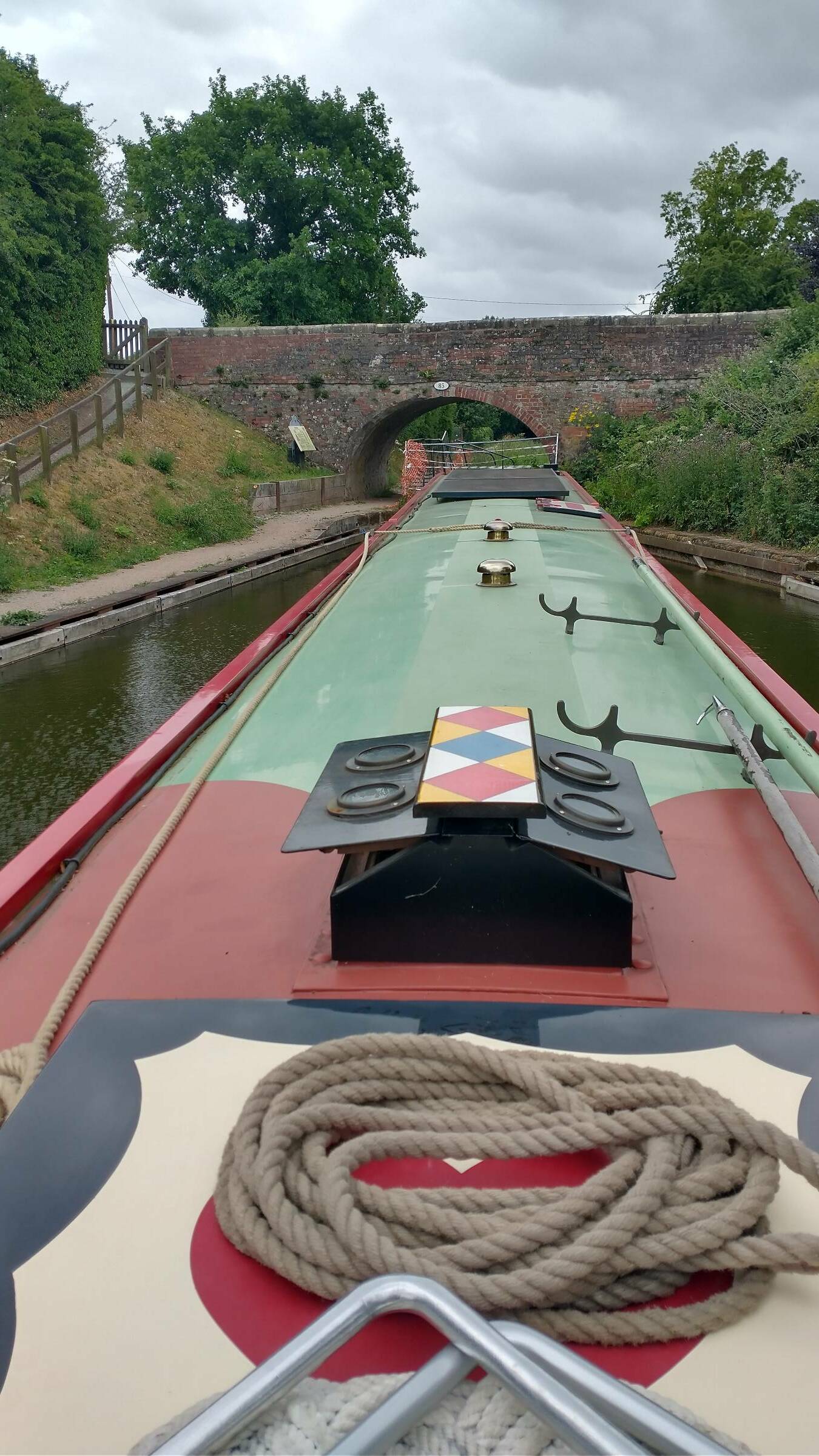

While we are on the painting subject. Wife wants diamonds painted on our main hatch. Are you able to advise how we go about that, also using four colours.  Sorry to be a pain. Thank David.
Again, whole area in lightest colour. Set out diamonds using straight edge and pencil. Generally, diamonds look best if the length is twice the width but the space available may force different proportions. Assuming  a cream or white base, I’d tape up the next lightest colour ( yellow?) and paint them in. Tape up next colour ( lining tape again) and paint in. Repeat for darkest colour.
I painted the diamonds on the board in the photo below by painting the board black, then taped up the diamonds using 3mm artist tape and painted in all the diamonds.  I then removed the tape to leave a clean black line between the diamonds which was the effect I was after.  Then a couple of coats of clear varnish to protect it.
And diamonds look much better if after painting the diamonds you go over all the joins with a narrow black line. But that involves more taping (in 2 stages) or good freehand brushwork. That said, if you are going to stripe the joins you could probably freehand the diamonds without taping up.
