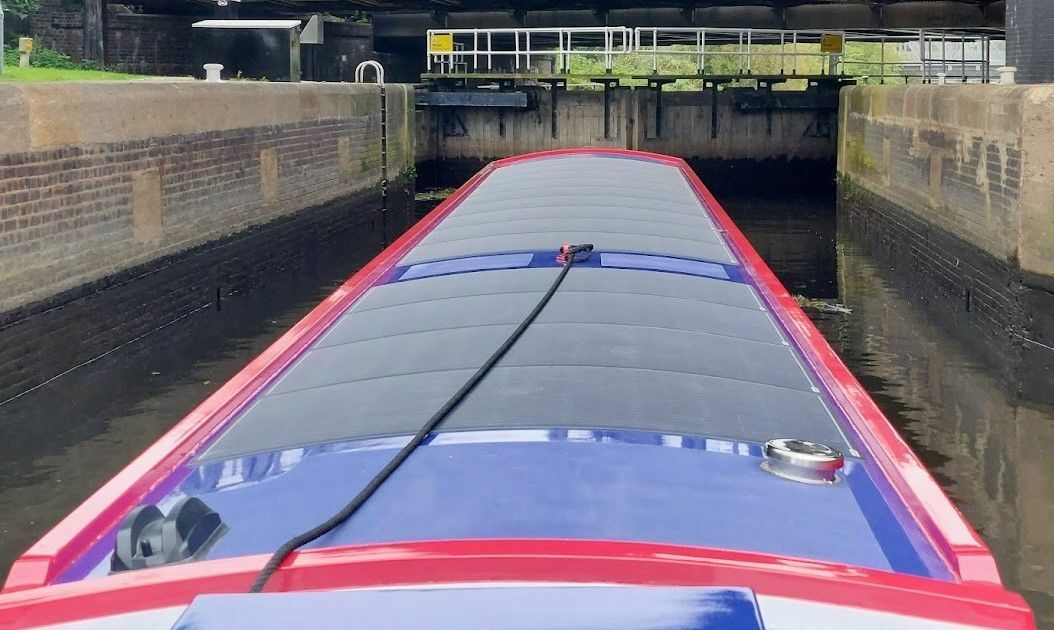

IanD Posted February 5, 2024 Report Posted February 5, 2024 10 minutes ago, Tonka said: Do they make an aerial that will not spoil the lines of a traditional narrowboat ? See bottom left in the photo. Not a traditional boat obviously, but pretty unobtrusive... 😉
Martyn Hicks Posted February 5, 2024 Author Report Posted February 5, 2024 (edited) There are Antennas that can fit flush to the roof but you need a 25mm hole and you just can’t be doing that and trying to flush cables behind the panelling, and removing the roof panel is probably even a worse option, in a motorhome that’s no issue as there are cupboards where the antenna can be positioned. So to use this antenna on a boat I’m using a raiser bracket and bring the cables in via a waterproof socket box on the front bulk head. the antenna and the raiser bracket are about the same size and height as a normal mushroom vent. Edited February 5, 2024 by Martyn Hicks
