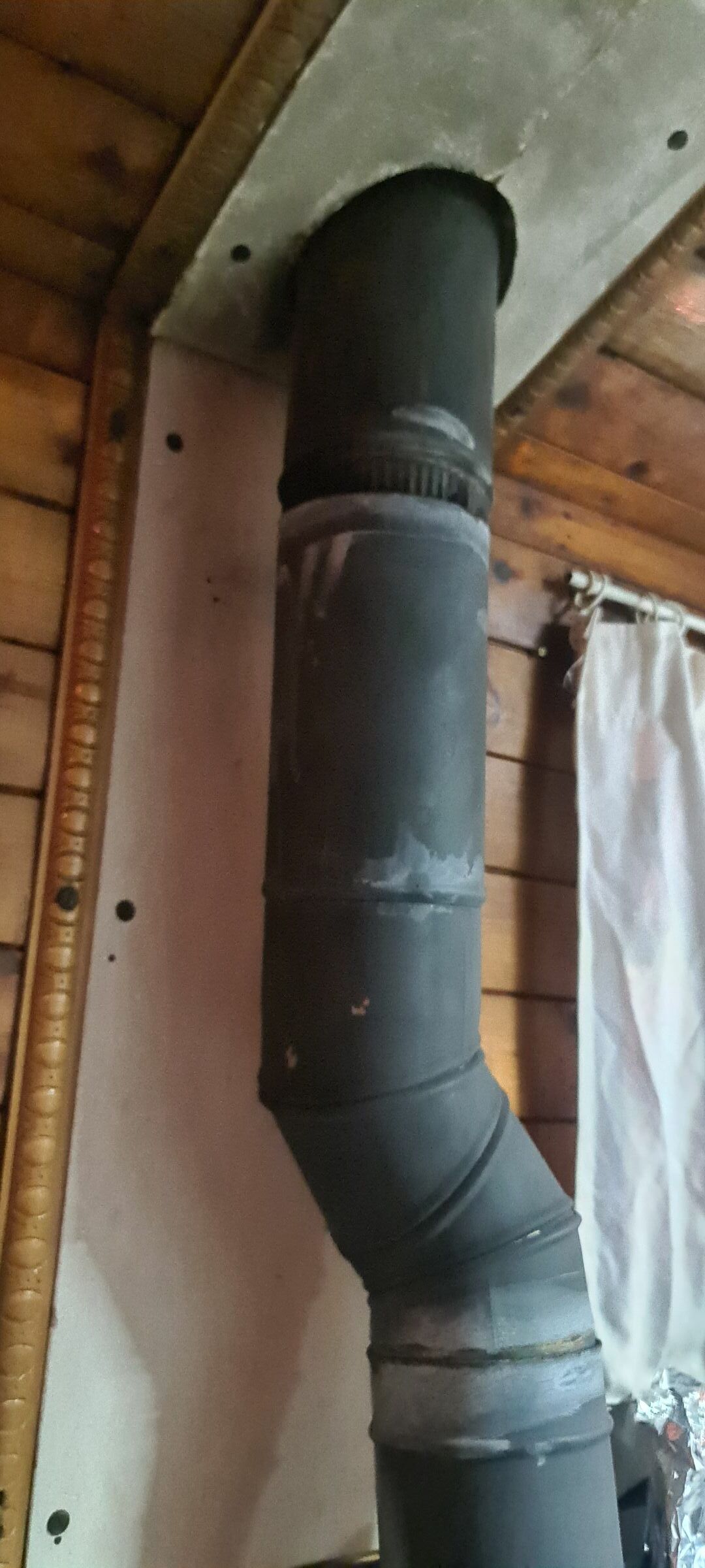

Excuse the ash on the floor, but this is it currently. A log has just turned into embers after burning for around an hour, and coal below it. Ashtray is virtually empty. I dont think there is much ash I can poke through the grate at the moment.
See also the temperature on my fans, and my flue (which really might be the cause as it doesnt seem perfectly sealed, and rain falls through as well)17014706883892006366489350131290.thumb.jpg.217fe00f6ee67c5044cfa611d9ba6366.jpg17014706883892006366489350131290.thumb.jpg.217fe00f6ee67c5044cfa611d9ba6366.jpg17014708862501962262854275029897.thumb.jpg.9bddb50e65843cf75d581532d700ea6f.jpg17014709150428733338151496523132.thumb.jpg.f8bb0b2482a638fd965f1f59db8198b9.jpg

Flues are also a critical component. If the flue is unwilling to heat up properly then the fire is unlikely to get going well.
Excessively long external flue terminals can cause issues in this regard.
I believe the flue extends about a forearms length above the boat, would that bee too long? It doesnt stand out from any of the other boats here
Flue is bad.

Needs to be straight. Have you got a CO alarm with a digital readout?
If not then please get one.
