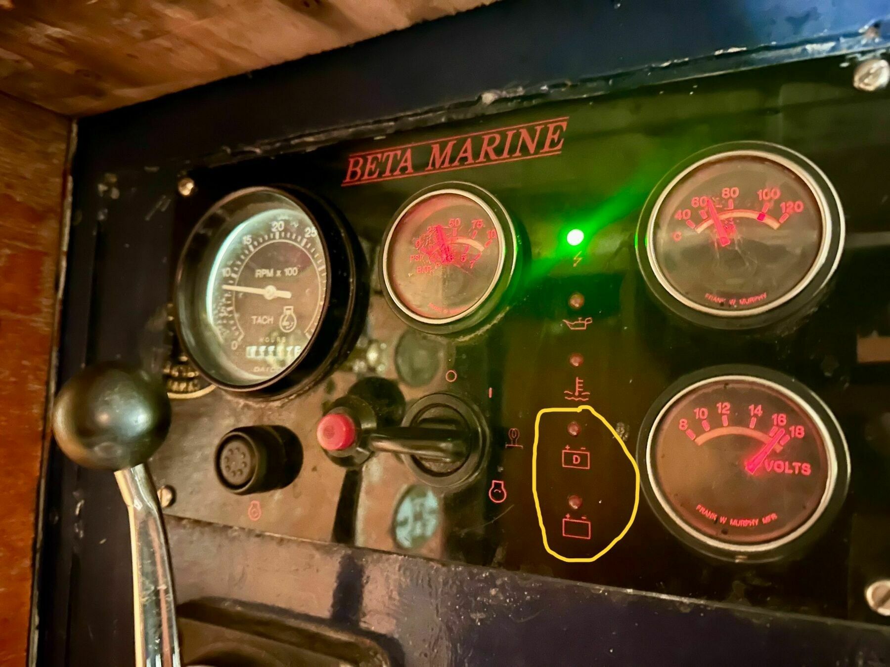

On a beta panel, the green light is just an ignition on light. It's on all the time the key is in the on position.
The lights I've circled below are the charge lights....they should be red. Check they come on when the ignition is turned on and go out when the engine is running.

When you turn the engine ignition on , is the light green before you start it? Normally this would then go out after starting which indicates the alternator is working correctly.

... woops! Yes this green light is on when the engine is running.
The two you've circled do light up when ignition is turned on, and turn off when the engine is running.
That's good. Indicates the alternators are working......as well as the voltmeter on the panel indicating 17 volts. On the face of it that's very high, but you'd need to confirm the voltage at the batteries with a multimeter as that panel voltmeter can't be trusted.

3 minutes ago, booke23 said:
That's good. Indicates the alternators are working......as well as the voltmeter on the panel indicating 17 volts. On the face of it that is a tad high, but you'd need to confirm the voltage at the batteries with a multimeter as that panel voltmeter can't be trusted.
If that 17V is true there is something wrong, and at that charging voltage the batteries may be ruined.
17 Volts on the voltmeter is somewhere in the territory of "Houston we have a big problem!
Edit to add - you are the second poster this week who has 17 volts showing when charging.
Edited by Alan de Enfield
22 minutes ago, newbienarrowboatowner said:
When the volt meter is switched to 'domestic' and the engine is running, the number is now around 14V.
i'm assuming thats the start battery voltage - would be interesting to know what the other voltmeter shows when switched to 'engine battery'.  really needs a proper multimeter/voltmeter on the battery to be sure. but as there doesn't seem to be a problem starting, getting some heating is probably the more urgent issue
I can't see a change over switch for the voltmeter, so do you mean alter the wiring to show domestic battery voltage. However, I agree, we need to know the off and on charge voltages for both banks to tell very much.
There seems to be a changeover switch for the voltmeter on the domestic switch panel, which whilst not ideal would give another indication.
Agreed, now I have found the photo that sows it. So they have two voltmeters, that allows the one on the domestic panel to be used to be compared with the one on the engine panel AND decide which bank the one on the engine instrument panel is measuring. That is a good first learning step.
