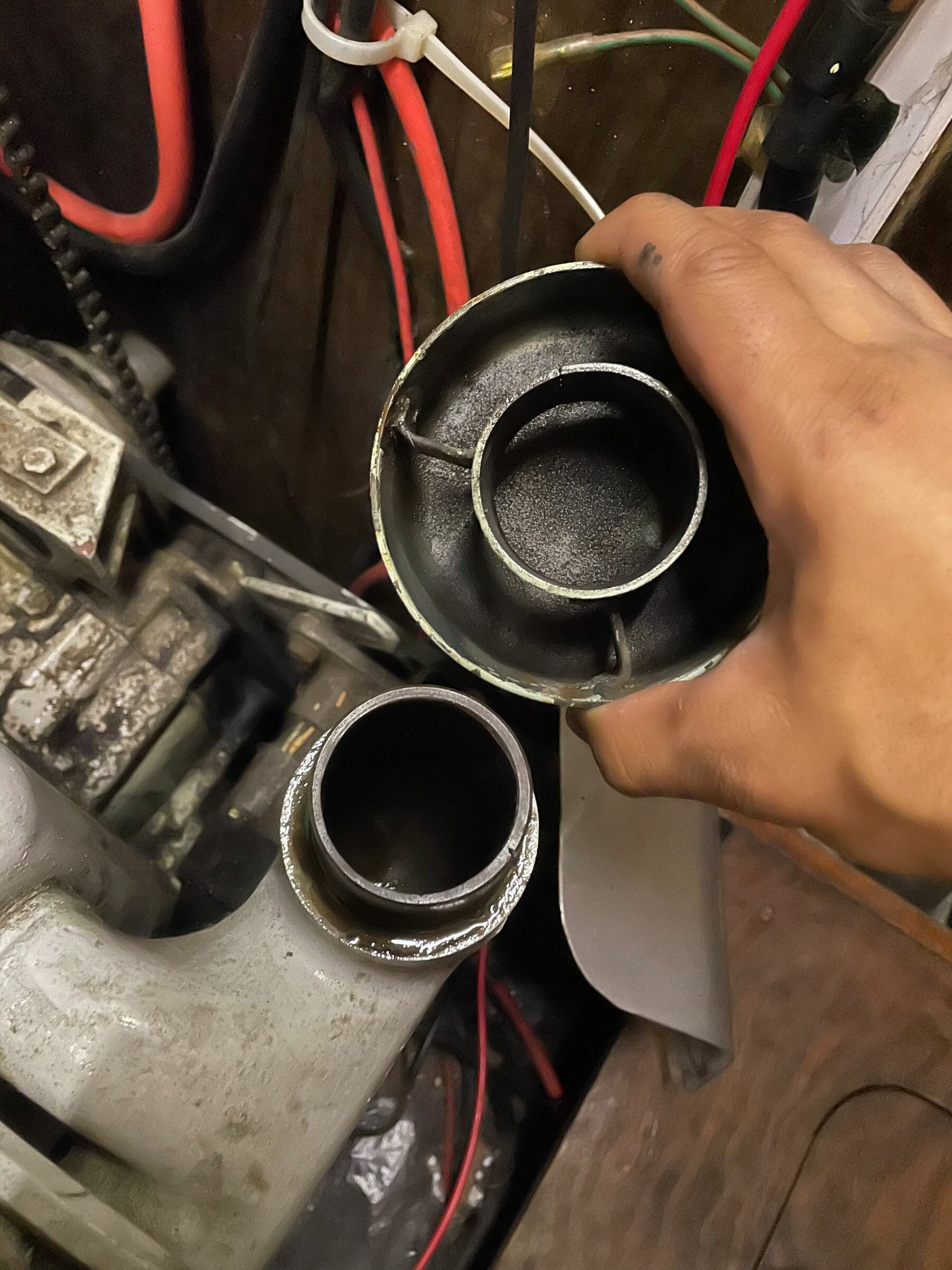

Hi,
Firstly, I am aware this makes me a fool!
I am new to boating and felt like I needed to top up the oil - our boat has a Diesel Lister SR3 Engine and it has a large cap (which said Oil on it though this was a sticker from previous owner) however, it has come to light that this was an open cap and for air. As such, the engine will not start now. I have sucked out as much oil as I can and I am still cleaning it.
My hope, is that none actually got anywhere else but the pipe as it the ingress to the engine is raised and I only put about a quarter of a litre in.
Any advice is greatly appreciated!

Just to be sure, what Tracy said - photo please.

Yep, you poured it into the engine air inlet manifold. It will have run into at least one cylinder depending which valves were open at the time.
Now you say it won't start so you have tried to turn it over on the starter, Hopefully it did turn over or did it refuse to turn over at all?
If the later, pray that it has not bent a connecting rod.  If it does spin over you are lucky.
If it is locked up try turning it backwards by hand until it will turn easily.  If it will not turn you will have to remove the injectors which are under the rocker covers to let it out. Spin it on the starter until no more oil spits out. Then put the injectors back in and it should start up very smoky.
Yes, that's the inlet manifold .. it may have had a mesh air filter that is sprayed with oil to trap dust etc.
Definitely not where you want to pour oil.
What Tony said - loosen the injectors and turn the engine over to clear the cylinders. At least it will pour into the sump, and you have hand start to turn it over easily.

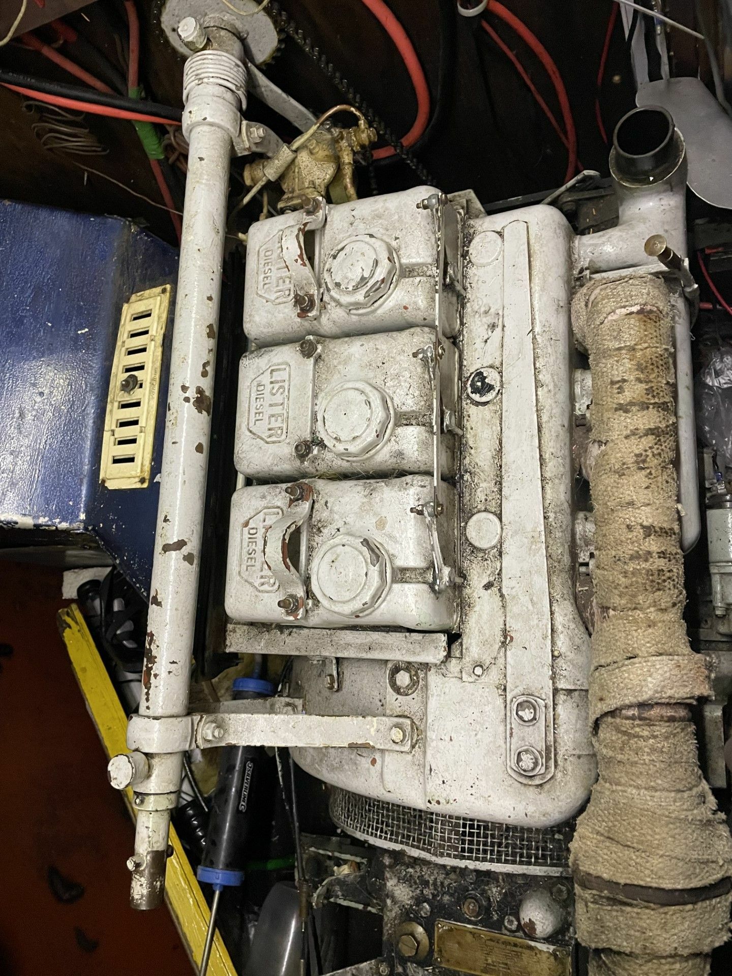

The engine in the picture has three decompressor levers joined together.
This is all brilliant guys thank you so much! Much of this does makes sense I am going to attempt this in the morning and update! Thanks again I really appreciate your comments! I love learning this stuff let's hope the mistake isn't too costly!
