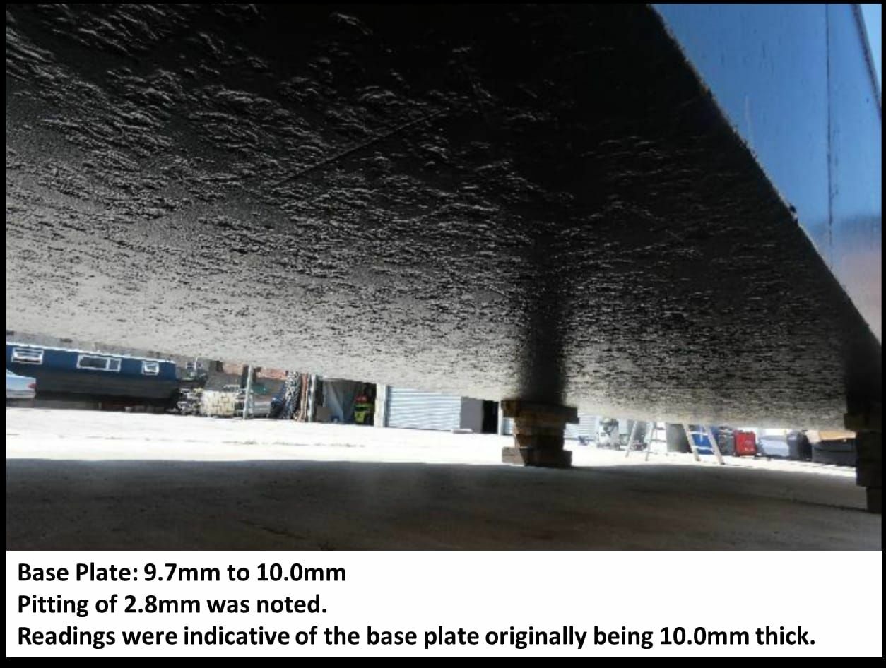

We've lived on a narrowboat for 4 years now and just in the midst of purchasing a 57x10ft widebeam, constructed in 2008. We had a survey done, and was surprised to find some pitting of 2.8mm on the baseplate. The hull thickness measurements were:
Base plate: 9.7mm to 10.mm
Side plates: 5.6mm to 6mm with pitting of 1.0mm
Uxter Plates: 9.7mm to 9.9mm
The boat was previously shot blasted 3 years ago, and blacked earlier this year, so the surveyor made it clear that due to the shot blasting it wasn't a pretty sight, but was a very honest baseplate. He said if all boats were shot blasted prior to surveying they'd likely find the same kind of pitting. He also said as long as we look after her, take her out of the water every few years and check and touch-up any blacking, she should be fine for another 10 years with no further damage.
Does anyone have any advice on whether or not this is sound? I'm concerned that when it comes to selling her on ourselves in say 5 years time, the next purchaser will be as worried as I am! Or am I just worrying too much?
Photo below!
My guess is that the baseplate has never been painted until now, so pitting can be expected.
Has the bottom now been blacked, and if so what with? 2 pack epoxy over shot blasting should stop any further corrosion on the existing pits, and elsewhere (except where the coating gets damaged due to contact with the canal bottom or rubbish). But if it has just been bitumened, then you will have less protection.

Agree with above. If shotblasted, apply epoxy if you go ahead with the sale.
The surveyor is right.  Shot blast will remove all the pre existing rust then the epoxy will prevent it recurring, except where it gets mechanical damage from locks, bridges, shopping trolleys etc.
The pic looks a bit like our baseplate, but wider.  We were blasted in 2010 and it has been pressure washed, wire brushed, rust at damage sorted and over coated with epoxy every 4 or 5 years since.  There is no recurrence of old rust.
You don't say what the boat was blacked with.  It should have been an epoxy.  If it was anything else (bitumen, fancy vinyl,) the effect is most likely to be cosmetic and  I would expect the epoxy to eventually fail gradually  after about 10 years.

I should've said yes the hull was shot blasted and both the hull and baseplate was blacked with 2pack epoxy 3 years ago. Then end of last year both hull and baseplate were blacked again with International intertuf.
There is no galvanic isolator so you could well be right on the corrosion. Should I get one fitted, even though we will be continuously cruising?
2.8mm sounds quite bad and we do hear reports of older boats with zero pitting, but I suspect they are fantasy. I also suspect that many if not most boats that are shotblasted would show that level of pitting. It is normal not to black the baseplate (thats why they are 10mm thick), most yards are not able to, but things are changing.
Do the baseplate in epoxy and that pitting will pretty much stop and the boat will last forever, just repair any scrapes every few years
Bear in mind the logic of the move to 10mm baseplates was to give an additional 4mm of sacrificial steel because baseplates aren't (or weren't) routinely protected.
If all you've got on the baseplate is ordinary standard bituminous blacking then probably all you can sensibly do is to keep it in good order now. Personally I wouldn't shot blast a hull and then not put a more state of the art protective system on it.
You only need a galvanic isolator if you are connected to shore supply. You do need suitable anodes though but it's unlikely a yard will black a boat without at least consulting on that subject.
Corrosion is a product of environment and lack of protection. Moving about is good in respect of the former and you have the basics of the latter under control.
Also note there is effectively no general corrosion of your plates. Those numbers are well within the manufacturing tolerance of the orginal plates, which I can guarantee were not actually 10.0mm thick.

That's a shame. Would be better if epoxy had been used again. You can put blacking over epoxy, but not the other way round. So you are now into a 3 yearly cycle of bitumen blacking, or you will have to blast the bitumen (and most of the epoxy) off in order to epoxy again.

I assume the epoxy underneath will still give it extra protection?
Yes, it'll still be fully effective and the ordinary blacking on top should give it some protection against mechanical damage.

This doesn't make sense to me. If it started out with a 10mm baseplate and it's now got pitting 2.8mm deep then surely the baseplate thickness measurements are now 7.2mm - 10mm, not 9.7mm - 10mm?
Same with the sides. With 1mm pitting it's now 5mm - 6mm thick.
You have to include the depth of the pitting in minimum hull thickness measurements.

What is expressed is two different sets of measurements.
One is the overall plate thickness measured by use of an ultrasonic gauge at a series of pre-determined points on the side and hull, and the other is the directly measured depth of the visible localised pitting.

Thank you all for your help and comments. It seems as though as long as we look after it there should be no further corrosion so I think we will be going through with the purchase.
Edited by emma_naomi
That's essentially what your surveyor is saying which is more important than what we think. There is no risk free way to purchase a boat but that baseplate is far better protected than at least 95% of boats on the water, and as was also said quite likely no more pitted.
I'm not sure "no damage" is a wise statement, I'd be more inclined to say "tolerable wear and tear" as you may get some mechnical damage and surface rust but that will get sorted every time you bring it out the water for a re-coat. You'll probably find striations along the blacking next time it comes out of the water from where the boat has run across items on the bed of the canal. They may or may not go through to the steel. If you're river cruising it may be less prone to this.
I'm sure it should last many times longer than 10 years so I wonder if that's the lifespan the surveyor is putting on the current 2 pack epoxy.
