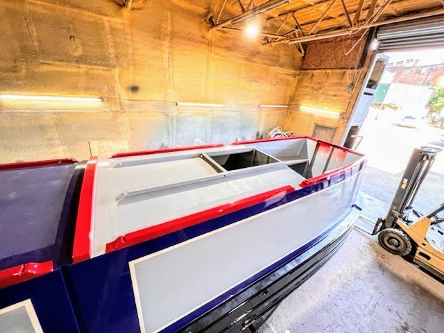

Decision 003. Get a sailaway from Colecraft. VERY GOOD.
I visited Colecraft and saw the 4 boats under construction in their large, proper industrial workplace, and arrived at the conclusion that they were churning hulls out at about one a week.  The people I saw were very genuine, knowledgeable, and easy to talk to. They appeared to be willing to create a hull respecting my wishes provided that I didn't ask for anything that they thought would create a bad boat, bad in the sense that it would function badly, not bad in the sense that it didn't conform to some yard style.  They were prepared to attempt to get me one by Dec31 and they succeeded, just.
Decision 004. Get a narrowboat hull.  GOOD.

Decision 005.  A wide tumblehome.  GOOD.
By tumblehome I mean the walkway down the side of the boat. In my totally ignorant (at that time) way, I asked for a very narrow walkway, and Colecraft strongly advised against it. I took their advice and I am so glad that I did.  Even with ice on the boat it was possible with extreme care to negotiate it.

Decision 013.  A Sizeable Well deck.  GOOD.
I chose to go for a largeish well deck, big enough to get four folding chairs in, easily, with sociability in mind.  A feature which I didn't give much thought to was the floor. It was not flat but gently curved so that any water drained nicely into the scuppers at the rear corners.  The curves were not so big as to bother any furniture.  I elected to have no brackets of any sort in this area as this would have committed me to particular usage eg where benches were, and I wanted complete flexibility.
At the bow was a conventional locker specially designed in most boats to make getting gas bottles in and out difficult.  Since I had provision for the bottles at the stern, I aimed to use this for general storage and I specified that it was to have no drain holes to the exterior as these would be unnecessary as gas drainage was not required.  This surprised Colecraft but they did it.  One problem with the locker that I discovered much later was that the fold-down lid, though very elegant, was in no way watertight.  It took great effort later to devise a way of keeping water out when usng leaky locks of which there are one or two on the canal system. Colecraft also asked if I wanted to have a cratch cover, I'm not sure why. I replied, no, there are ugly things.  They smiled and said "You will!".  I was adamant at the time but they were right.  The bow itself was a standard Colecraft bow, and I like its functional shape and the solidity of its design.  I do not like the style of bow that looks as if somebody has pinched it with a pair of pliers.  One other thing I specified was that the transom?? the edge bit of the bow locker was to be horizontal not bowed, which was a bit non-standard for Colecraft but they did it.
Decision 014. Accept The Standard Colecraft Hull.  GOOD
This is just an excuse to comment on the generous and excellent fully welded rubbing strakes, the epoxy blacking, the 2 coats of epoxy paint on the upper works etc.  Colecraft did not black the baseplate and did not think it was worth doing.  If I'd wanted it I'm sure they would done it at a price.  Every apsect of the hull looked strongly-built.

Decision 015. Hull Holes.  BAD.
As a newby to canal boats, my early decisions were tempered by a belief that cutting holes in the steel of the boat was difficult and only to be done by professionals.  Now of course I know that its easy-peasy.  So I thought I had to get Colecraft to put holes in for draining the sinks, shower etc in, and deciding where they were to go was difficult because I didn't have the experience to know where the interior fitting would end up.  Colecraft put them in where I asked and most of them ended up unused because they were in the wrong place.
Decision 016. Windows.  BAD. VERY, VERY, BAD.
This is a biggy.  I wanted lots of windows because I wanted to see out as I cruised.  Because I thought metal cutting difficult I got Colecraft to cut the holes for them.  I chose 9 windows, all 24" deep which is deeper than many, being 2 x 4ft sliders, 4 x 4ft hoppers, and 2 x 3ft hoppers and 1 x 18" with no opening for the bathroom.  But the big decision was whose windows to go with.  The cost was immense so changing later would be very expensive again.  And Colecraft needed to know in order to know what shape holes to cut.  I plumped for Channelglaze screw-in because the boat next to me in the Colecraft yard was using them.  Going for screw-in was a huge mistake. This called for hundreds of holes to be drilled and tapped in freezing February weather which was so exhausting.  I only broke two taps!  Another time I would buy Wesley Marine (?) clip-in windows and have all of them in in one weekend.
And the number of windows was a big mistake.  Extra windows can easily be cut later.  Next time I'll have no windows cut initially.
The window holes were made by hand, not by a CNC type operation.  This meant that they were not exact, and it was necessary to line up the windows when fitting them to find where to drill the holes.  Finding a horizontal in this situation when fitting heavy windows single-handed from a stepladder was very hard. But they didn't look wrong when I had finished.  In the long run the position of the windows was satisfactory.  But more on that later.
