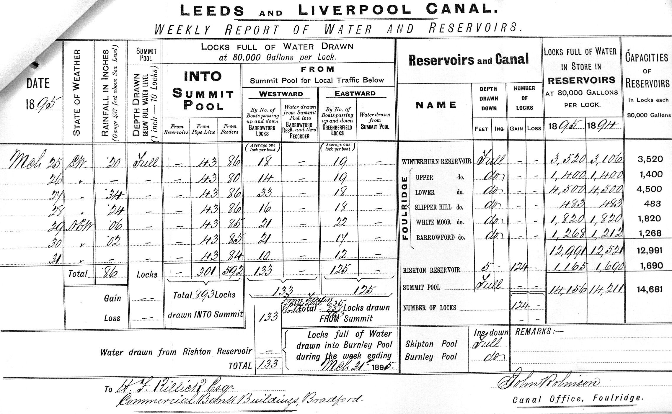

Any good canal engineer would prefer to have a water supply from reservoirs. However, the canal could have a poor or difficult catchment area, such as the Birmingham, where the canal was peobably above the most productive level for water to be stored in reservoirs if it was going to serve established local industry. Canals planned in the 1760s and 1770s did not have too much difficulty in arranging water supplies, but by the 1790s there were numerous water mills whose owners already had a claim on local water supplies. Canal Acts passed at this  time can be filled wit clauses protecting water, and this was certainly the case wit the Rochdale. The summit level reservoirs allowed under the Act were always too small to supply the canal effectively, and the pumped water from Hollingworth was vital to the canal's operation. Other canals at this time were built through geology which was not water-retaining, such as the K&A, and for these canals pumping was required. In rainy periods, quite significant volumes could come from small streams feeding into the canal, as this weekly L&L report shows.

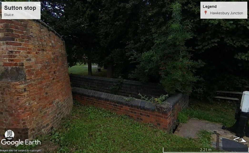

To what extent did it also get a supply off the Oxford - ISTR there is a sluice that facilitates this?
Yes, there is a sluice by the footbridge at the end of the stop lock between the Oxford and Coventry Canals. When he was lock keeper at Sutton's one of Mike's jobs was to operate this sluice as and when necessary.

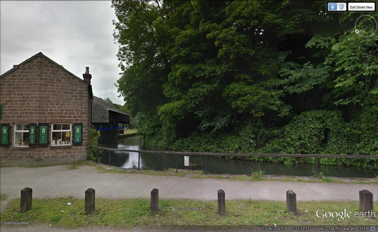

The summit of the Sheffield an Tinsley Canal. Water pumped up from the River Don. The cast iron pipe from around 1912 was replaced this year by a new plastic on running under the foot path along the Tinsley flight from near the M1 Tinsley Viaduct to the top lock to feed the three miles of canal to the basin.
My understanding is that the canal, as built was fed by a culvert from the river Sheaf, but that was lost when the Sheaf was covered over by the Sheffield Midland railway station in the 1840's (I've followed the underground course of the Sheaf, to its junction with the river Don). After that, alternative supply was needed. Would love to know the actual story, as this may be wrong.
