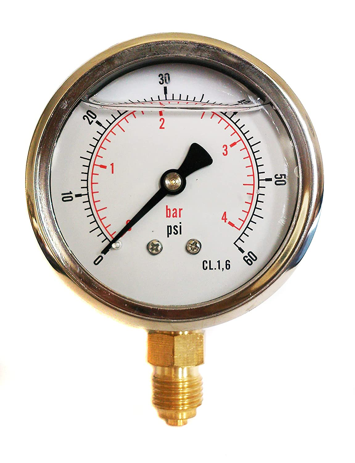

What size gauge do you want and what range, 120 psi may be too high?
Tere are some on Amazon, 100mm dial, stainless case 0/60 psi?
Am I being dense,  but why is it apparently nearly filled by some fluid?
At 100mm dial, that's surely too big to attach to a typical pigeon box.  My ones both simply pass through a hole in the engine room roof, which I suggest is the more normal arrangement.
I've seen some neglected rooftop gauges which are part full of rainwater and slowly rusting away inside...
Damping?
Glycerine filled gauges are common. the liquid damps the mechanism, reducing wear and providing a stable riding if the pressure is fluctuating.  Regarding the size, it depends on what the OP wants to do (I am not a mind reader). A very small gauge  (say 40mm) fitted to the top of the pigeon box is ok but hard to read due to size at the expected distance form the steering position. If a gauge is fitted to the roof adjacent to the end of the pigeon box rather than on top of the box then it can be bigger (and easier to read). The gauge is showed was an example for he OP to consider, that's all.
Fair enough, but looks odd to my eye.
If it's intentional wouldn't it look better if full, rather than part full
The gauges are not filled completely as they would then be subject to internal pressure changes caused by the fluid changing volume when the ambient temperature changes. This would them change the reading of the gauge. In the extreme this fluid expansion could cause the case to fail.
