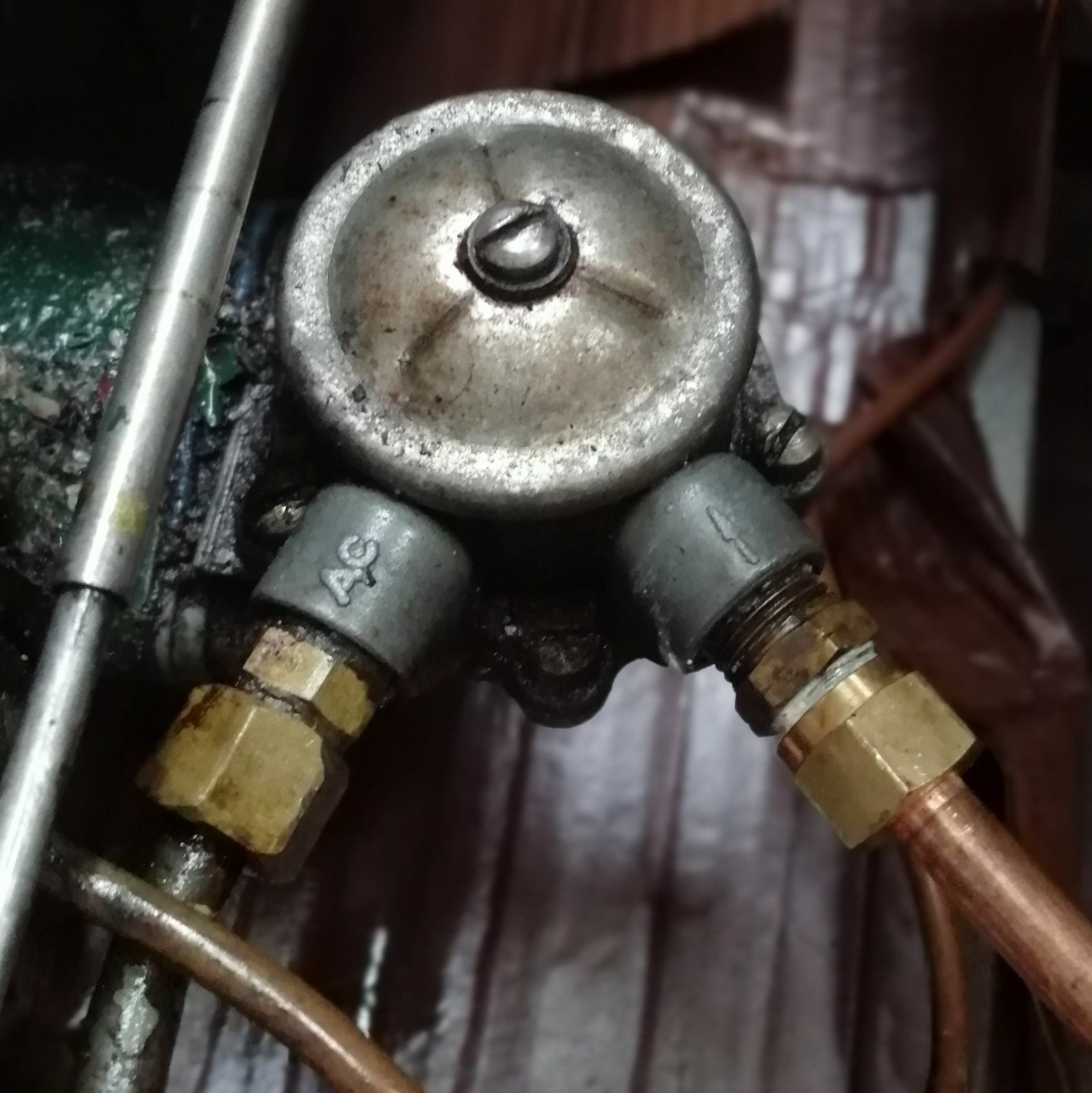

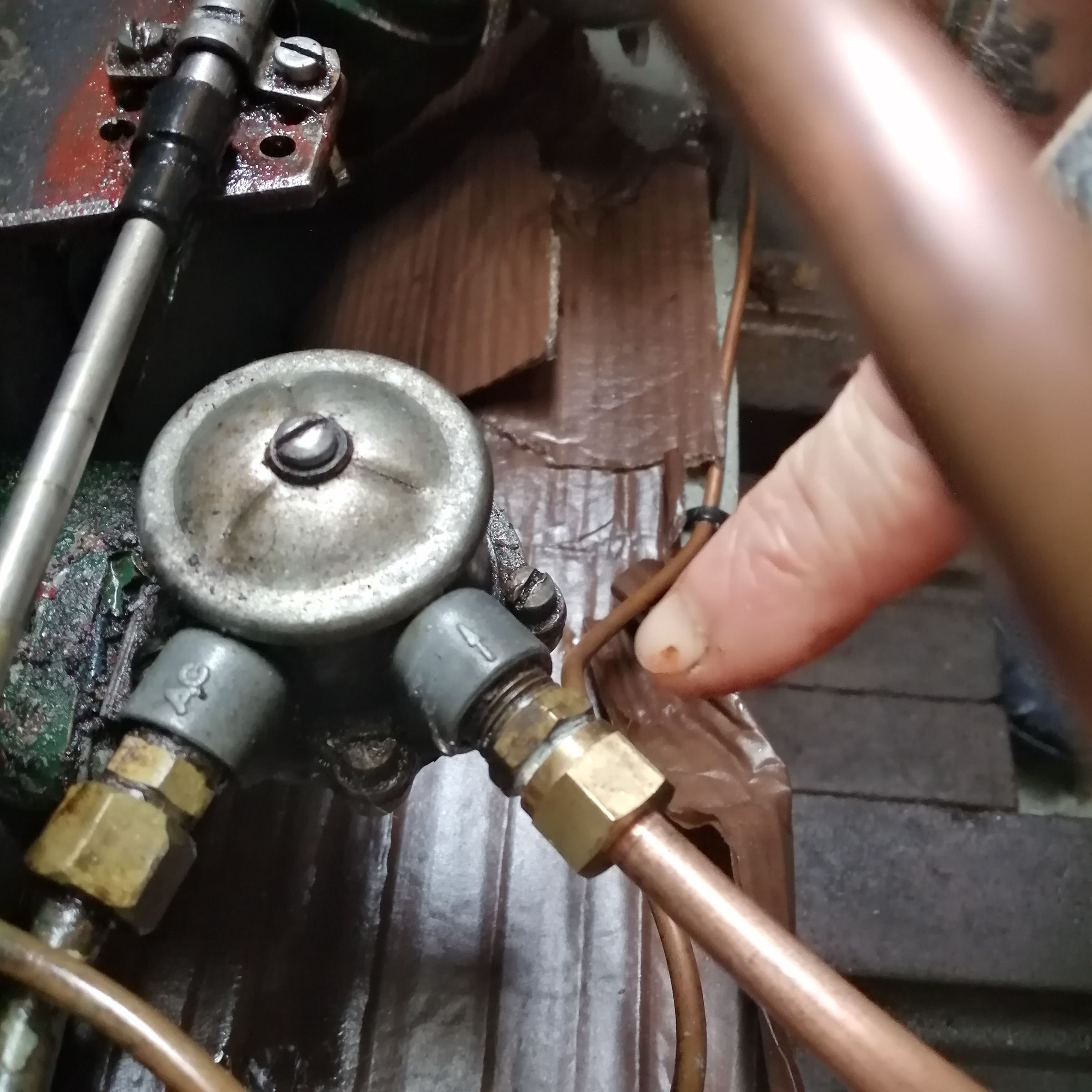

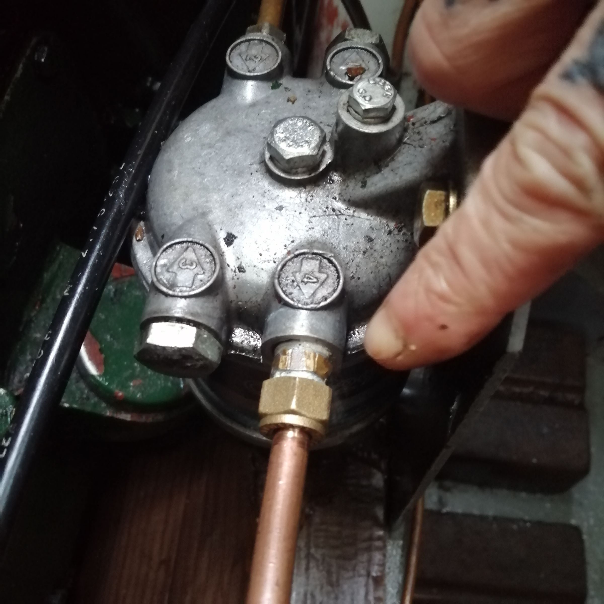

Hoping someone might be able to shed some light on a fuel leak we have.
When we bought the boat, we didn't have any leaks at all. Then the mechanic came and replaced the diesel filter and the leaks began. It started with a leak from the filter to the pump, then he changed the brittle rubber hose that was connecting the filter to the pump with a copper pipe, and a new leak appeared from the pipe to the pump. Now there's three leaks, both the entry and exit points from the pump and the exit point from the filter. We had to leave the area where we were so the mechanic never came back to sort it out.
We've tried tightening the nuts a bit but it hasn't helped. Does anyone have any ideas please? When we cruise, diesel spurts out all over the wall and it's leaking into the sump constantly. Someone has mentioned olives, could it be to do with them?
IF he tried to tight the adapter into the filter head or the lift pump body then they look tapered so he may have split the aluminum bosses.
If the lift pump can be fed by gravity then make sure the rubber seal under the lift pump cap and the soft washer around the center bolt is not leaking.
I think all the pipes are sealed to the adapter by olive and the one on the filter head and one of the lift pump ones look as if the olives may have been crushed. I don't understand why a proper olive seal needs PTFE tape. It looks like a bit of bodging has been going on. It might be a good idea to inspect the olives.
I agree overtightening is likely to damage a casting or strip a thread.  Especially as that is the area where work was recently attempted.
However, I'm also puzzled how diesel is finding its way into the sump!?  That would suggest another issue where the feedline attaches to the rail that feeds the injector pumps.  This would be a major issue as diesel diluting the lubrication oil is to be avoided at all costs.
If the threads in the pump or filter are only damaged a suitable plug tap will clean them up.  They may  be 1/2 x20 tpi UNF, BUT  CHECK, against the thread on the fittings.  Seal the fitting in with Tru Blu from toolstation, or Heldite, which looks like it has already been used.  Tracy Tools are good suppliers for taps.
If the pump or filter is cracked, then the body at least will need to be replaced.
I would try to source three new fittings with new brass olives.  If the pipe has been crushed where the olives fit then you will also need to start again with an un-crushed pipe.

One other observation - your lift pump has AC visible on it, which I suspect means it was made by AC Delco. Your fuel filter unit looks like it might be a CAV one (check the code on the filter element if you can't find one on the unit itself as that will pull up the unit type the other way around as the filter description will include which units it fits). If they are damaged beyond repair then this should give you a starting point in finding replacements.

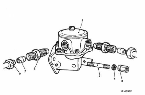

Here's a diagram of what would of of originally been fitted. As you can see the fitting had a male cone on it, which would form a seal in the pump. All pipework would originally have been 5/16" which is still readily available. If you need any of these fittings or any other parts then it may be worth talking to Marine Engine Services (Midlands) who I'm sure can give good advice.
and I think the fitting that should go into the filter head was "different" as well. I recall it used a plain pipe and a sleeve nut with a taper at the end that clamped down onto the pipe to seal when tightened. I am not sure some filter heads did not come with an AF thread, but can't be sure.
Many filter heads were 1/2" UNC threads. Not interchangeable.
