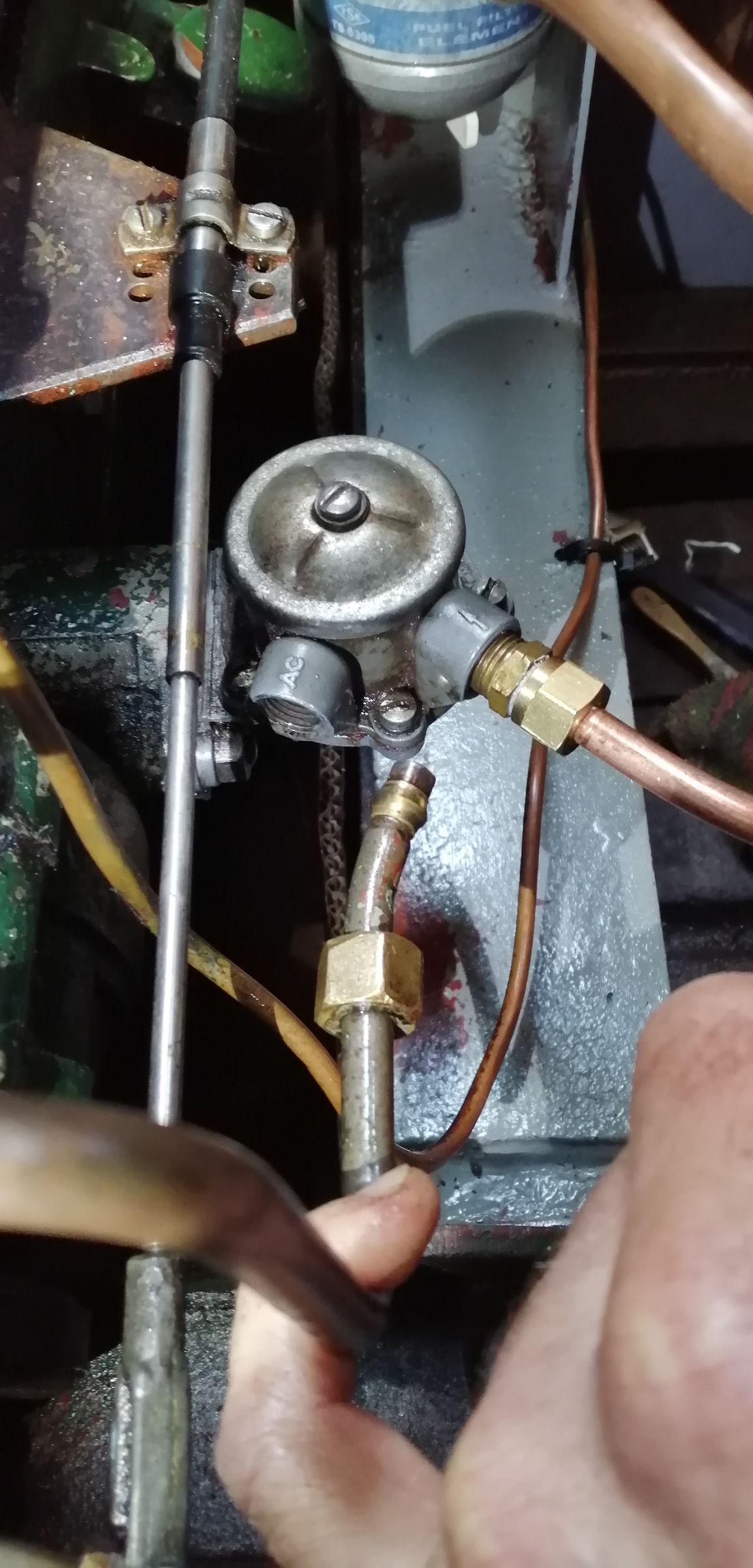

Fantastic instructions! Thank you. I feel much more confident in having a go myself. The diagram is very helpful too. Thank you. I've been having a look today and pulled it apart a bit to get a good look. As far as I can tell, there is no cracking on the housing units of either the pump or filter. The olives on the two new parts do not seem crushed or the pipe crushed either. Before buying new parts, I have borrowed some sealant as has been mentioned and done everything up again just to see if that helps before I go further. The drips seem to have stopped when I last checked... but I'll check again in the morning. What I did find on the third leak from the pump was interesting. This part was not replaced and appears to be the original fitting as I'm comparing it to the handy diagram posted above. However, I believe the olive and the pipe have been crushed and I suspect this might have been done when the mechanic couldn't stop the leaks and so overtightened all the fittings as it wasn't leaking before he worked in that area. So I think I'll definitely need to replace the pipe, which is 8mm, and the olive here. I watched the drip in this area and it definitely seems to be coming from under the nut where the crushed pipe is. I'm attaching the photo just in case what I think I'm seeing is not what I'm seeing!!

Thanks for all the input. Sounds like I could try a few things out. Funny you mention this, the mechanic did say something about this and didn't have the right spanners for the job as a result. The whole engine seems to have been a bit of a bodge job here an there. The mechanic found a tin can being used between the exhaust pipe and silencer, and a hessian bag as lagging for the exhaust pipe. So I'm sure there's still lots of fun things to discover...

Ah my apologies. I meant the drip area under the engine! If the thread or casting has been damaged on either the pump or filter, I'm guessing that I'd have to replace them?

Hoping someone might be able to shed some light on a fuel leak we have. When we bought the boat, we didn't have any leaks at all. Then the mechanic came and replaced the diesel filter and the leaks began. It started with a leak from the filter to the pump, then he changed the brittle rubber hose that was connecting the filter to the pump with a copper pipe, and a new leak appeared from the pipe to the pump. Now there's three leaks, both the entry and exit points from the pump and the exit point from the filter. We had to leave the area where we were so the mechanic never came back to sort it out. We've tried tightening the nuts a bit but it hasn't helped. Does anyone have any ideas please? When we cruise, diesel spurts out all over the wall and it's leaking into the sump constantly. Someone has mentioned olives, could it be to do with them?
