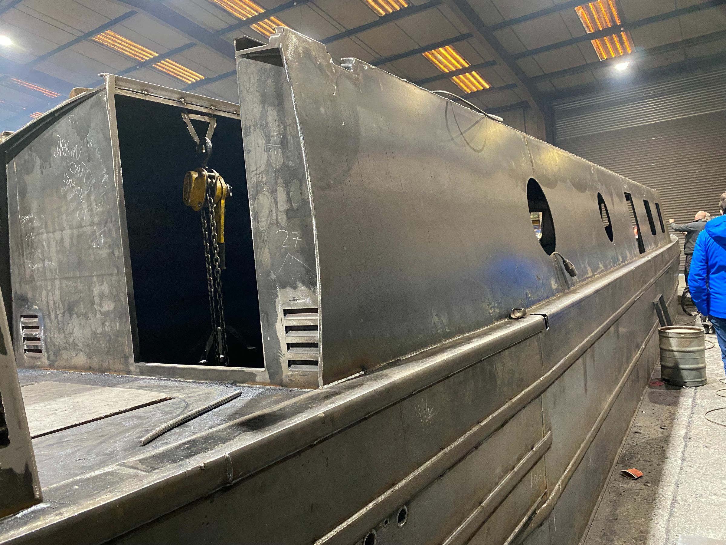

It looks as though it will be a bonny and practical boat. 50/52' ish is perfectly spacious for a couple if they're not living on it with all their worldy goods. Portholes in bedroom and corridor, hatch opposite galley and two large windows in the saloon, I think will work well to live with. Obviously your previous experience of boats has informed you well regards what you need and want in one so I'm sure you'll enjoy the latest inland chapter of your boat owning life. Getting your first choice of mooring sorted sounds a good result too.
It's an immensely exciting time, seeing the boat a bit more complete each time you visit, isn't it? We've been through the process twice and yes, waiting is frustrating, but it will come to an end - in your case, sooner than you had envisaged.

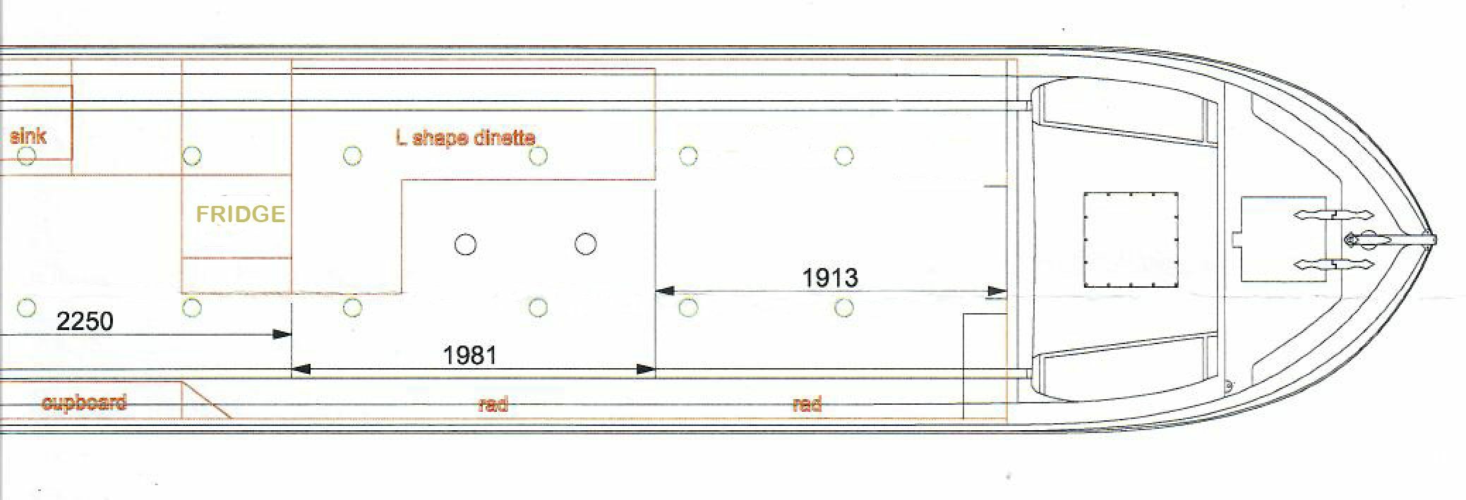

We have agreed the galley layout and Daydream Believer is due to be spray foamed today and should be lined-out before Christmas. Still undecided what to do with the remaining area of the saloon once the L shaped dinette is installed. They are going to tape the outlines on the floor for us, so we can try and visualize the space. We are hoping to get a couple of armchairs or a small sofa in, but its going to be cosy! We can't wait for our next visit which will be early in the New Year to meet with the chippies, painter and upholsterer

No stove??
Stove was on the original drawing, but we have deleted it for now, as there is no availability this side of Easter and we thought the cost quoted was excessive (see my other thread), so we may well get one installed next summer.

I can’t find your other thread (not the one about cleaning products, presumably). But I just wanted to say that a stove is pretty essential if you want to use you boat outside the summer season. This was bought home to me last week when our stove was out of action for a (pretty cold) 24 hour period. Yes we had the Mikuni diesel heater /radiators on so it wasn’t cold, but the condensation on the windows was really bad. Stoves are great for keeping everything dry, as well as warm. I would strongly recommend that you make provision for a stove at build (hearth, flue collar through the roof) even if an actual stove is hard to come by right now (although that seems strange). You can temporarily cap the flue collar to make it weatherproof. Completely retrofitting a stove into a finished boat will be a lot harder and costlier.

As to the space, a couple of chairs is probably the best bet. Some people like “captain’s chairs” - those swivel leather things, but personally I think they are a bit OTT both in cost and look. We had IKEA Poang chairs for a while but recently replaced one with an offering from Dunelm Mill, which is really comfortable and not too big…

We thought £4K was a bit OTT tbh! My brother in law is a boatbuilder and very skilled woodworker and can build us a hearth and we are getting a quote from a local professional installer for the stove install next year. On the condensation issue. With the Channel Glaze double glazed, thermal break windows we have been promised (unsolicited) there will be no condensation so we will see. If we can decide where the stove will go, we can get the builder to make the hole in the roof during the build.

Many people (including us) put the stove at the front and I suspect that may be where yours ends up, but if possible it is better more towards the middle of the boat, so that the heat is distributed more evenly. You also want to have it on the left side of the boat if possible, because since one drives on the right and since overhanging vegetation can be an issue, having the stove on the RHS makes the chimney prone to being damaged / knocked off.

We are probably going to go for IKEA Poang chairs as we have a couple in our beach hut and find them very comfortable, but we have also been looking at the narrowboat range at the Sofabed Barn, after seeing them on the "Floating Our Boat" YouTube channel.

Yes they were going to put at the front on the LHS

My boat came with Two Captain's chairs. They were comfortable but heavy and took up an inordinate amount of space.
I eventually replaced them with a three seater sofabed from.Sofabed Barn.
