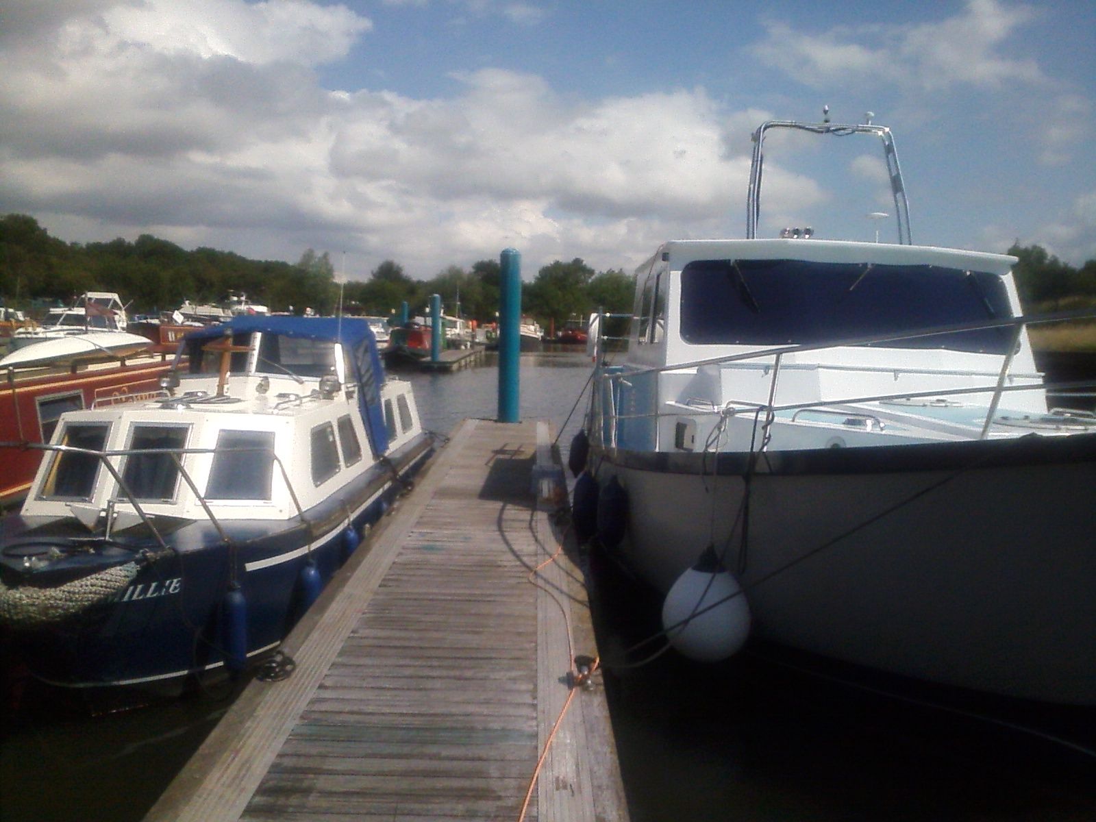

Alan de Enfield Posted June 20, 2021 Report Posted June 20, 2021 (edited) 9 minutes ago, Machpoint005 said: Mine has press studs on the forward edge and bungees on the after edge. I'd be wary of press studs all round: what happens if (when?) the canopy shrinks? We had press studs on all our NB cratch covers. We have 'lift-the-dot' fasteners on the cruiser stern / 2nd helm cover We have press-studs on our cruiser window covers (the covers have been in use since the boat was built in 2003) and have had no shrinkage. I replaced the press studs when I repainted the boat with stainless steel ones from ebay - they rusted within a few weeks. Replaced then with Stainless Steel from (lumpy water) chandlery, they rusted within a few weeks. Ended up buying very expensive ones guaranteed to be type 316 SS. No problem since. Screwed them into the original holes and the stud-tops in the window covers fitted perfectly. The cover over the front window is about 12' x 3', is tight but it's not difficult to pop the press studs on. Edited June 20, 2021 by Alan de Enfield
