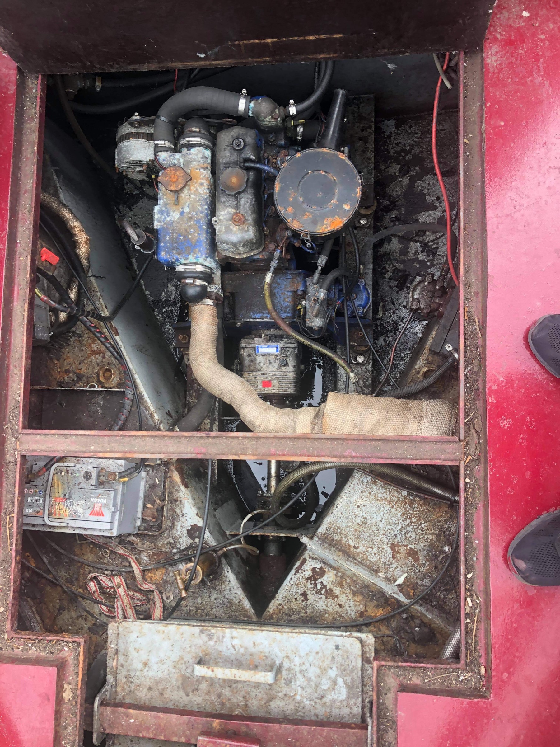

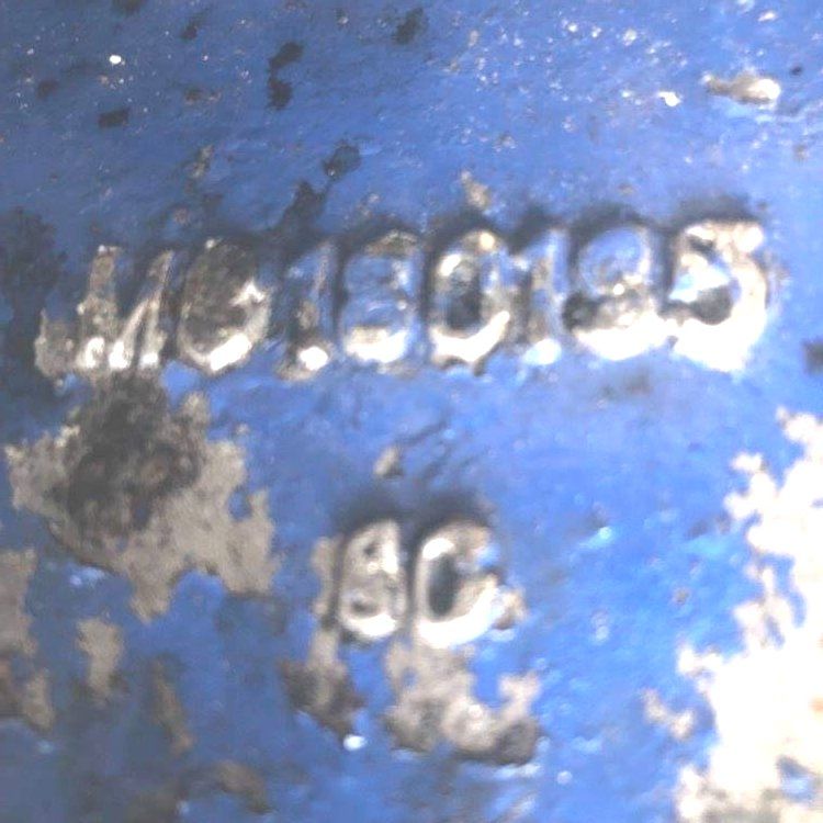

andy4502 Posted June 10, 2021 Report Posted June 10, 2021 Hi all, I am trying to definitively identify my engine as it is old and tired and I may need to replace/upgrade. The boat was built in 1993 in Wales as a hire boat and I have been told by a number of engineers it is a thornycroft/vetus/Mitsubishi. I do not have a manual and I believe it may be a Mitsubishi K3 but don’t know model, the heat exchanger part no is for a k3 and this (photo ) number is stamped on the back of the engine above the gearbox. Any ideas on this? Power?
Stilllearning Posted June 10, 2021 Report Posted June 10, 2021 The paint is bitsashitty blue, and that casting number reminds of them.
bizzard Posted June 10, 2021 Report Posted June 10, 2021 If the oil filler cap is dished in downwards with knurled finger grips around the edge and has an electric fuel pump almost certainly a Mitsubishi
Jonny P Posted June 10, 2021 Report Posted June 10, 2021 5 minutes ago, bizzard said: If the oil filler cap is dished in downwards with knurled finger grips around the edge and has an electric fuel pump almost certainly a Mitsubishi Tony Brooks has already identified it as a Mitsubishi in the thread about the head gasket which relates to the same engine. OP seems keener to pay for a new engine than pay for someone who knows what they are doing to look at the one they already have.

bizzard Posted June 10, 2021 Report Posted June 10, 2021 58 minutes ago, andy4502 said: Like this? Definitely 3 cyl Mitsubishi.

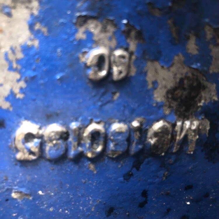

bizzard Posted June 10, 2021 Report Posted June 10, 2021 2 minutes ago, bizzard said: Definitely 3 cyl Mitsubishi. If you hold a mirror in front of that number it might read right although still upside down. First letter M for Mitsubishi.
Tony Brooks Posted June 10, 2021 Report Posted June 10, 2021 Just now, andy4502 said: So vetus was obviously working in 1993, however did thornycroft (and others maybe) convert/use mitsubishi as a base or is it likely to be a Mitsubishi marine engine? Any idea of power? I see that the current vetus 3cylr are 27hp Mitsubishi DO NOT MAKE marine engines, at least in the sizes we use. They make industrial engines that they will sell to almost anyone to do what they will with. That ranges across generators, agricultural equipment, probably rail equipment and all sorts of other applications. One very small application base is for small marine engines. Vetus is just one mariniser buying engines form Mitsubishi, as were Thorneycroft and I think Beta at some time in the past. You need the Mitsubishi engine number, not the Thorneycroft one, although some here may know which Mitsubishi engine that refers to. Once you have that you might be able to find what is known as a short engine (block, pistons shafts etc.) and have the other parts changed from your existing engine. No idea of power but the same base engines seem to be given different powers by different marinisers. What you need to know is the overall dimensions, including the mounting centres and the position of the centre of the flywheel relative to the engine mounts. Be very wary about so called overhauled or reconditioned engines. Some are very good, some OK and some have just been steam cleaned and spray-painted. I suspect you would do far better to have the existing engine sorted out by a known good mechanic rather than buy something you know little about.
Tony Brooks Posted June 10, 2021 Report Posted June 10, 2021 I have had a go at that number: It looks like Mx180185 with x needing cleaning more. it may be an 8,9,6, or zero.
bizzard Posted June 10, 2021 Report Posted June 10, 2021 4 minutes ago, Tony Brooks said: I have had a go at that number: It looks like Mx180185 with x needing cleaning more. it may be an 8,9,6, or zero. Ah, the Nancy Blackett method.
andy4502 Posted June 10, 2021 Author Report Posted June 10, 2021 I will try cleaning it up tomorrow - on wine now
Tony Brooks Posted June 11, 2021 Report Posted June 11, 2021 (edited) 14 hours ago, andy4502 said: I will try cleaning it up tomorrow - on wine now And once you have the correct number, find a Mitsubishi agent to talk to. On no account Vetus unless you have very deep pockets and long arms. https://www.diamonddiesels.co.uk/ There are others like West diesel, google for them. Edited June 11, 2021 by Tony Brooks
