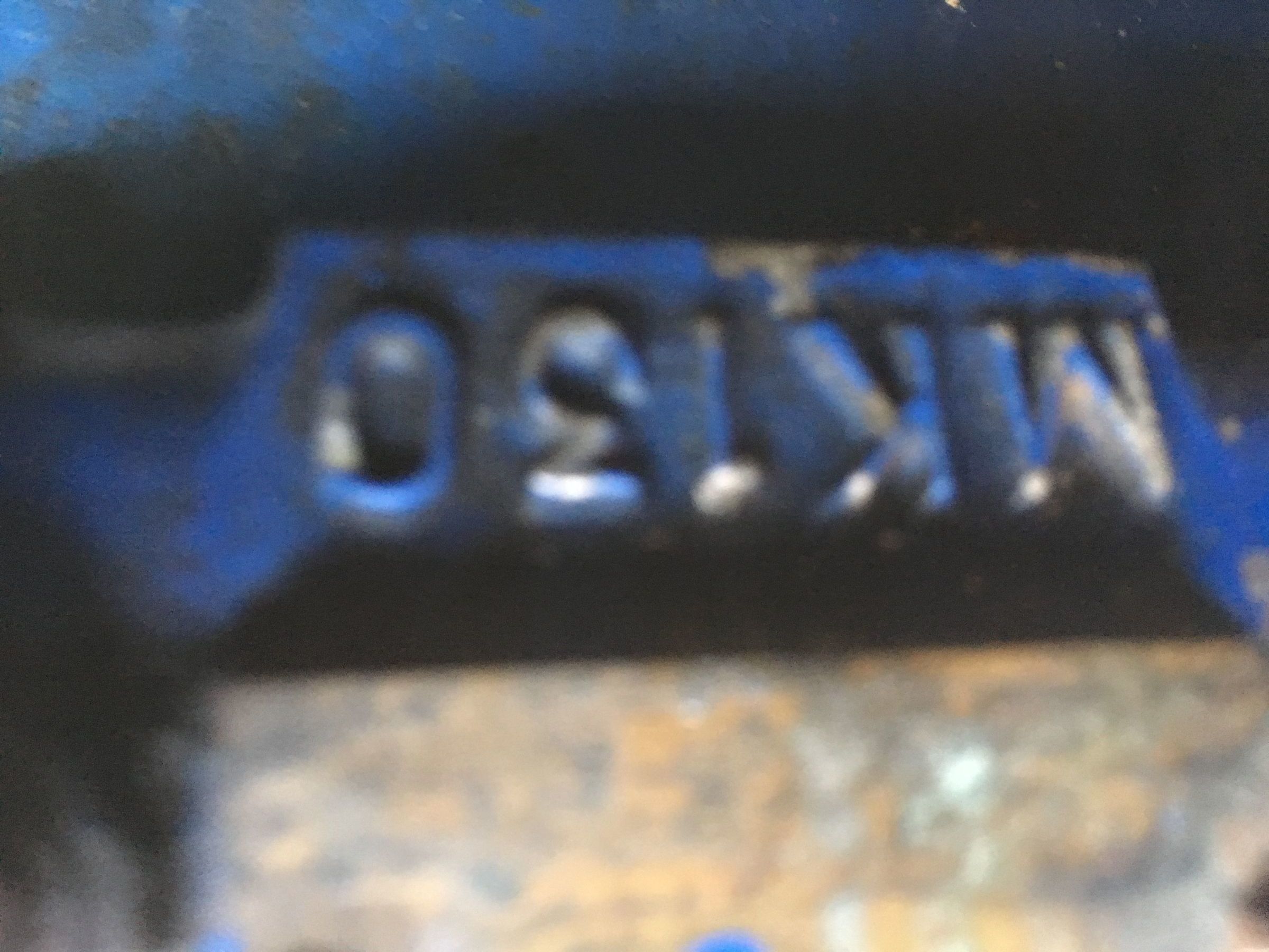

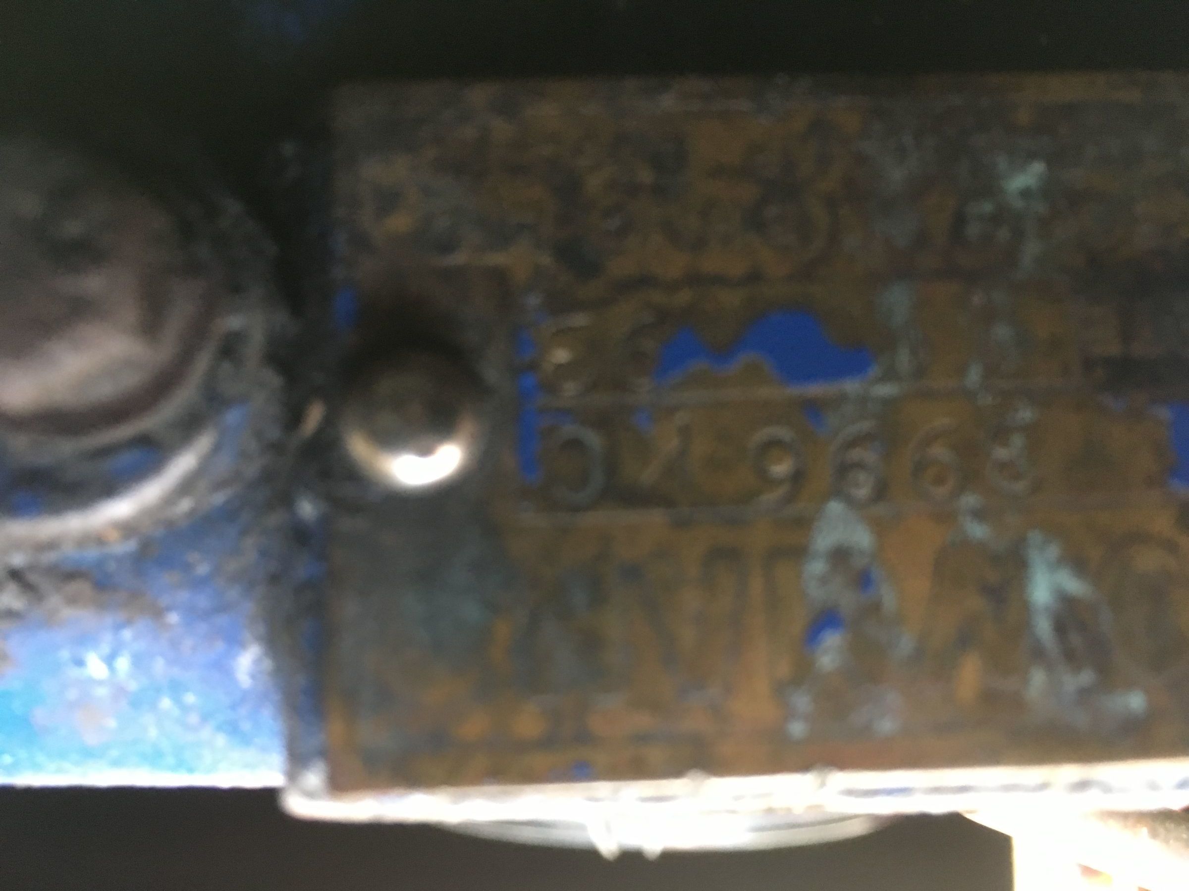

Hi all, I am trying to definitively identify my engine as it is old and tired and I may need to replace/upgrade. The boat was built in 1993 in Wales as a hire boat and I have been told by a number of engineers it is a thornycroft/vetus/Mitsubishi. I do not have a manual and I believe it may be a Mitsubishi K3 but don’t know model, the heat exchanger part no is for a k3 and this (photo ) number is stamped on the back of the engine above the gearbox. Any ideas on this? Power?

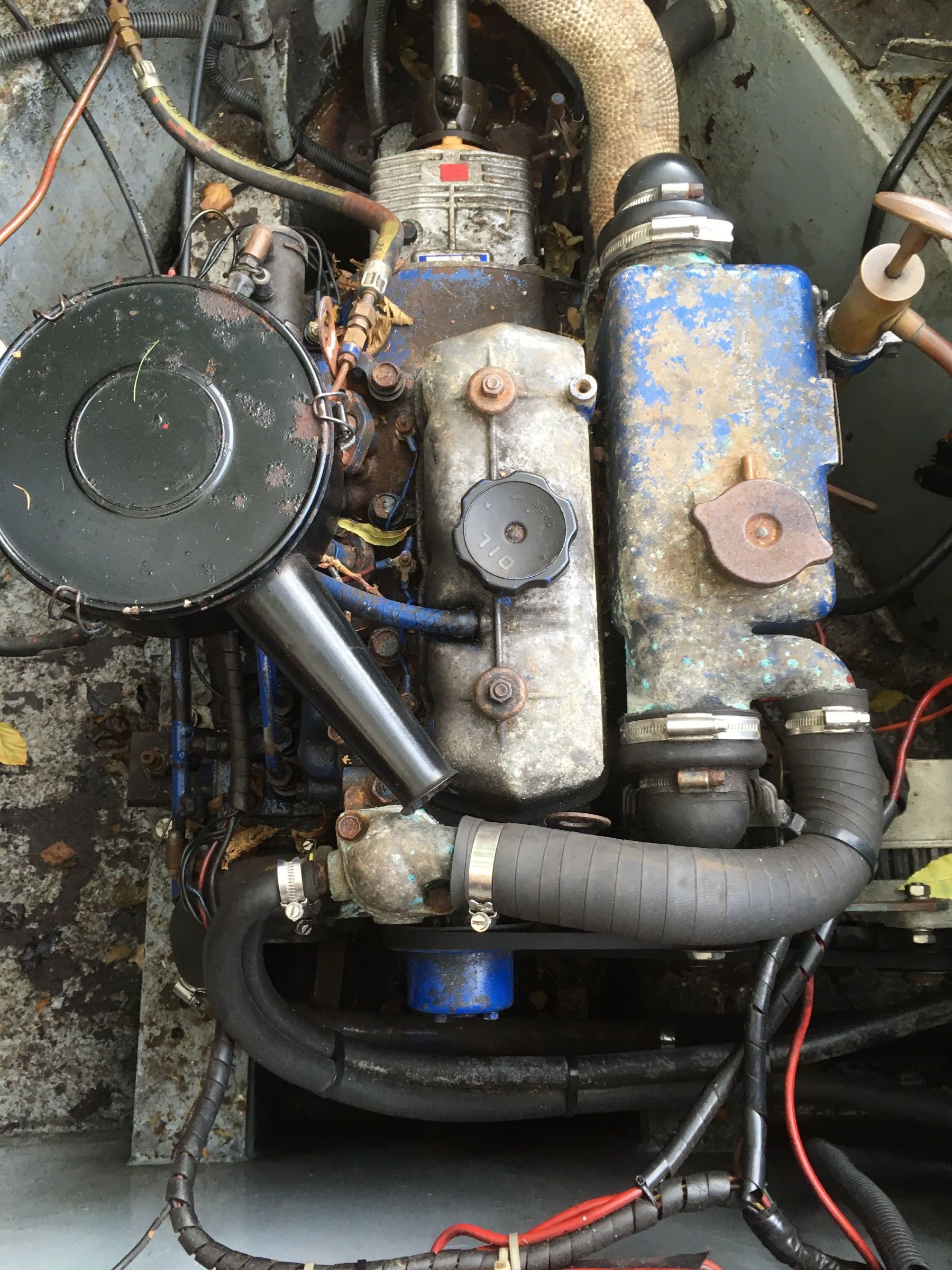

ok - thanks for advice and maybe i am going down wrong road. Would the additive be a bad idea anyway? (obvs some people on here are saying it would be a stupid thing to do). Here are some pics of the engine from a year ago. Since then there has been oil leak with emulsified/white addition under engine and this is what she was going for repair for (renew electrical connections, take out engine, clean bay, renew ?bottom gasket - all as suggested by RCR person who came to see boat when i broke down). engine plates
