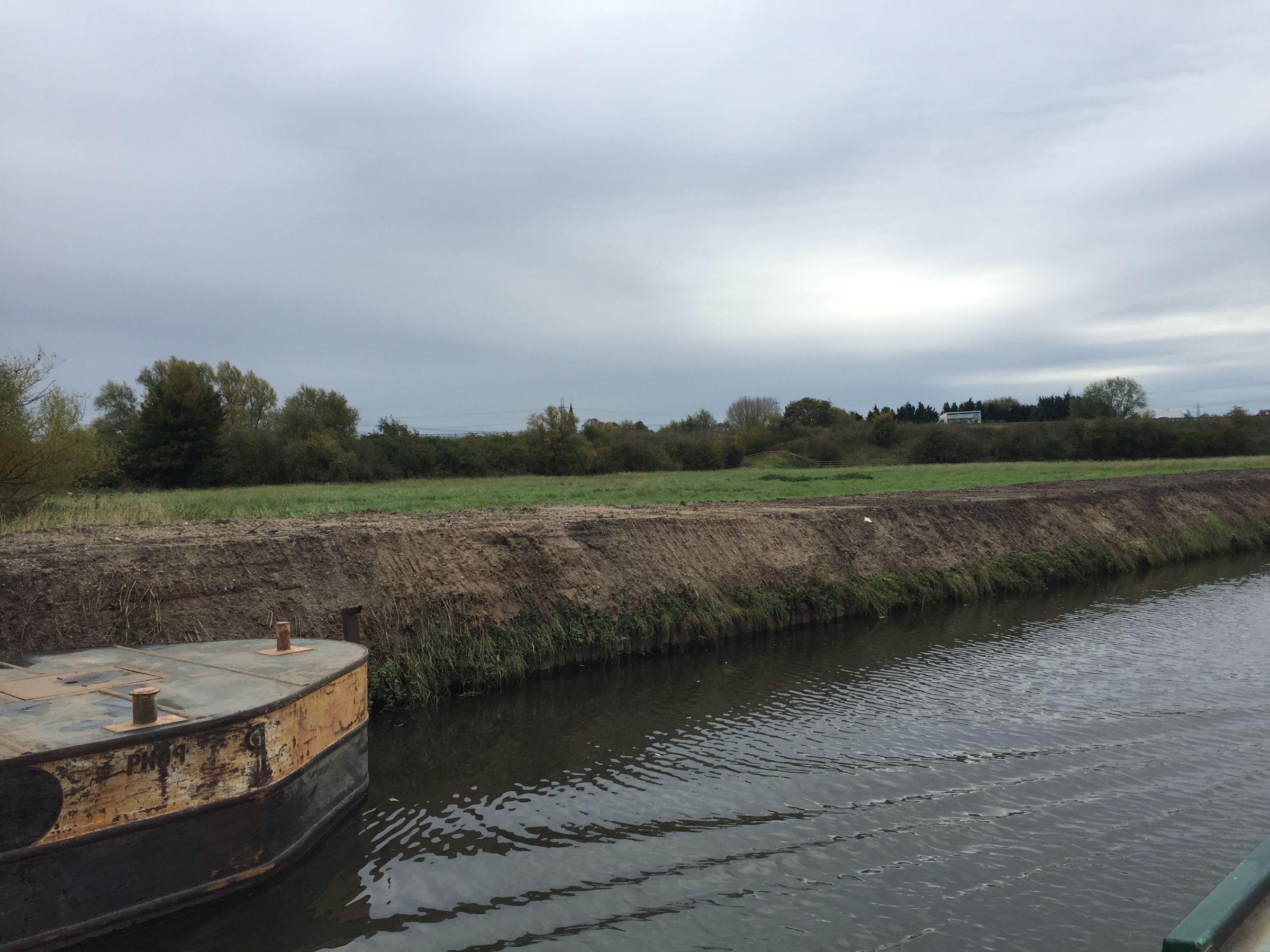

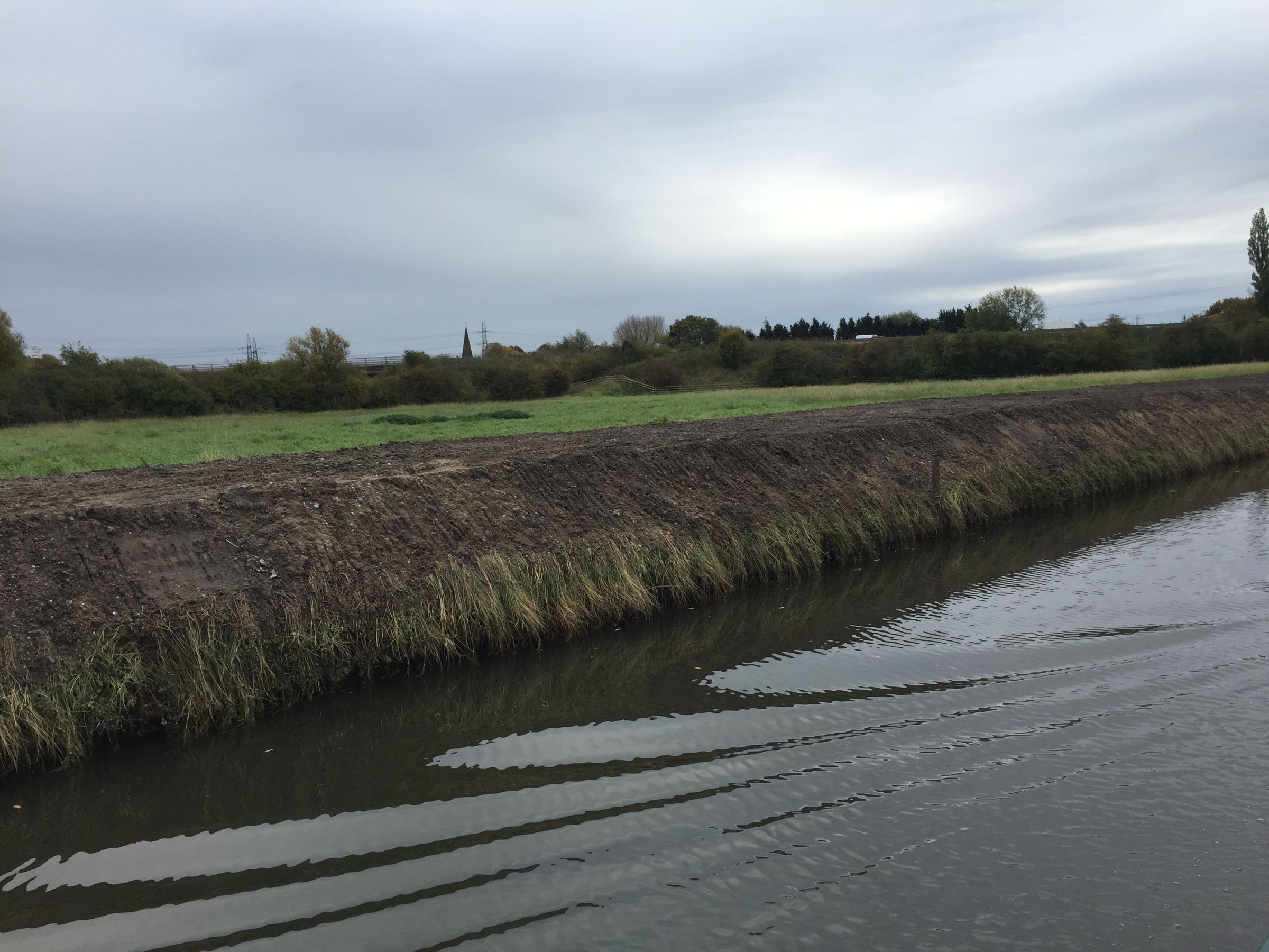

Last September/October a large amount of silt was dredged from above the lock and deposited on the bank in such a way that at the next major flood it would be washed back into the cut!!

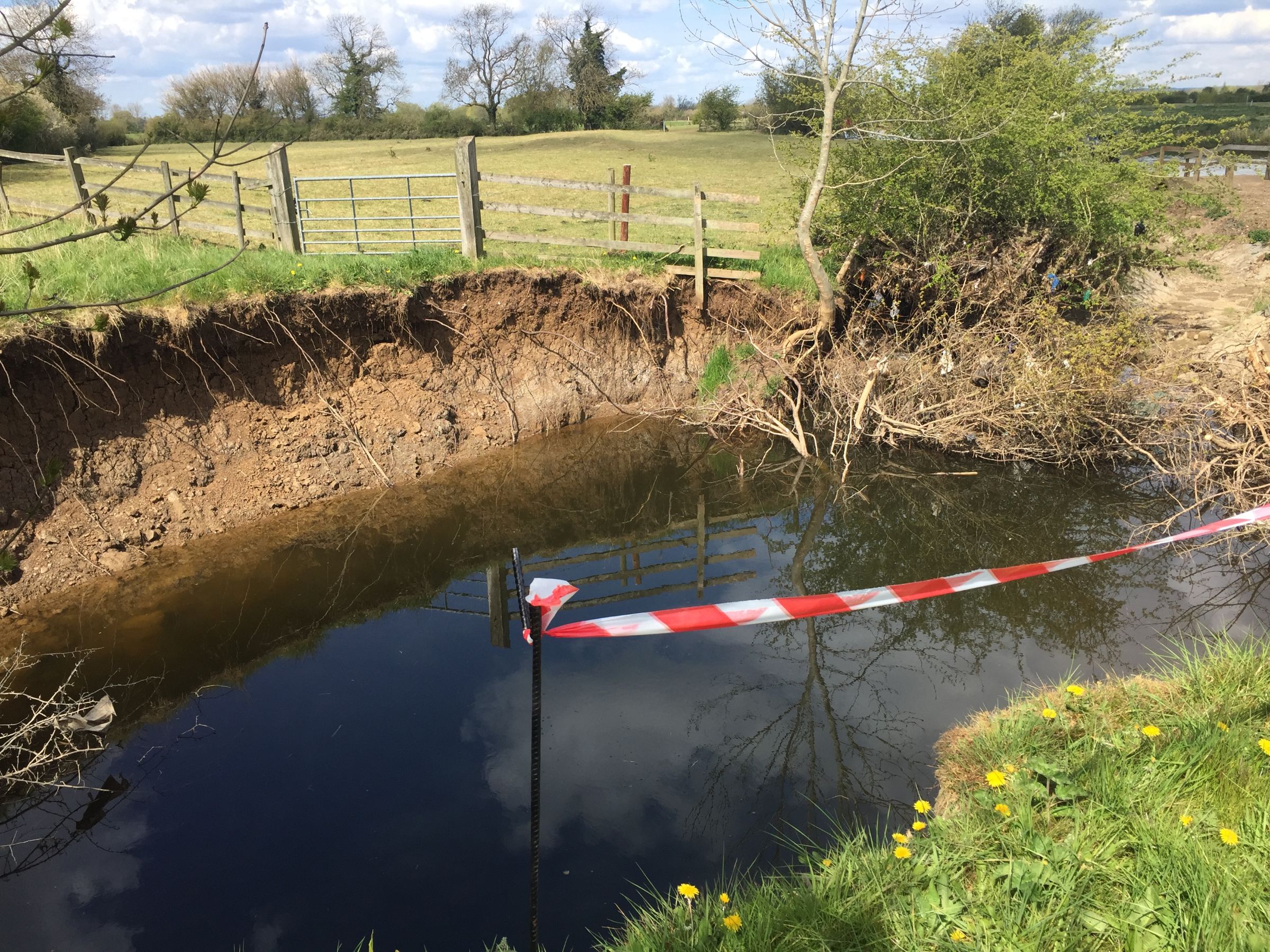

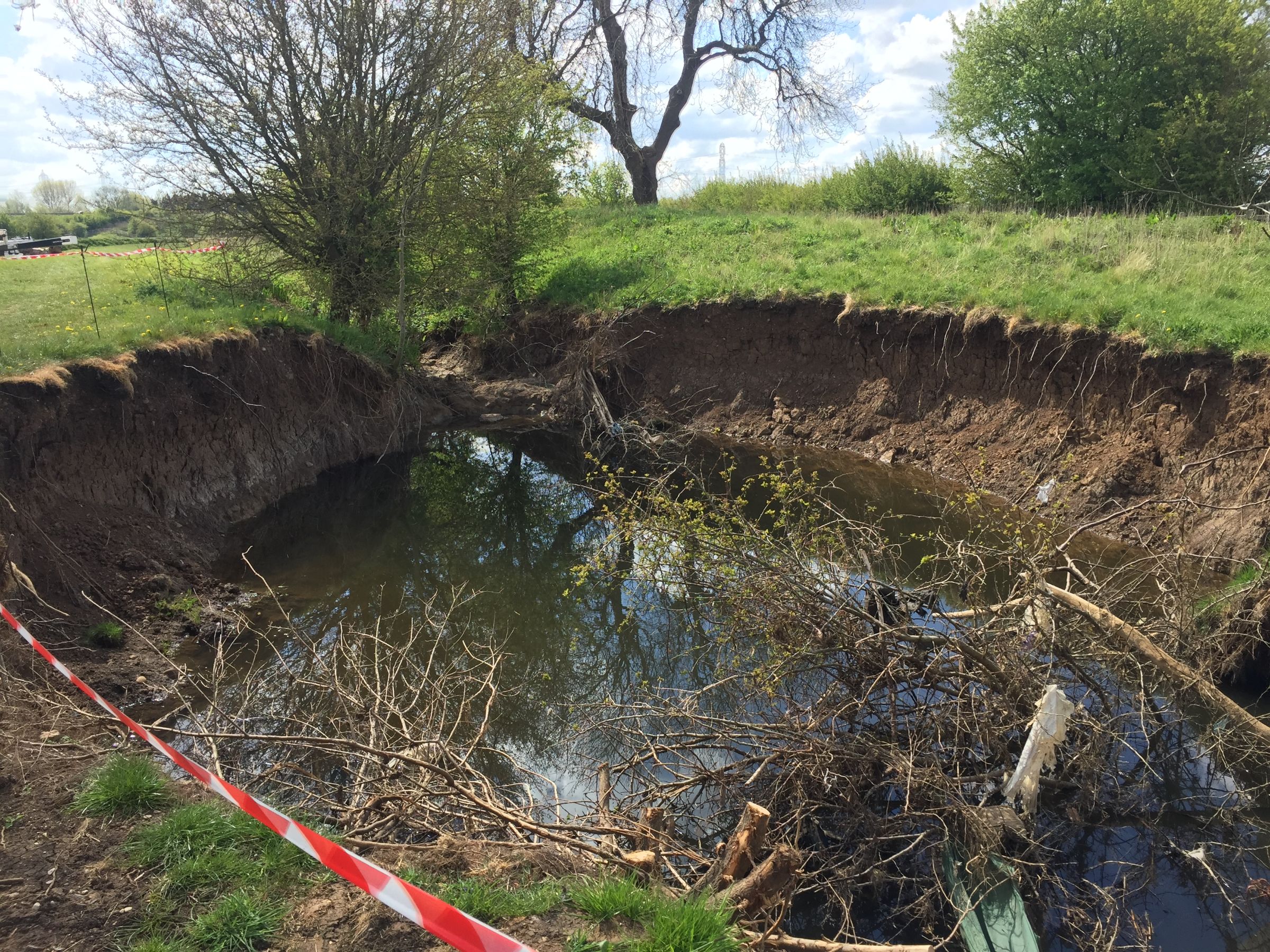

Ratcliffe lock is still difficult. one top gate cannot be fully opened. However the real problem is that the downstream lock landing is completely blocked by a shoal. The only way to operate the lock is by picking up and dropping of people in the lock mouth.
The flood water has overtopped the lock wall flowed into the adjacent ditch and then washed a large hole the contents of which are now blocking the landing. The first two photos show this hole and the third part of the shoal.
There are no warning signs or bouys especially when going upstream. We failed to pull a boat of yesterday morning. Fortunately we were boating with friends and they have a more powerful engine that us and they got it off.
