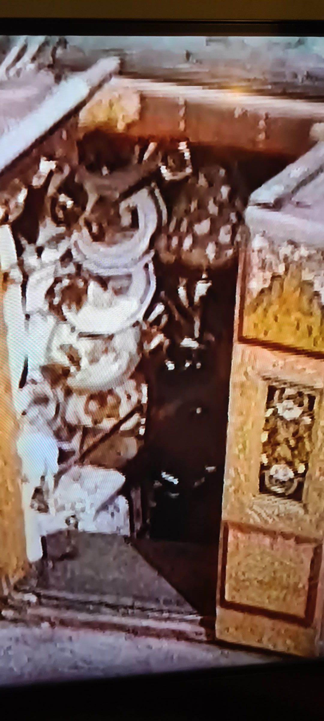

So I've been doing some research and from what I can tell from very old film and very odd photos I'm trying to hunt down different makes of white (pos ceramic) back cabin stoves that would fit into a motor.
It could be polished cast iron but pics and videos def look more white.
Anyone know of any ranges that were build either ceramic or ceramic coated?
I think the oven was on the right as from pics the door looks too big. A Stratford comes to mind as these could be polished but not 100% sure ill see if I can get a still, if I put it on the 4k tv

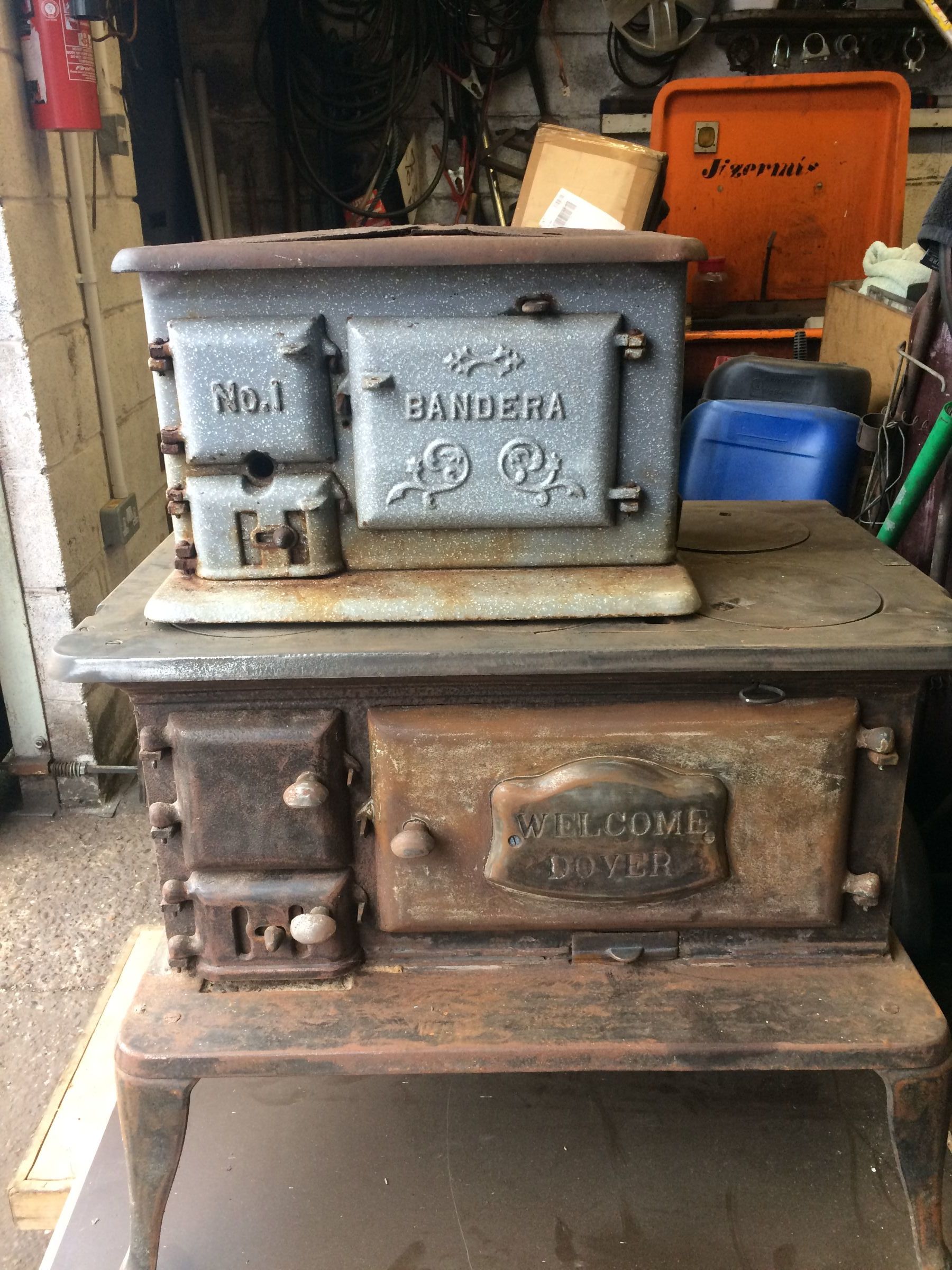

I've never seen a white back cabin range but some did come in vitreous enamelled finishes around the 1940's. There's currently a Belle on Ebay in grey, and in my restoration corner there's a Dover that was originally green and a tiny Bandera No1 in pale grey.
The problem is the enamel suffers from corrosion quite easily and is very expensive to have refinished. There's only a couple of places in the country that do it and as the process involves grit blasting and heating to an extremely high temperature there's a good chance of breakages on fragile parts.

Can you post, or link to an example picture? I'd be surprised if they were white enamel. More likely would be a reflection from highly polished black lead, buffed up every day by a proud boatwoman. A photo from outside, glimpsing a stove in an otherwise dark cabin could well look white if the camera aperture, shutter speed etc were set for the outside of the boat and the general scene. Especially if the sun catches it. Black and white film isn't terribly sophisticated compared with a modern digital camera.

Was colour film yes I did think pos silver I'm trying to get a screen shot of it now as we speak.

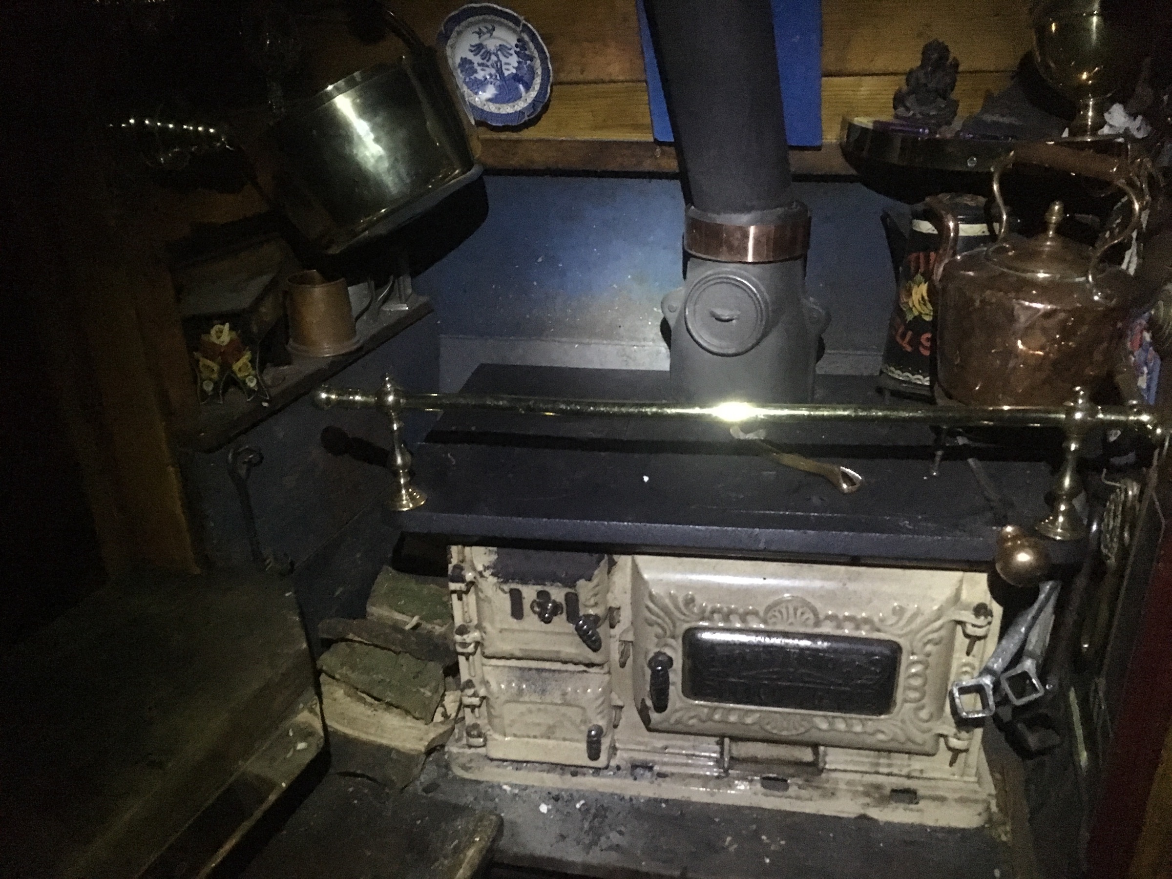

The Caledonian Nipper was produced in a creamy coloured enamel, NB Valencia is fitted with one, belongs to some friends of mine. Does have a LH firebox but is small enough to fit in a motor.
 I have an unrestored Colombian Foundry Bonnybridge Dover in The Phoebe’s back cabin. Found for £180 on Gumtree but I had to drive to West Kilbride in Scotland to collect it.
This  could be very sim ill post pic on second

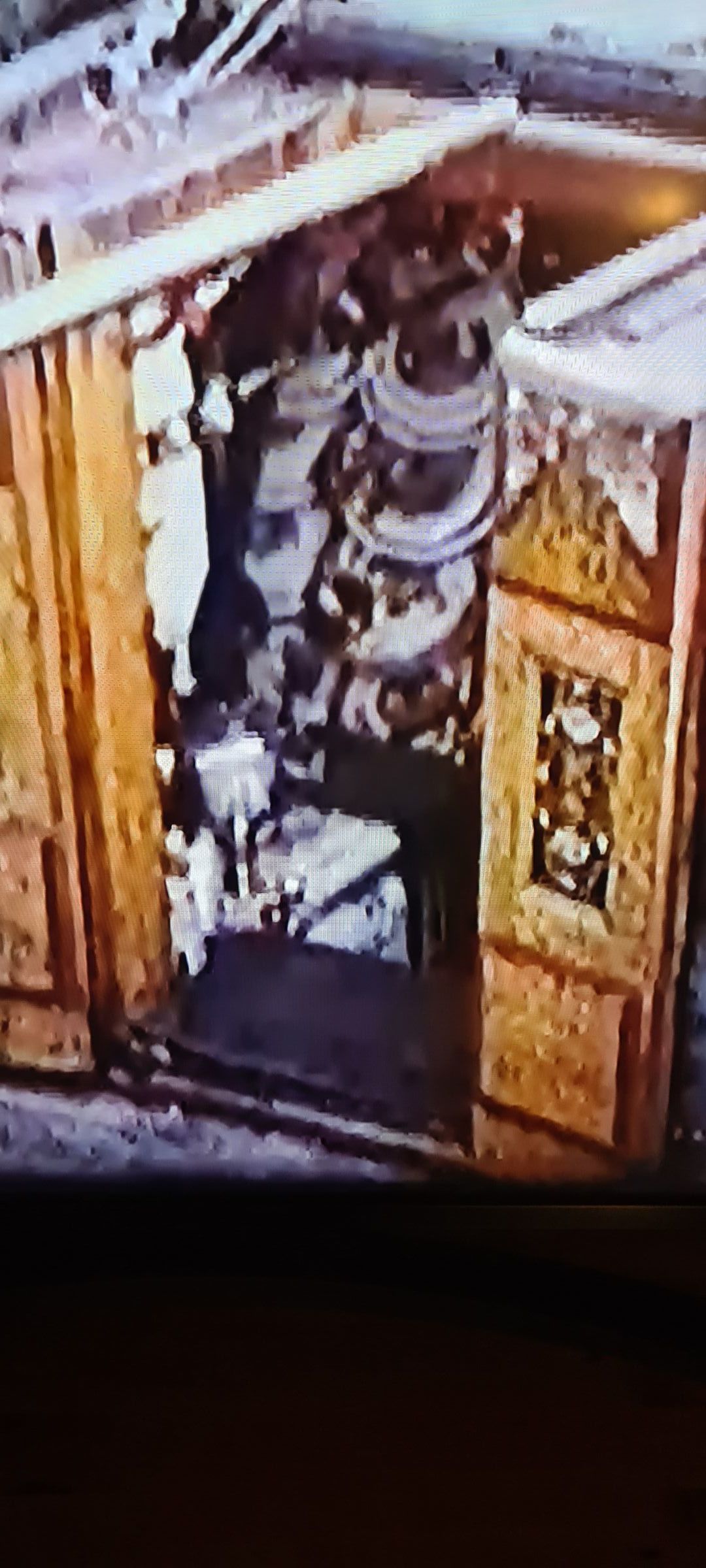

This is the best and clearest I can get it off the 4k tv the oven door def looks white.
It also looks like it has a round disc on the chimney aswell as apposed to none or a door like epping

Might be a towl over the oven side from this pic.
