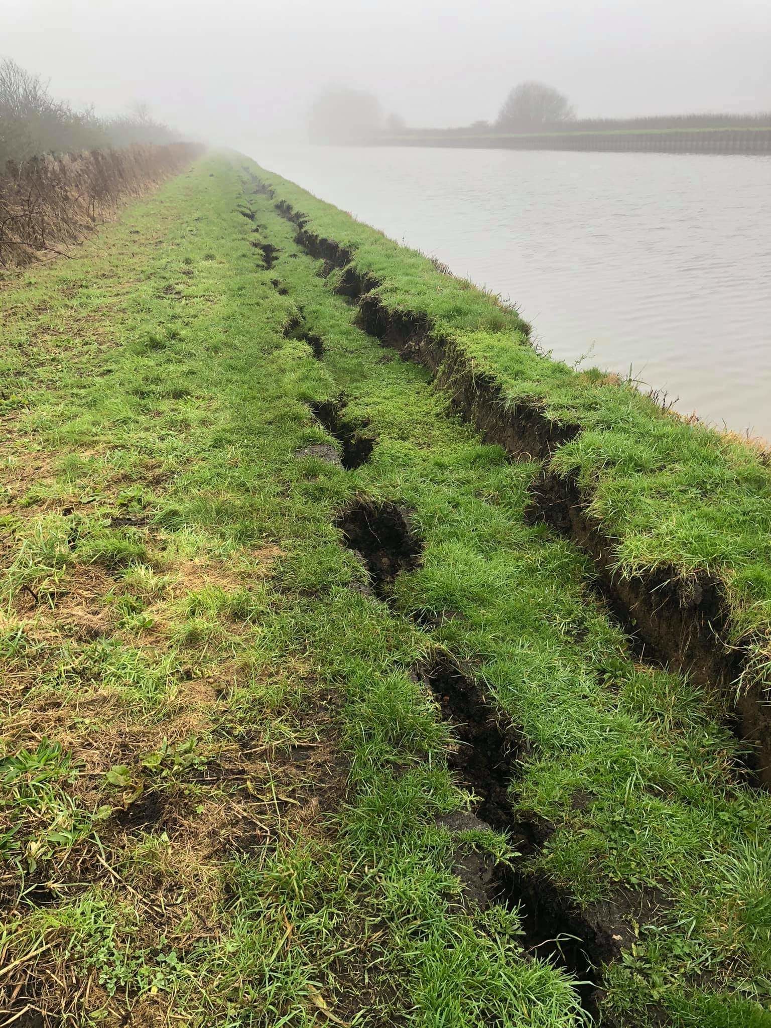

22 minutes ago, ditchcrawler said:
I thought there was a big concrete bit to the left of it.
There is.
The breach under discussion is not at Pollington which is where this picture was allegedly taken.
I think somebody is claiming this shows further evidence of decay along the Aire and Calder.
https://canalrivertrust.org.uk/news-and-views/news/an-update-on-the-aire-and-calder-navigation-breach
Update 23/12/20
We are aware that where the water levels in the navigation have dropped, isolated sections along the bank have moved inwards as a result of the loss of pressure from the water.
Whilst this looks unsightly, it does happen from time to time with canals where we take the water out for maintenance. It is not a cause for concern. Our engineers have checked the waterway this morning and will continue to do so.

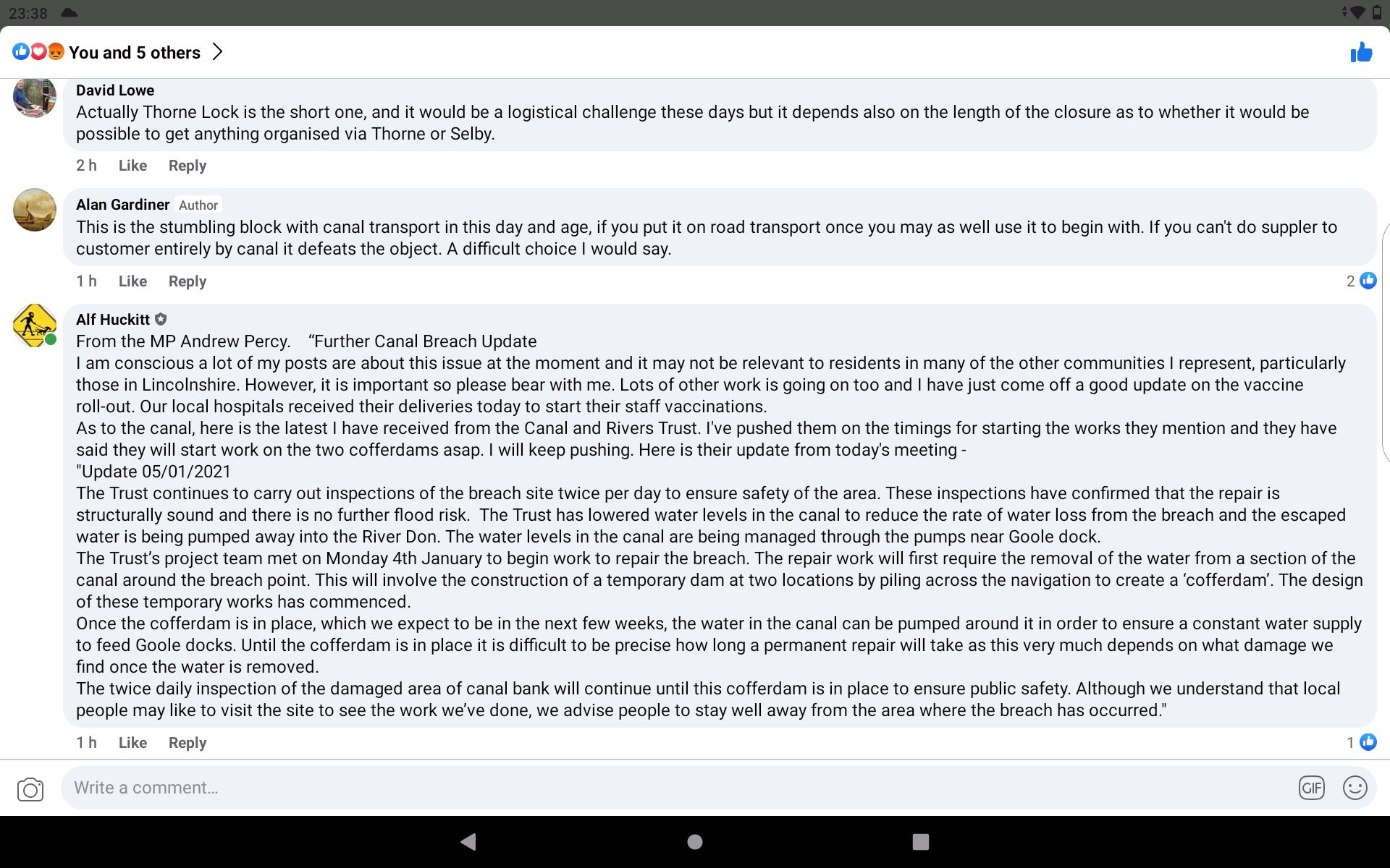

1 hour ago, Orwellian said:
Have they fixed it yet?
No, in fact the "repair" is failing and the CRT have lowered the levels on that stretch even more. We in Goole are isolated from the canal by the defective emergency stop gates.
Taken from a Facebook Barge Group.
Edited by Joe Bourke
Oleanna's reports (see https://oleanna.co.uk/) seem a little more positive with regard to water levels. The CaRT quote in Joe's post I think means that they have (already) lowered the water level - in fact did so as soon as the breach was reported, rather than that they have reduced it further from the initial level. Certain that is not Pip's reading of the levels as measured by them and others at Goole, taking their pontoon as a reference level.
As far as I can see, the short term repair is working about as well as could have been expected - it was only intended to prevent major flooding and the reports suggest that it is not leaking any more over the past few days.
Once the coffer dams are in place then clearly the leak is stabilised but it particularly bad news for the resumption of commercial carrying as it does suggest that the permanent repair will not be a speedy affair. After all, it seems that the immediate cause was a failure of a third party culvert (much as happened recently on T&M) so it will involve several parties to agree on a solution that not only fixes the immediate problem but deals with its underlying weakness. It is not clear to me how much the culvert is in active use and how much it is a relic of a former drainage scheme. In any event, it sounds as if they are expecting to discover a significant failure - the images I have seen do suggest that it was more than a simple bank collapse type of breach.
Thanks Mike. I think this represents the situation very fairly.  The major problem is that this has (as stated) not turned out to be a conventional breach (if such a thing exists!) and the actual position of the leak is not yet known and won't be until the immediate area is drained.   This is why it's been difficult to stop the leak completely with stone etc.  Once the extent of the repair needed has been established the Trust then has to decide whether to re-open the canal on a temporary basis (assuming that is possible) while designs etc are agreed, and permissions obtained from third parties various, or whether to keep the canal closed and crack on as soon as possible.  Clearly the latter would be cheaper, but the former would be preferred by the commercial operators and leisure users.

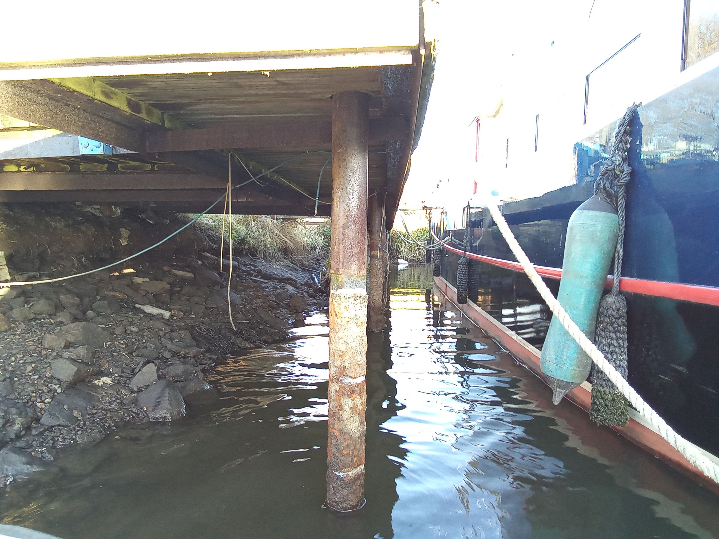

12 hours ago, Joe Bourke said:
We have dropped a foot in the last 24 hours.
It's not unusual in normal times, when there is no breach and the gates by the railway bridge are open, for the level in the docks and the two marinas to drop by about 6" just by the operation of Ocean Lock a few times. So I suspect that may the cause of the fluctuation. How is the level now?
27-28"' below normal, same as yesterday, but hey it could be Ocean Lock, what do I know?
