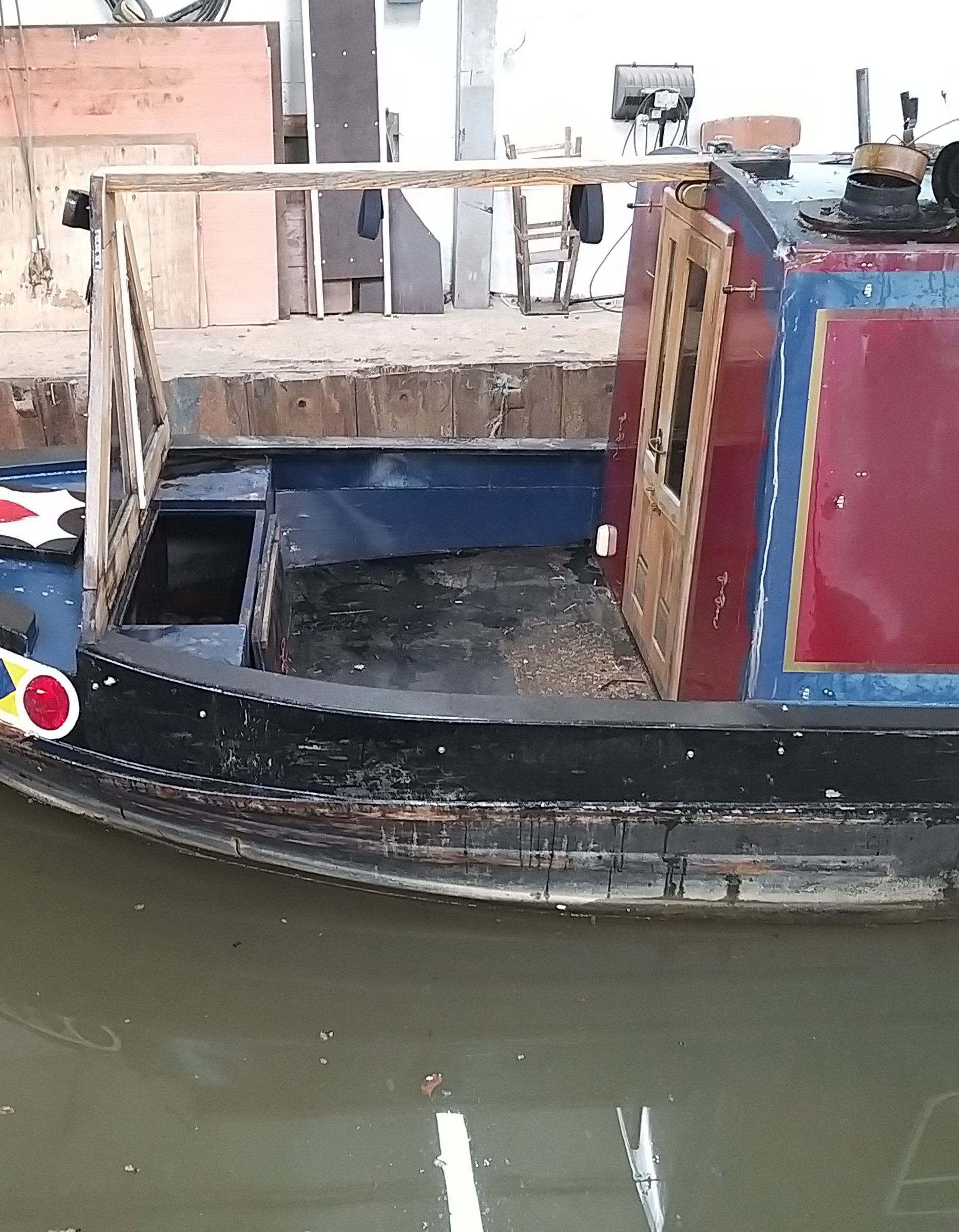

Since my stern cover was fitted on the boat I've called the supplier back to replace a rusted bracket/rivet etc and its now happened again - seems like a problem with the quality of fittings? Rather than call them back again I'm thinking I need to sort this myself but not used these things before, would this suffice?? HEAVY DUTY POP RIVET GUN HAND RIVETER TOOL+ 40 RIVETS 4 HEAD NOZZLES S105 | eBay or is there a better device i could do with?  Pointers gratefully received!  thanks!!

Drilling and tapping is probably a better method for fixing these, but you might have to drill out the drill out the fitting a bit, as the machine screws will have to be larger than the rivets were. Unless you can get to the underside and fit a nut?

Looking at that photo I suspect that once you've drilled out to tapping size then tapped the thread the two holes would be close to merging. Pop rivets are available in a variety of materials. Monel pop rivets are widely used on offshore boats. I suspect I've got some lost in the depths of my workshop although the chances of finding them are zero.
Had this when Loddon was repainted, all we did was move the fastener 6mm and filled the old holes, can't do it with pop studs but can be done with all the others.

Thanks for all the great info... i think I'll probably tap it and put in stainless steel screws as i might already have some of these and i need to try 'tapping' anyway....
This is all on the sliding hatch and my winter project is to remove the hatch and take home (first rig up something temp!) as it has lots of rust spots, or 'bubblings!'. I'll remove the fixings, tap them and pop on once painted, fit some proper insulation on the underside and put some rubber stip across as the hatch lets in water when it rains really hard - in bounces under the lip!
