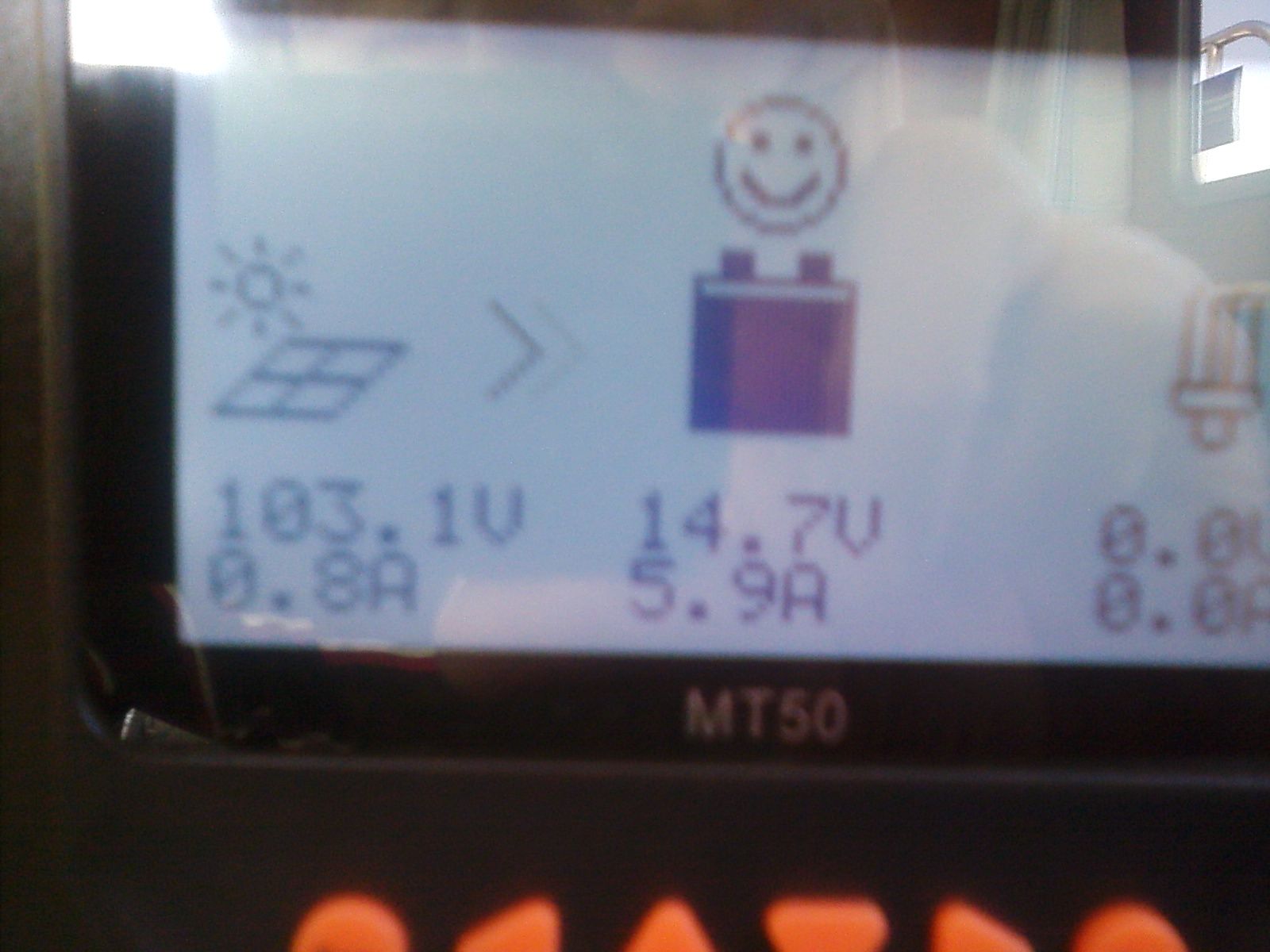

12 minutes ago, robtheplod said:
On reading I can see lots of panels are designed for house installations so the voltage output is often quite high (~50v), so the Amps is lower,
I have a 120volt panel (170w) "Low Light" so when the MPPT has converted it to 12 volts so in theory I can get 10x the current (at 12v) going into the battery that the panel is showing.
The way I see it is that if the sun is not very strong and I only get (say) 90 volts (ie 25% 'down), I still get a good input to the batteries. If I had a 12v panel and lost 25% I'd only be getting 9v and nothing going into the batteries.
Couple of examples
0.8 amps from the panel and 5.9 amps going into the battery at 14.7 volts

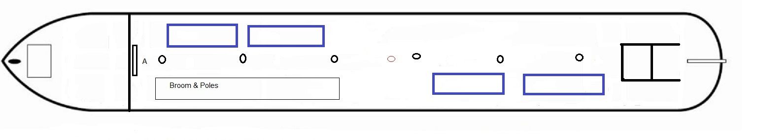

Everything is moveable so will be interesting to see what works... :)
Edited by robtheplod
With that layout since the two pairs of panels are at different angle, due to the curved roof,  you need to wire them as two pairs in parallel each pair in series. As well as the different angle producing different outputs, partial shading is more likely because they are a long way apart. If your roof is very curved it may even be beneficial to have two smaller controllers, one for each pair.

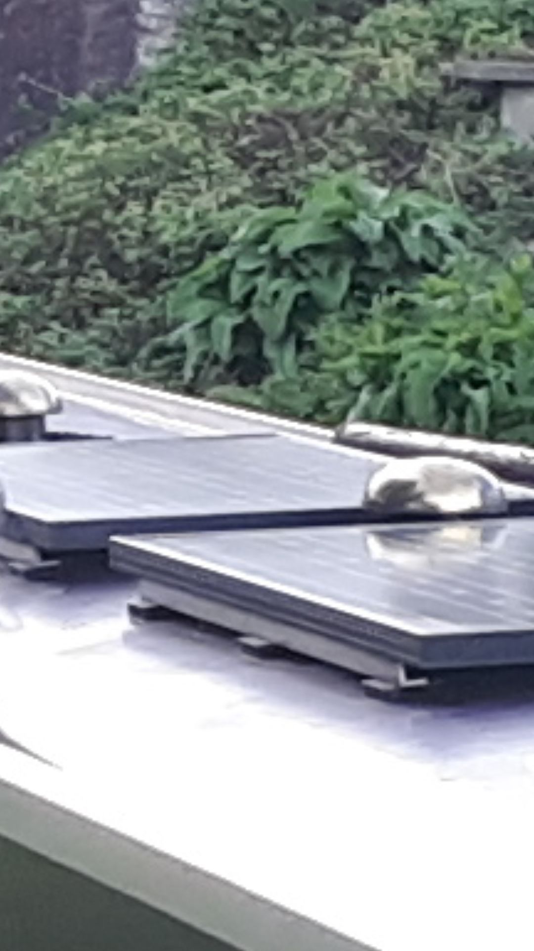

On 16/06/2020 at 23:20, Cas446 said:
I bolted aluminium u channel to the panel then magnetic pads to the u channel. The bolts holding the channel to the panel are lossened slightly to allow some movement for curvature of the roof. 6 pads per panel. About 4 years in service and they can be removed to clean the roof beneath. Obviously they could be stolen.
Thanks, where did you get the aluminium mounting that your magnets connect to?
