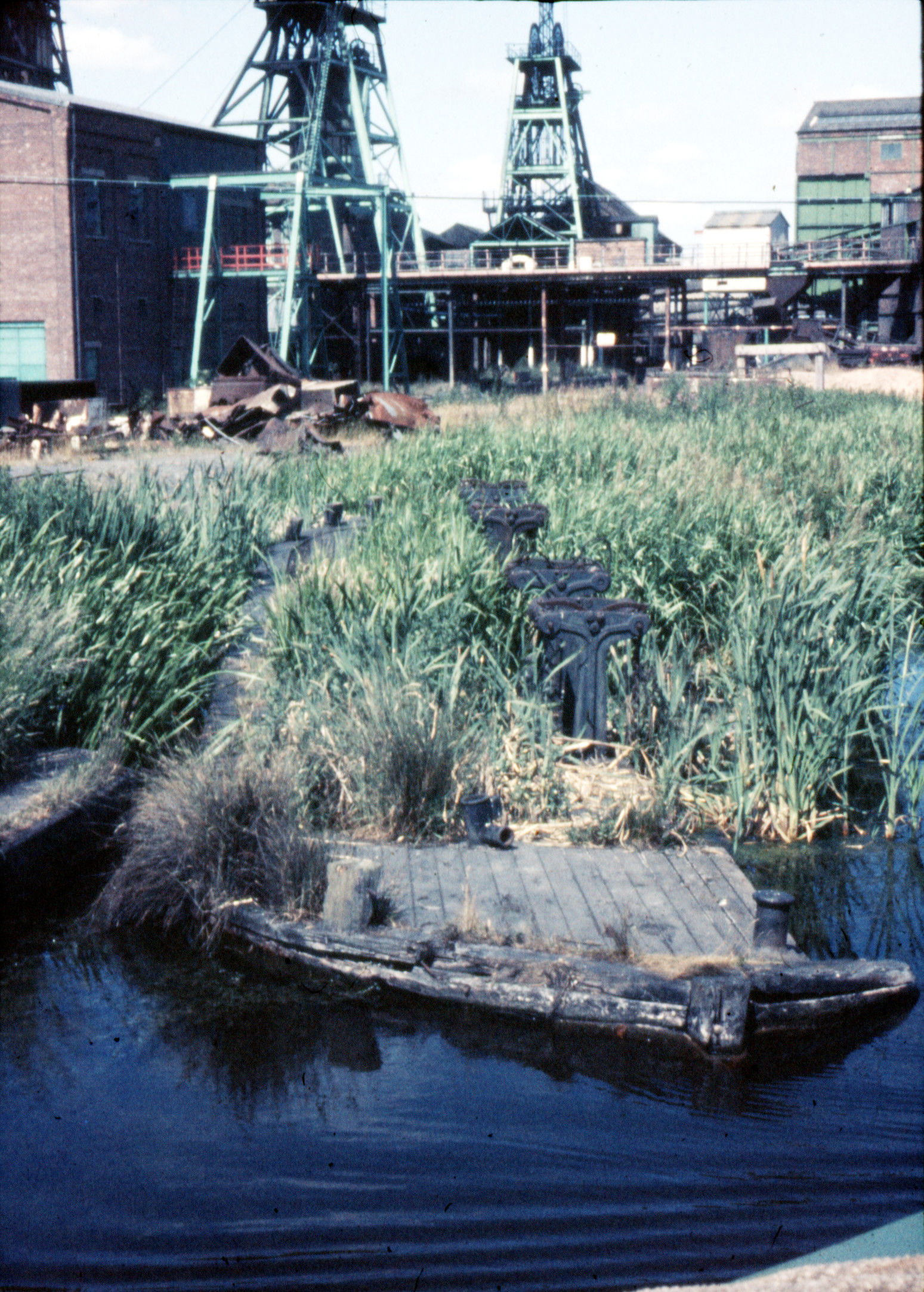

Pluto Posted June 5, 2020 Report Posted June 5, 2020 The L&LC had boats for filling in subsided sections using pit waste; this one was photographed in 1975 at Plank Lane.
