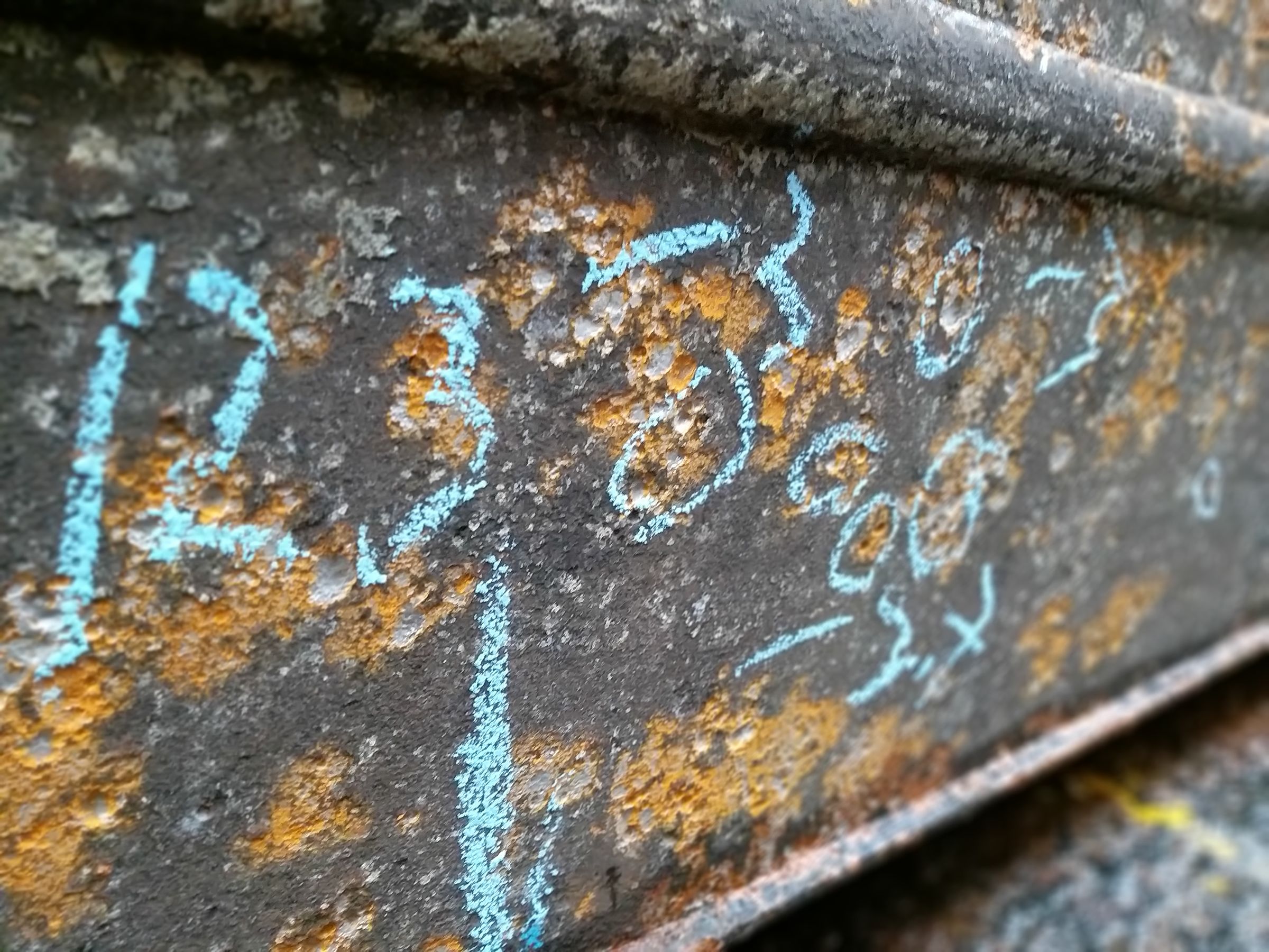

matty40s Posted January 15, 2020 Report Posted January 15, 2020 Here's a boat where blacking wasnt done for 5 years, marina based, permanent landline. Less than 20 years old and needs plating both sides(70 footer) due to aggressive pitting up to 4mm deep. 1
MichaelG Posted January 15, 2020 Author Report Posted January 15, 2020 8 minutes ago, matty40s said: Here's a boat where blacking wasnt done for 5 years, marina based, permanent landline. Less than 20 years old and needs plating both sides(70 footer) due to aggressive pitting up to 4mm deep. Wow, what causes such significant damage, electrical erosion or plain old rusting?
matty40s Posted January 15, 2020 Report Posted January 15, 2020 Lack of maintenance, loss of blacking , no replacement of blacking and giving galvanic corrosion a free run.
ditchcrawler Posted January 15, 2020 Report Posted January 15, 2020 38 minutes ago, matty40s said: Here's a boat where blacking wasnt done for 5 years, marina based, permanent landline. Less than 20 years old and needs plating both sides(70 footer) due to aggressive pitting up to 4mm deep. And people say boats dont rust at base plate level as there is no oxygen
rustynewbery Posted January 15, 2020 Report Posted January 15, 2020 That is electrical activity caused by galvanic action between the steel hull and anything else in proximity having a different voltage which causes current to flow between them. And not having had any protection in the form of blacking has made the matter worse. The boat probably has no protection in the form of an isolation transformer or galvanic isolator and it is pure neglect. Blacking every 2 years at around £800 a time [more varied prices are available!] would have saved £000's in over plating. Its not confined to marinas, but anywhere there are steel pilings or other boats. I measured the voltage between my boat and piling years ago and used an earth bonding strap to ensure no current flow. [a battery charging cable is a good source]. There was a potential difference between boat and piling which in turn allowed a current to flow. Another issue with the above boat is the lack of sacrificial anodes. Typically builders will put 2 each side, on the bow flares and swim but I was told that anodes must "see" each other to be effective and therefore additional ones are needed amidships. This becomes a problem too as they can be knocked off in bridge 'oles and lock sides. Finally, if the steel was not shot blasted to remove the mill scale ever present on steel, most blacking stands little chance of adhesion and it falls off - it happened to my boat after only 18 months and I had it done & coated with Zinga and 2 layers of 2-pack. Now I use a marina for winters, I fitted a "Safeshore" galvanic isolator. https://shop.pkys.com/What-is-a-galvanic-isolator-and-why-should-my-shore-power-system-have-one_b_112.html
