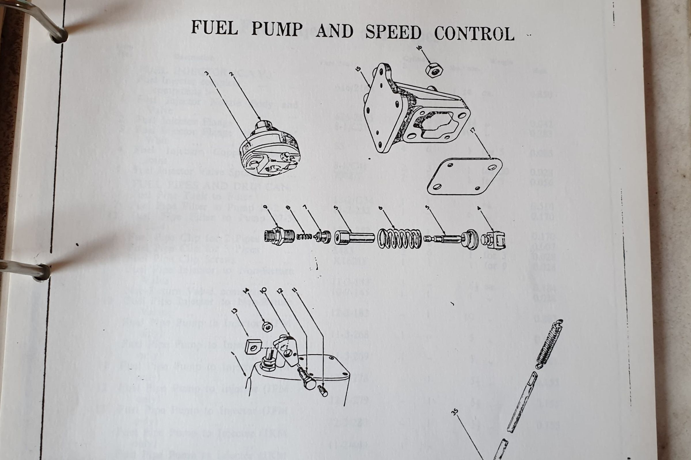

We appear to have a little bit missing off our engine - The pawl off the cold start device is not there.
That is how it was described to me but others may call it something dfferent! The pictures may help:
It is a dooferator that goes on this bit:
67547878_651904135315966_516259296086012
The parts manual shows the bits that are missing:
67673108_702449700200690_730496369940234
Whilst it’s desirable to have you won’t realky notice any ill effects if you don’t have it....bar some black smoke if you open the throttle right up when it’s running.

You ll probably find it in the sludge in the bilge,if you grope around a bit.......If you never run the engine on full noise ,you will never need the stop.....it just limits rack travel ..........incidentally,these externally tamperable excess fuel devices have been illegal for many years,due to the potential for black smoke.

I have just realised I never got back to reply to this thread, thanks a millon to everyone who has responded. We have now sourced the part but it has been useful as we now have some suggested sources for parts should we find we need stuff in the future
