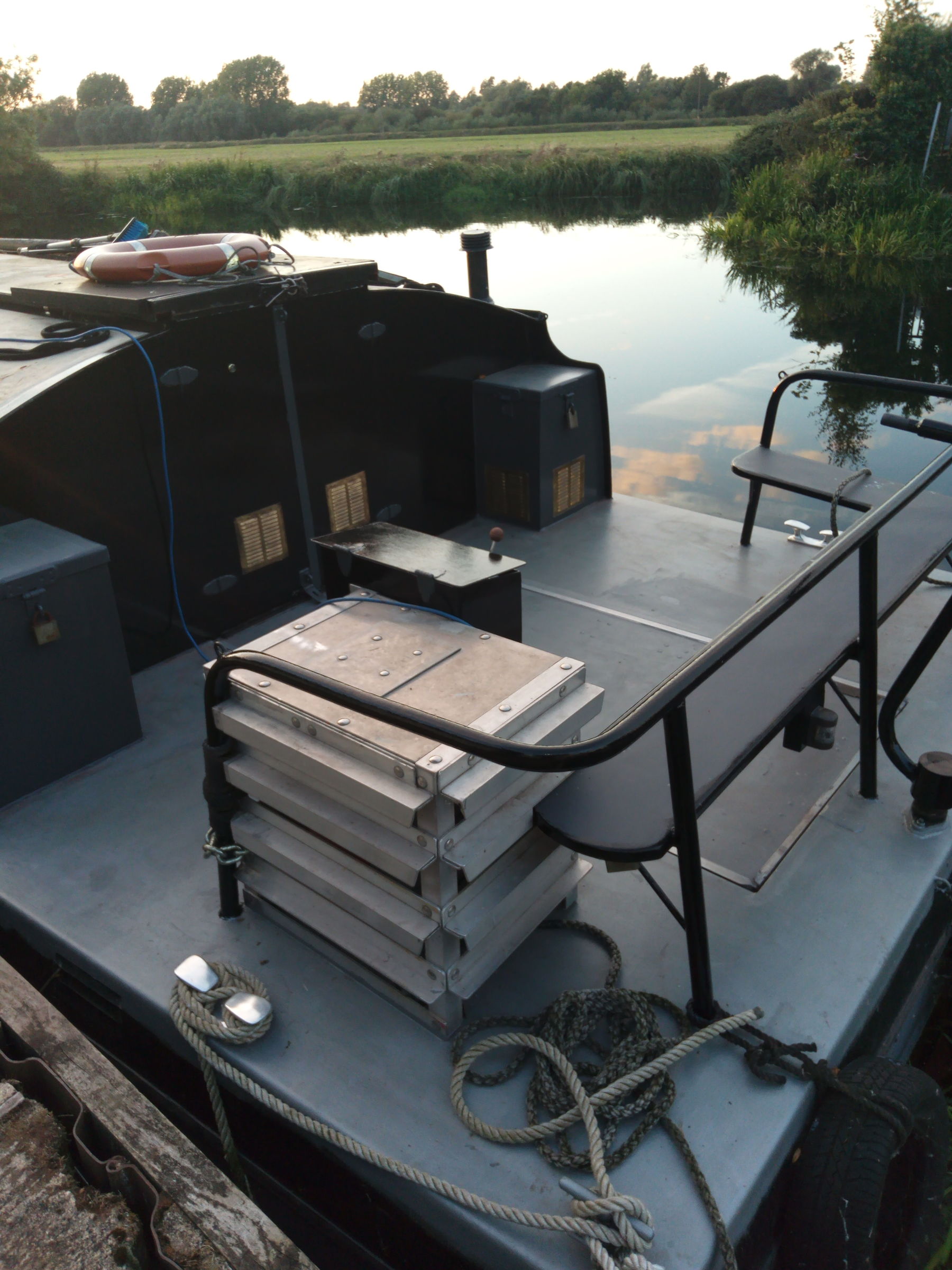

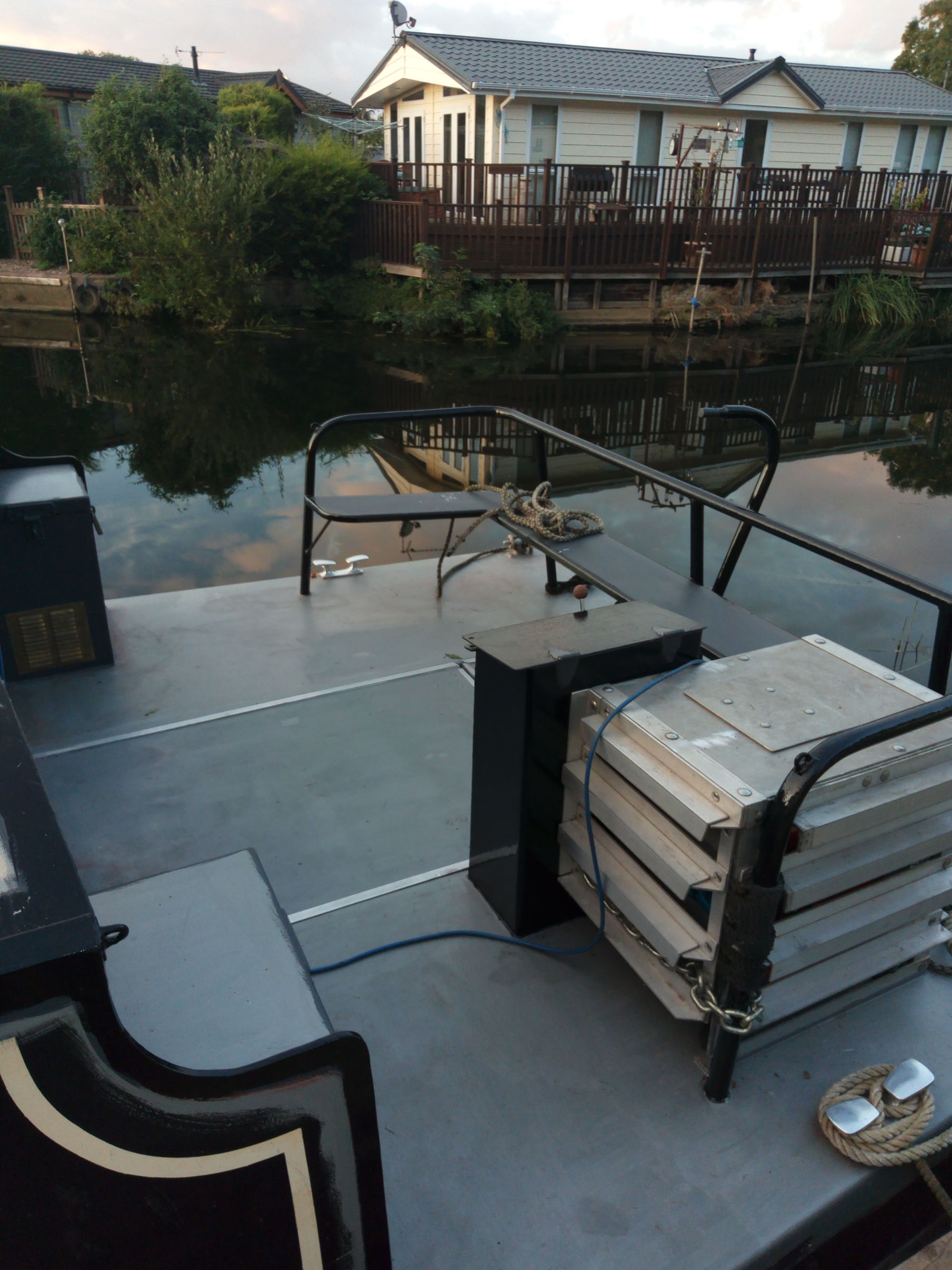

This is what I do. I built it from aluminium angle and sheet. I'm not recommending it to others as it doesn't pass the BSS. The other side of the box is a solid sheet. so it has 3 fully vented sides. I wouldn't do this on a narrowboat as it's too close to the rest of the boat..
Looks good. I guess its just a case of removing it and putting it in your car every three years during the examination.
4 years

Which your locker as proposed will not comply..
We could go backwards and forwards all night, I have tried to make you aware of the requirements, It is up to you what you do,
I bet you borrow your mates car wheels to get your thru the MOT as well !!
Saves you buying some new tyres.
The difference here is that if you do have an accident, a can of petrol causes a big fire and affects anyone around your boat.
Have fun.
I know what you mean. It's probably best for me to go to an engineer to fit a generator storage box. Takes away some liability on my part if anything happens.
