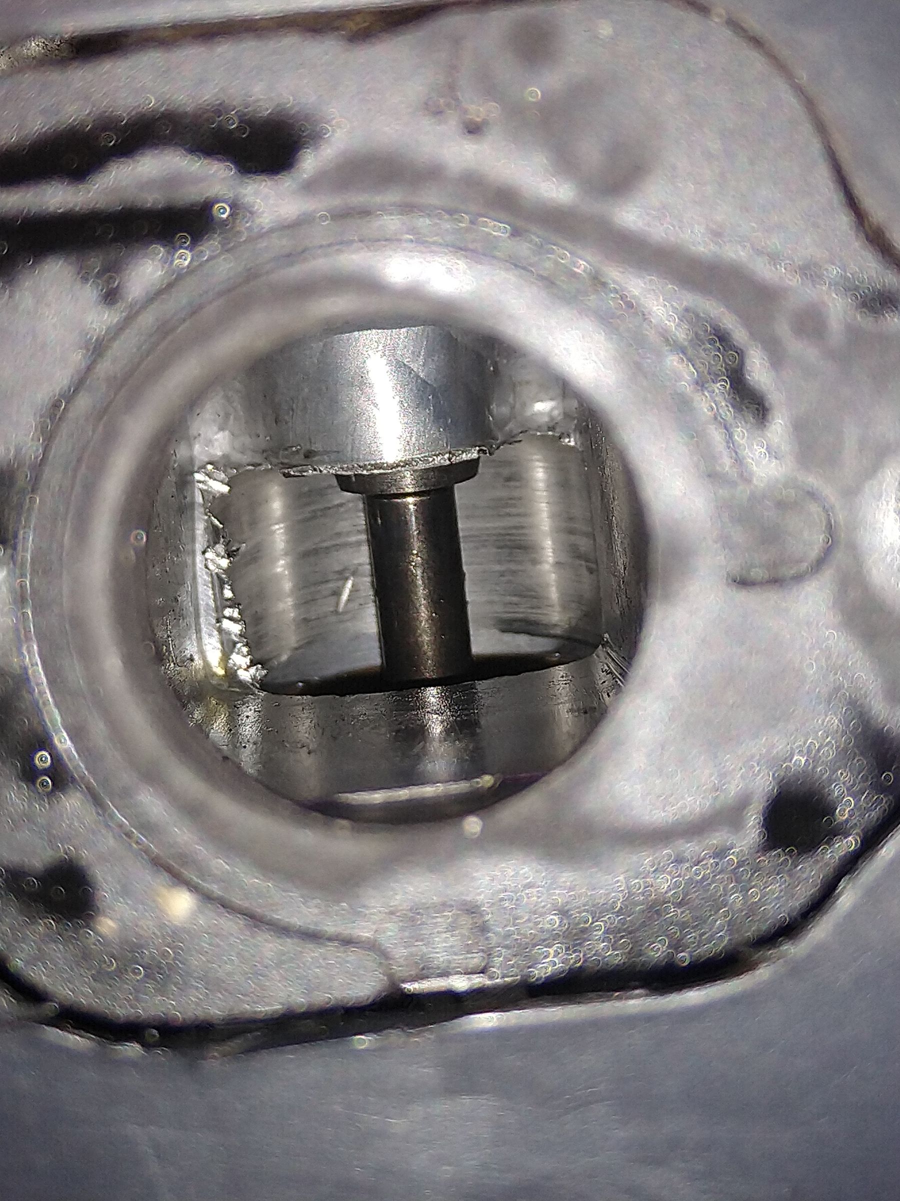

  5. Generator not starting and taken off carb but this doesn't look good..

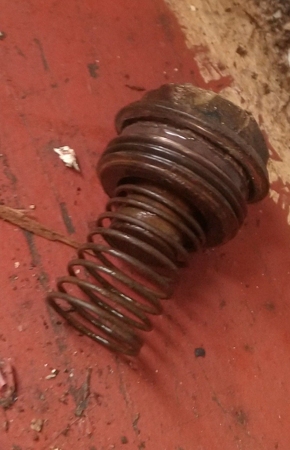

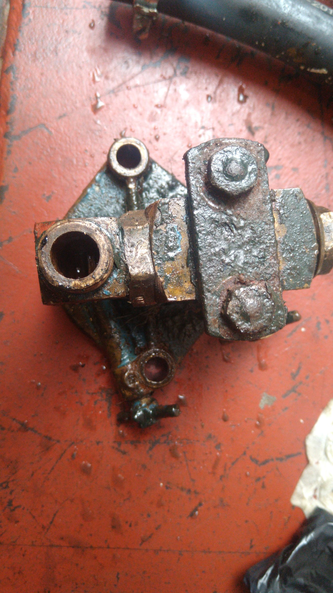

  7. Problem sorted. The problem was definitely a clogged pump. I replaced it with my spare pump as I couldn't get last bolt off to clean inside. Need to put it in a vice. Just glad it's s simple fix.

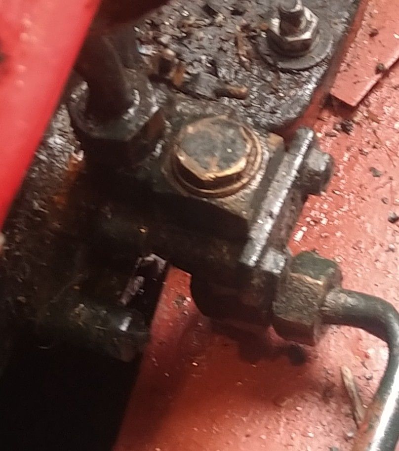

  11. My Sabb GG engine is s overheating after running for 5 minutes. I've taken the water pump apart and cleaned it and the water line is clear but seems low pressure. Doesn't seem to be providing enough pressure to go into engine. No water is pumping out of exhaust which It should do. Any suggestions?

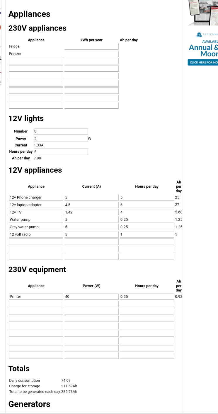

  17. No I haven't bought anything yet. Still trying to work it all out. This is my daily power required. Going to be continuous cruiser. No fridge and the oven I just ordered will require no power at all ( Statesman Legacy 50- X2 battery AA battery ignition). I've got x3 110ah batteries. Got a budget of around £350 for generator and £200 for charger.

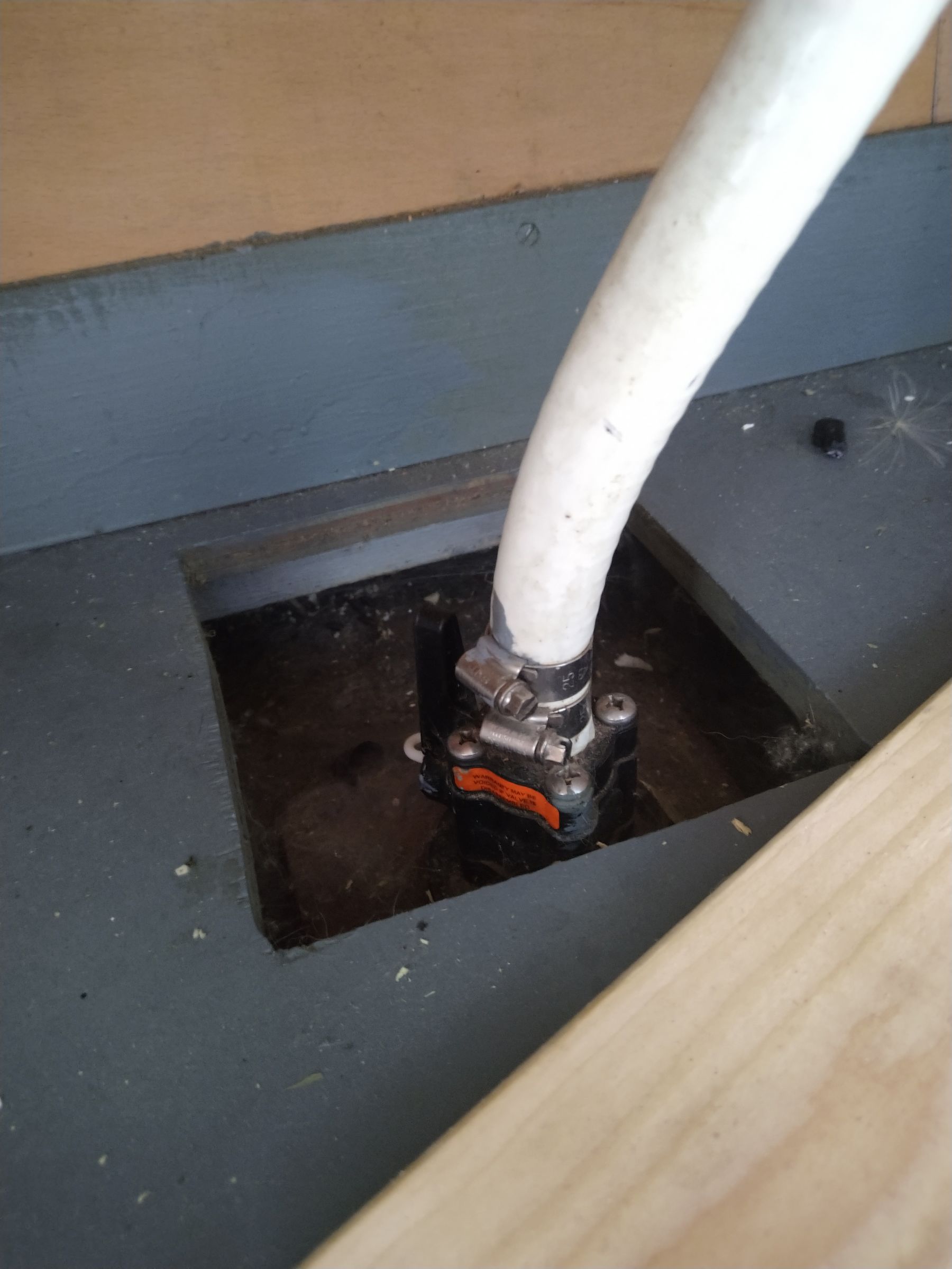

    I'm looking to change my narrowboat sink and drill a new grey water hole on the side. Anyone ever seen this before? What is the best best way of closing it off?

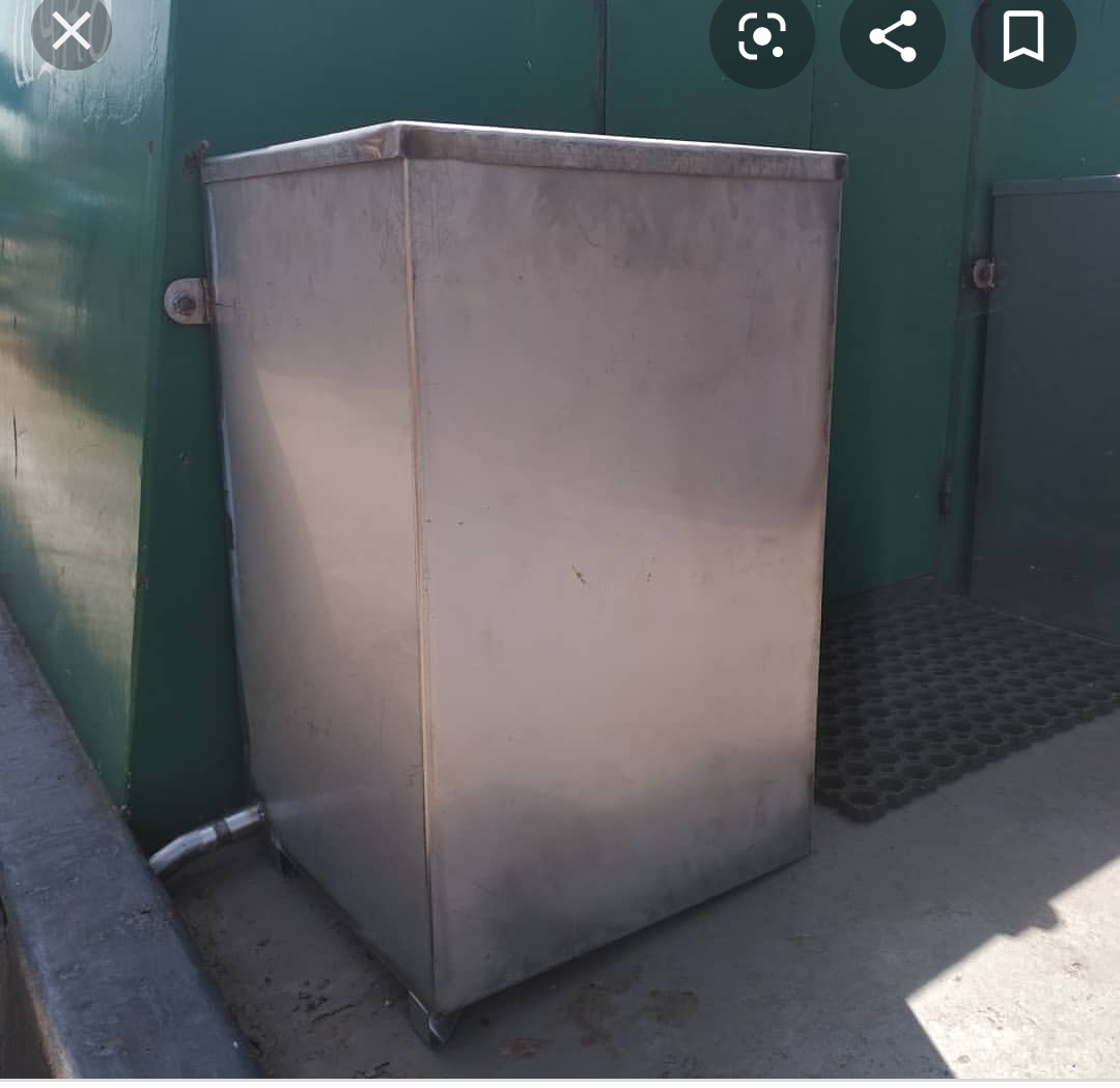

  23. So my gas locker has been made and the engineer came around yesterday with the box to find out where to place the vent pipe that goes off the boat. Unfortunately as it's a small boat there was no place for mounting brackets. So he said he will drill two holes through the box and boat. Fit two bolts with rubber washers to secure the box and make sure no gas can enter the interior of the vessel. Is that compliant with the above?
  24. The picture is just an example of the engineers work. Mine will be similar to the picture hopefully. The engineer said to me that he fully aware of BSS requirements. The box will be bolted to the boat. It's much cheaper to get a box made and bolt it to the boat instead of a box welded to the boat. I won't have a spare bottle. Only one as I'm using it for the cooker. Cold water only on my boat unfortunately. Thanks for all of your questions and I will make sure to ask the engineer all of your questions. Most likely a strap around the bottle but another question I need to raise with the engineer. Many thanks.
