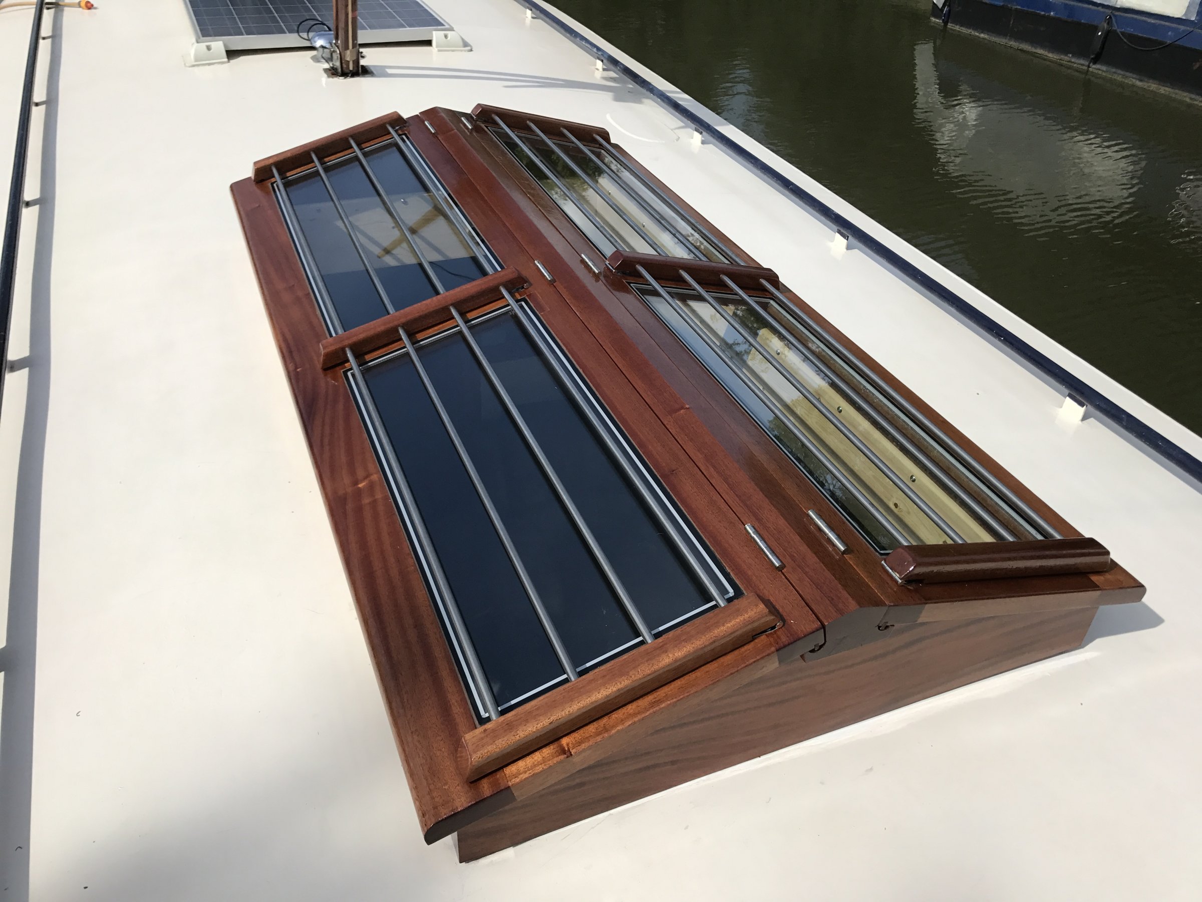

Nope, but I have used LeTonkenois and that gives an excellent finish. Here it is on some mahogany (well, utile actually)

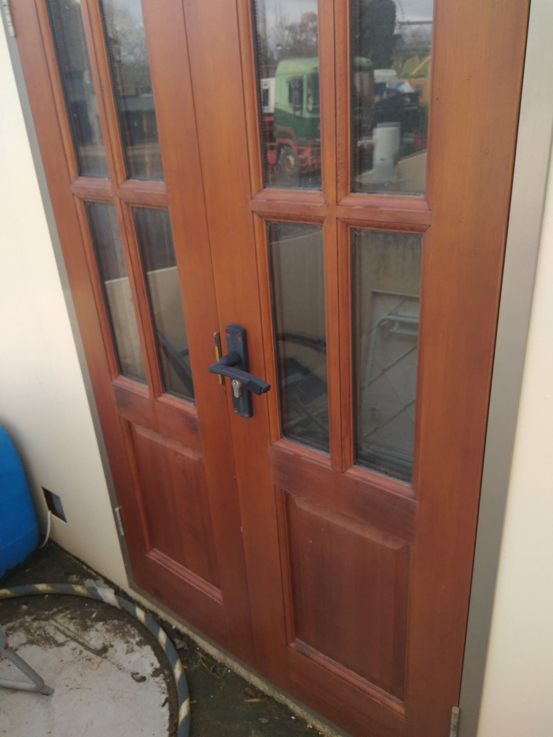

Good grief, we have the same Kedian doors and just put three coats of Ronseal exterior varnish on. Starting to wonder what kind of schoolboy error we've made!
Hmm! isn't that water based? It may be OK, but it would be interesting to learn how long that lasts. As already indicated, I would only use a spirit based varnish for exterior use, my preference is for Blackfriars Super Yacht Varnish or Exterior Varnish which is a little easier to find than LeTonkenois.

 Personally that is a beautiful (Houdini) roof light!
Surely this is bespoke. Did you make this ?
Thanks :)
Yes, I made it for one of the members here who was in a bit of a bind. It’s pretty big - 1800x940 - with stainless and chrome fittings to suit the rest of his widebeam. It’s known as a ‘dog box’ but I’m not sure why.
1 hour ago, WotEver said:
Thanks :)
