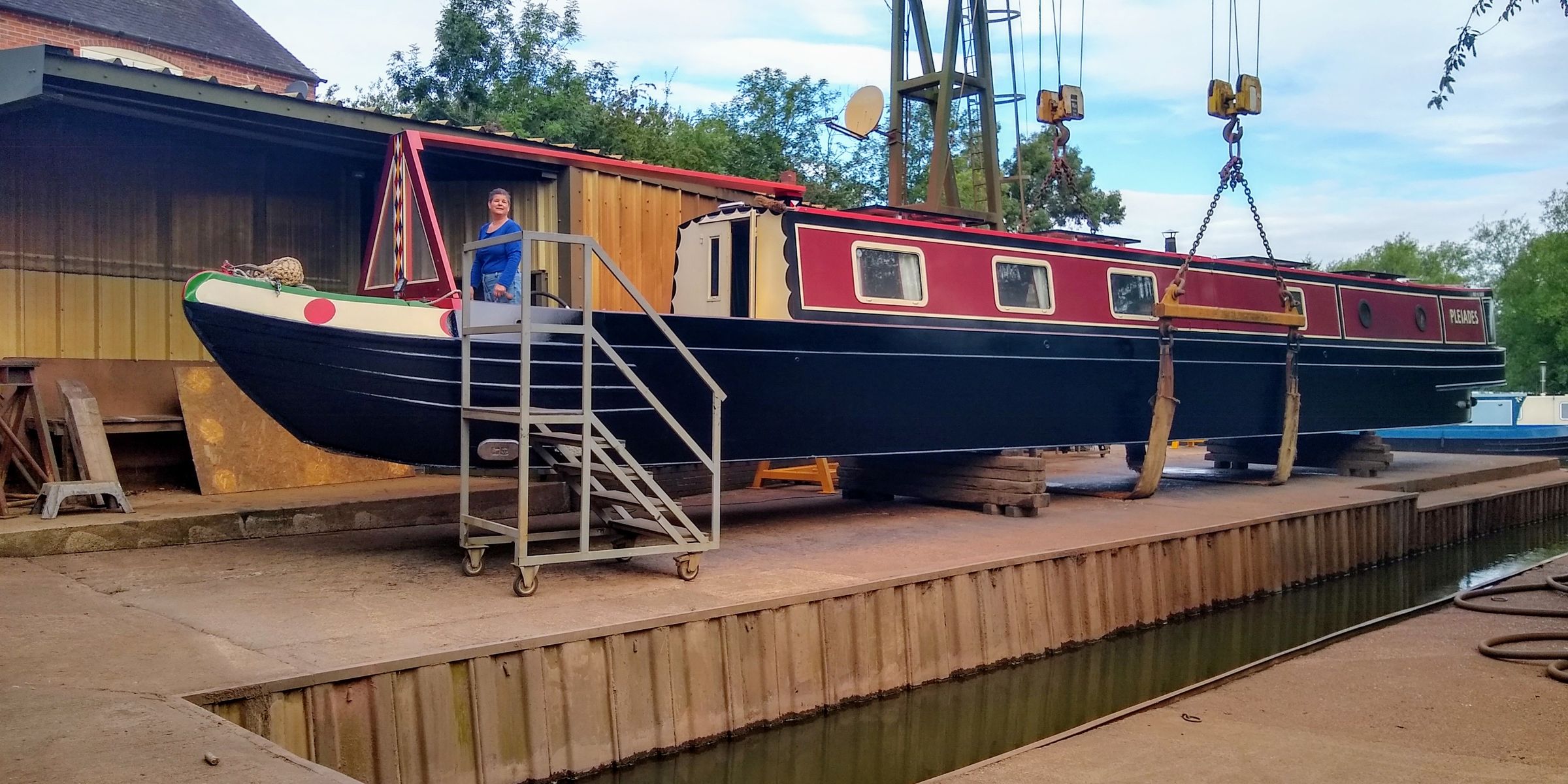

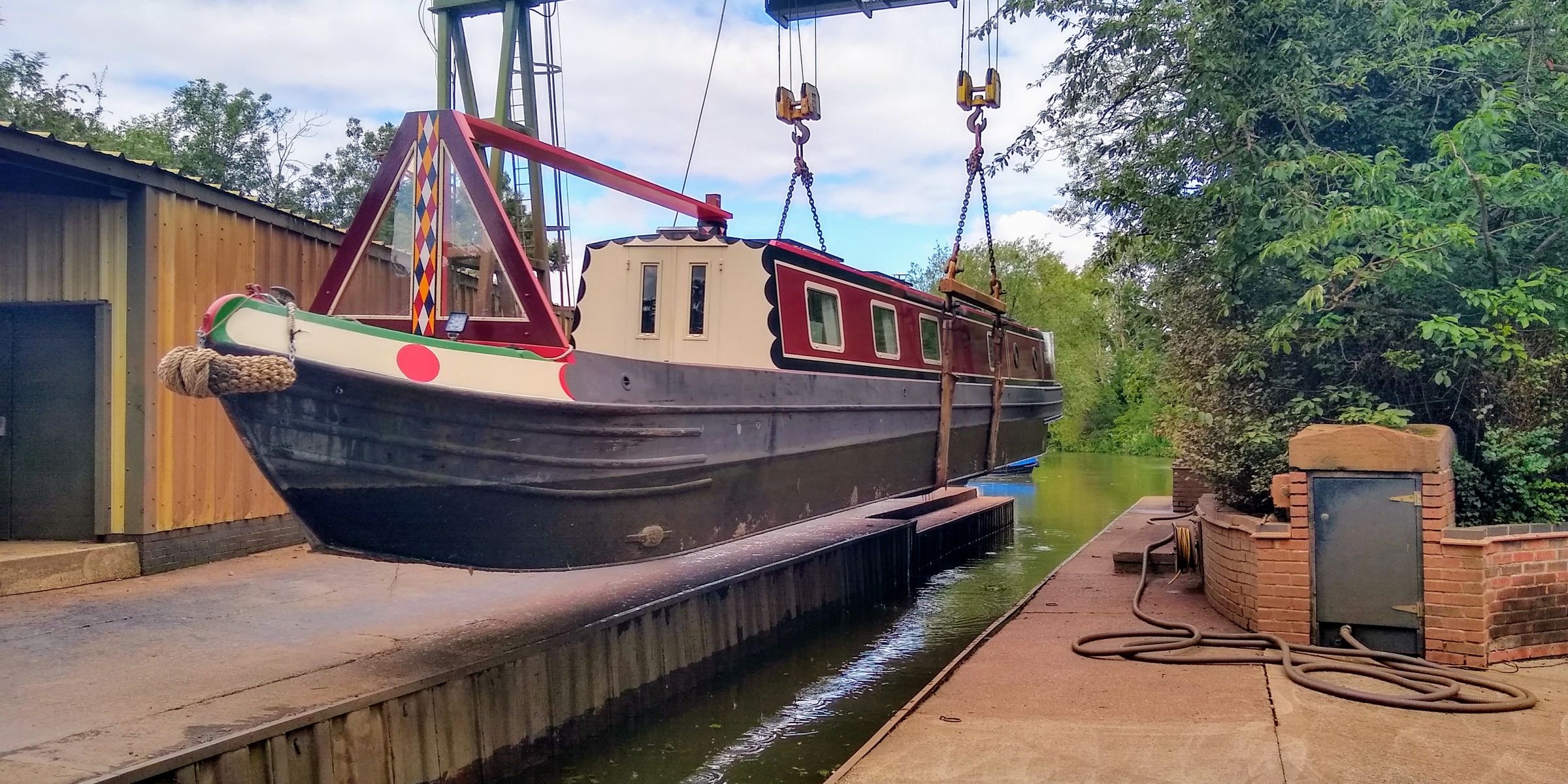

  2. A somewhat different view of ours. Before And after a busy weekend.

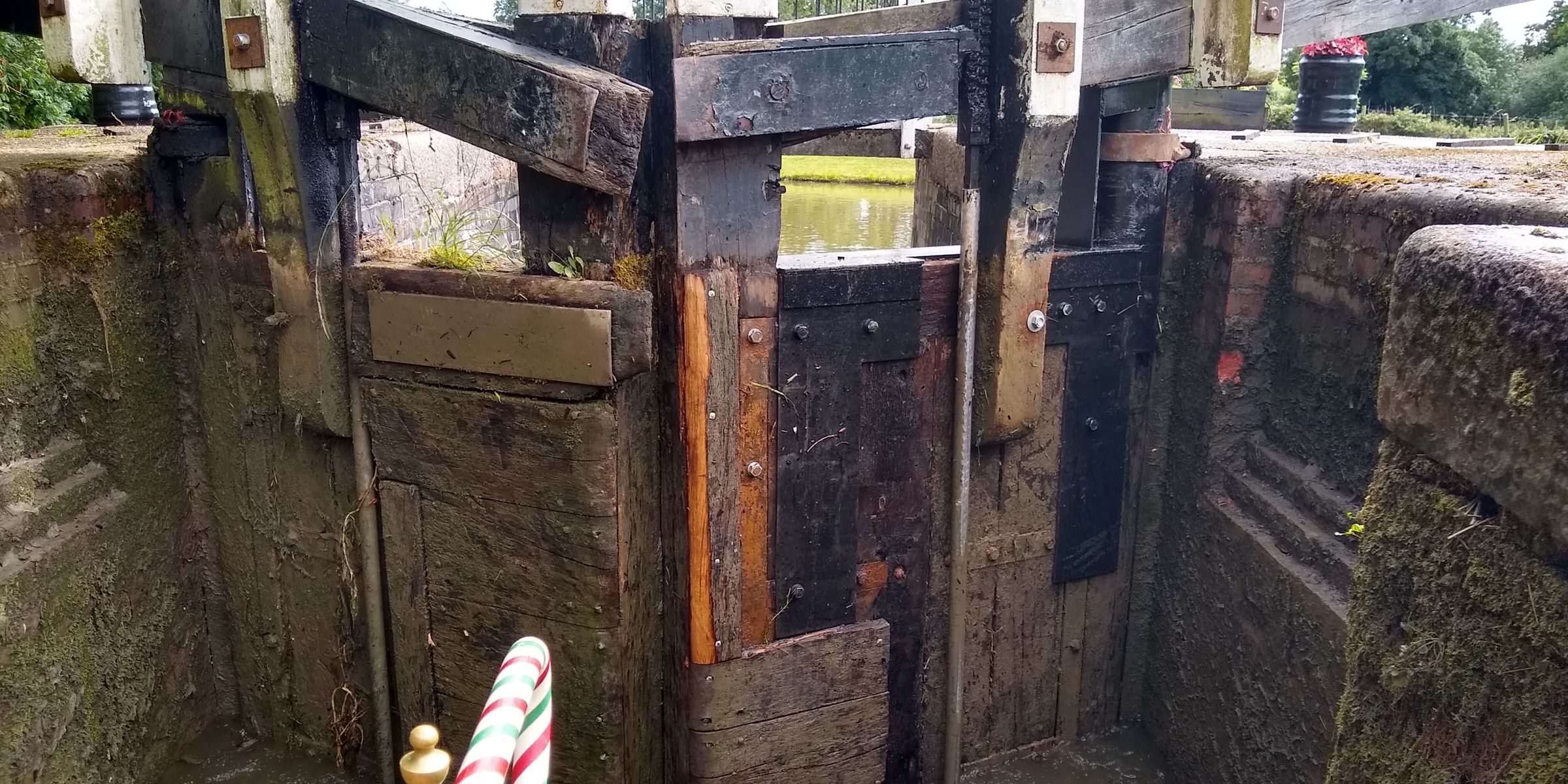

  7. The flight actually re-opened at about 4 o'clock yesterday (Wednesday) about an hour after we arrived. The workboat with Hiab mounted crane was pulled back out of the locks, and the volunteers, who had spent the day greasing paddled and generally preparing, decided to stay on until 6pm. to get four boats up, maybe six down, prioritising those on a schedule like us, advising those planning to go through Leicester to wait or find another route. Despite being initially a but concerned that as we were hauling a butty it might take too long, the whole team were helpful, efficient and considerate. Seems thet're not insured for bow hauling so can't help with that, but everything else can't fault them. They are back at 8am today Thursday (not 10) to finish clearing the waiting boats. The patched up gate.

  13. 15/06/2020 15:44 Following the failure of the off-side gate, lock 3, on the Watford Flight on Friday we have now made the gate safe. A Trust engineer has inspected the damage and ordered replacement parts. A plan to safely lift the gate is being put together and we hope to be able to issue more positive news in the coming days.
