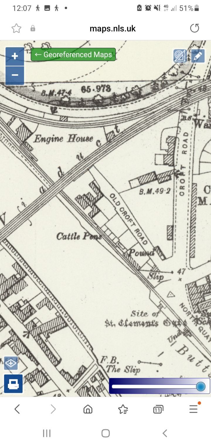

Very interesting having lived in Worcester for years I was under the belief that there was a line that ran down to the racecourse, and dropped passengers off there. Didn’t appreciate it was for more than that It’s a long time since I’ve been there but I have a thought that the arches on the other side to Francis picture has a visible old drop in arch height to accommodate that. Fishing around this site describes the situation where it seems the line at one time was intended to go right up to Diglis , and was built up to the cathedral. . http://www.miac.org.uk/butts.html So presumably the bridge across the quay in the image Heartlands posted was part of the original intension as it doesn’t make great sense otherwise, there’s not much land to the left beyond the bridge that can’t be accessed in a different way with no need for a bridge. The line could (I think) have curved inland rather than cross a bridge. Thanks for the old image of the chimney bridge too- you can clearly see the Saltires described in the listing blurb. Pity they weren’t replicated.
