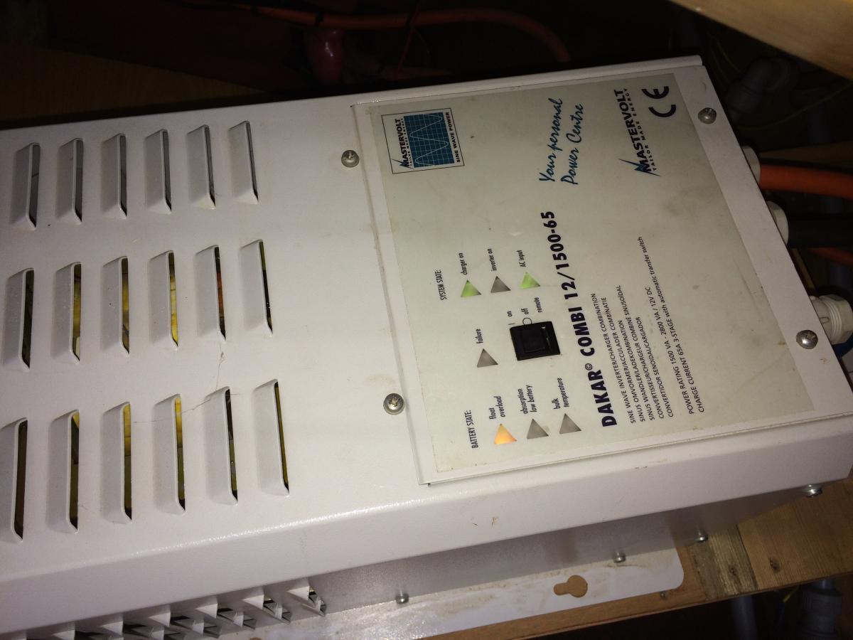

So it is a Dakar Combi from Mastervolt. I checked the lamps on it today, and it seems that it automatically switches between charging and inverting depending on whether the shore power is connected.
So based on the advice received:
A ) if I don't fit the heater, then I should leave it switched to charge the batteries.
B ) if I do fit the heater, then it would be better to switch it to remote, so that I don't drain the batteries if (when) the shore power fails.

The inverter needs to be disabled when leaving the boat as you intend. Both charger and inverter modes are On by default although obviously the inverter won't be running with shore power present.
I only have access to the manual for the Power Centre Control remote panel but disabling is acheived on that by selecting Inverter Mode under the Advanced Menu and turning it Off. Make sure Charger Mode under same menu is left On though (which it should be by default).You will probably have similar controls on the main unit if you don't have the panel I refer to - check your manual.
Once the inverter is disabled in this manner you will have no worries about the inverter unintentionally cutting in if shore power is lost, and your heater can be left on. You will need to turn Inverter Mode back On when returning to the boat though if you want to use it whilst cruising.
ETA: As bottle points out the selection switch on main unit has a Remote position. In this position the remote panel controls the unit. Can I assume you have this remote panel referred to above?

Reading the manual available here Link,
It appears you have no choice it is either ON or OFF the 'remote' setting is only if you have a remote control centre.
The remote control is needed to adjust some settings, ie to limit load on the shoreline.
Note: this manual does not actually mention your particular model, I suspect it may be discontinued.
No I don't have the remote. I am sure you are right about the model being discontinued. I think it was fitted in 2002.

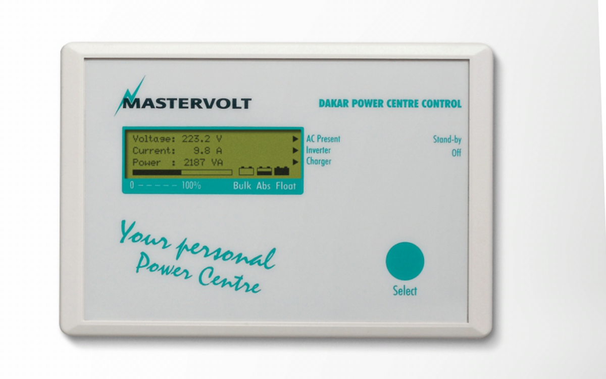

Its a shame that you don't have the remote control panel, which is particularly surprising because the manual, downloadable here indicates that its included with the main unit as supplied new.
Can confirm this is a discontinued unit and that apparently the remote panel is the only way of controlling the inverter mode on/off function.
Seems the only solution to leaving the boat unattended is to switch the Combi off completely and arrange for heater to be fed directly from shore supply and not via the Combi. A second small multi-stage battery charger could also be fed from same direct supply to ensure batteries are left on float.
Of course if you could obtain/find the remote panel as shown below then all your problems would be solved since it just plugs into the main unit.
